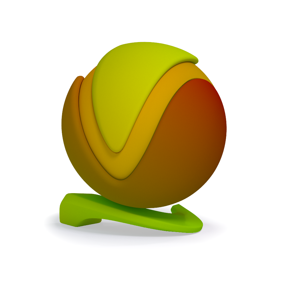

Point – The x,y and z coordinates (in world space) of the point are converted to RGB data.
