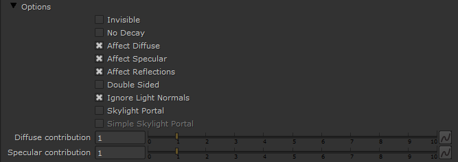

Options
Invisible – Controls whether the shape of the VRayLightMesh source is visible in the render result. When disabled, the source is rendered in the current light color. Otherwise it is not visible in the scene. Note that this option only affects the visibility of the light when seen directly by the camera or through refractions. The visibility of the light with respect to reflections is controlled by the Affect Specular and Affect Reflections options.
No decay – Normally the light intensity is inversely proportional to the square of the distance from the light (surfaces that are farther from the light are darker than surfaces which are closer to the light). When this option is enabled, the intensity will not decay with distance. See the Real-World Lights have inverse Square Falloff example for more information.
Affect Diffuse – Determines whether the light is affecting the diffuse properties of the materials.
Affect Specular – Determines whether the light is affecting the specular of the materials. This means glossy reflections.
Affect Reflections – Determines whether the light will appear in reflections of materials. This means both perfect and glossy reflections.
Double Sided – This option controls whether light is beamed from both sides of each face. See the Single-Sided vs. Double-Sided Lights example for more information.
Ignore Light Normals – Normally, the surface of the source emits light equally in all directions. When this option is disabled, more light is emitted in the direction of the source surface normal.
Skylight Portal – When enabled, the Color and Intensity parameters are ignored; instead the light will take its intensity from the environment behind it.
Simple Skylight Portal – This option is only enabled if the Skylight Portal option is on. It tells the VRayLightMesh that there is nothing of interest behind the light itself, and so the environment color can be used directly. Normally, the portal light takes its color from whatever objects are behind it. In order to do this, the light traces additional rays, which may slow down the rendering. Turning this option on makes the rendering of portal lights faster.
Diffuse contribution – A multiplier for the effect of the light on the diffuse.
Specular contribution – A multiplier for the effect of the light on the specular.

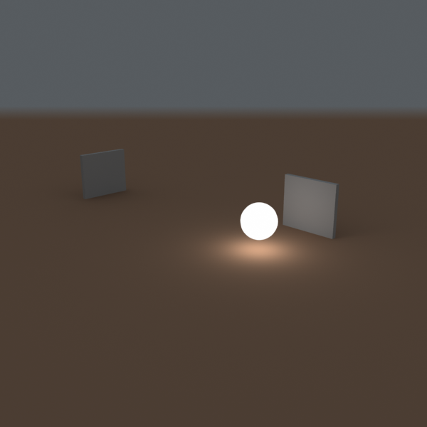

Example: Real-World Lights have inverse Square Falloff
The following images demonstrate the No decay parameter. In the real world the light sources attenuate with the inverse square of the distance from the light to the shaded surface. The settings for the light source the same for both images with the exception of the Decay parameter:
No decay is off (default).

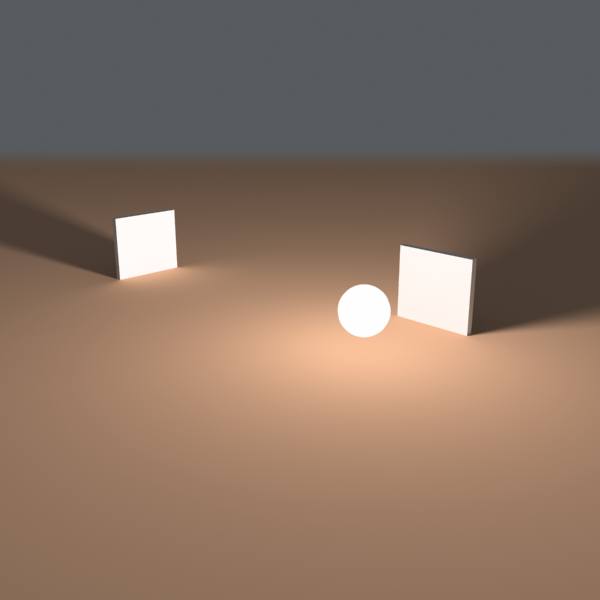

No decay is on.

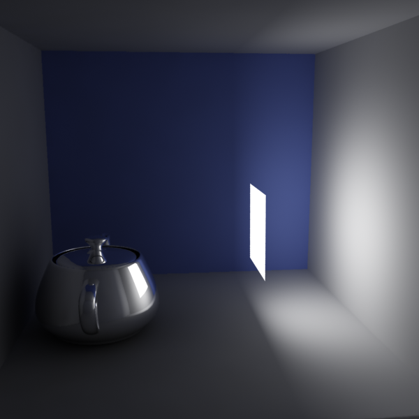

Example: Single-Sided vs. Double-Sided Lights
This example demonstrates the difference between a single-sided and a double-sided planar area light.
Double Sided is off.

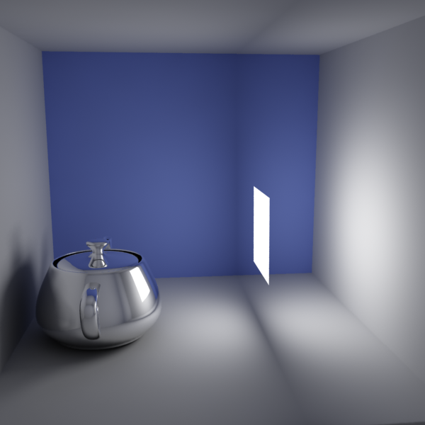

Double Sided is on.
