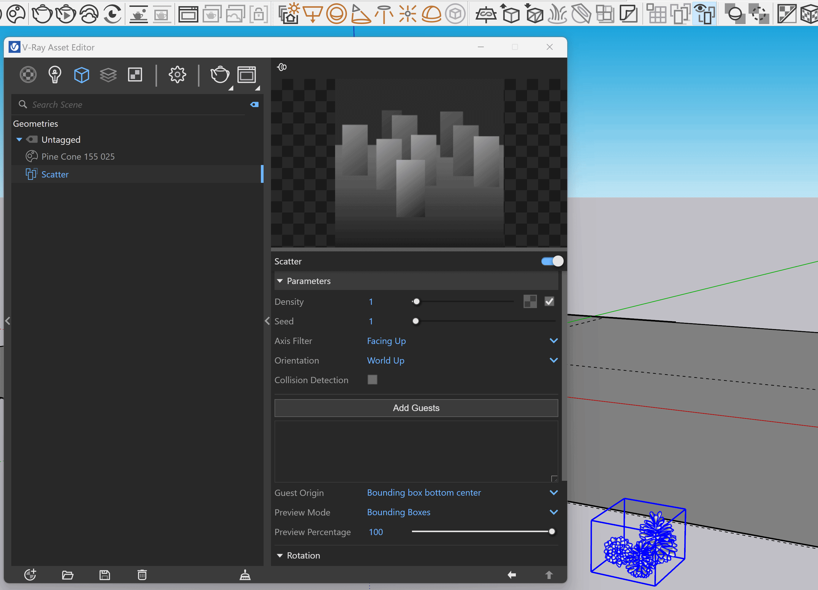

Scatter Viewer In Previous SketchUp Versions
Here is what the Scatter Viewer used to look like in SketchUp 2022 an earlier versions. See the Scatter Viewport Preview Workflow for versions 2023 and later.
UI Paths
||V-Ray Objects Toolbar|| > Scatter Viewer
SketchUp Menus Ribbon
||Extensions|| > V-Ray > Objects > Scatter Viewer
Workflow
For SketchUp versions earlier than 2023, the Scatter Viewer is accessed through the V-Ray Toolbar and V-Ray Menu.
Introduce a Scatter Guest from the Asset Editor or by dragging and dropping a preselected object from the viewport onto the Scatter Host object. In this case, the Guest object can be removed by using the drag + shift function. Scatter Viewer must be active in order to add a Guest by dragging a preselected object from the viewport onto the Host object.
Example of introducing Guest objects to the Host object
