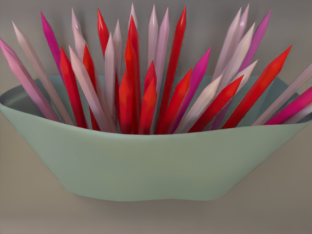

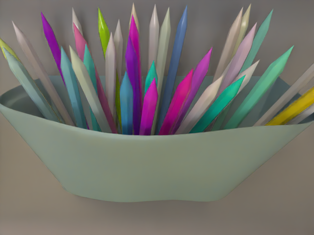

Example: Random Hue/Sat/Gamma
The following example shows how the Random Hue/Saturation/Gamma changes the scene. Each example uses the maximum value of 1.
No Random Hue/Sat/Gamma applied
Hue = 1
Saturation = 1
Gamma = 1
Hue/Sat/Gamma= 1
