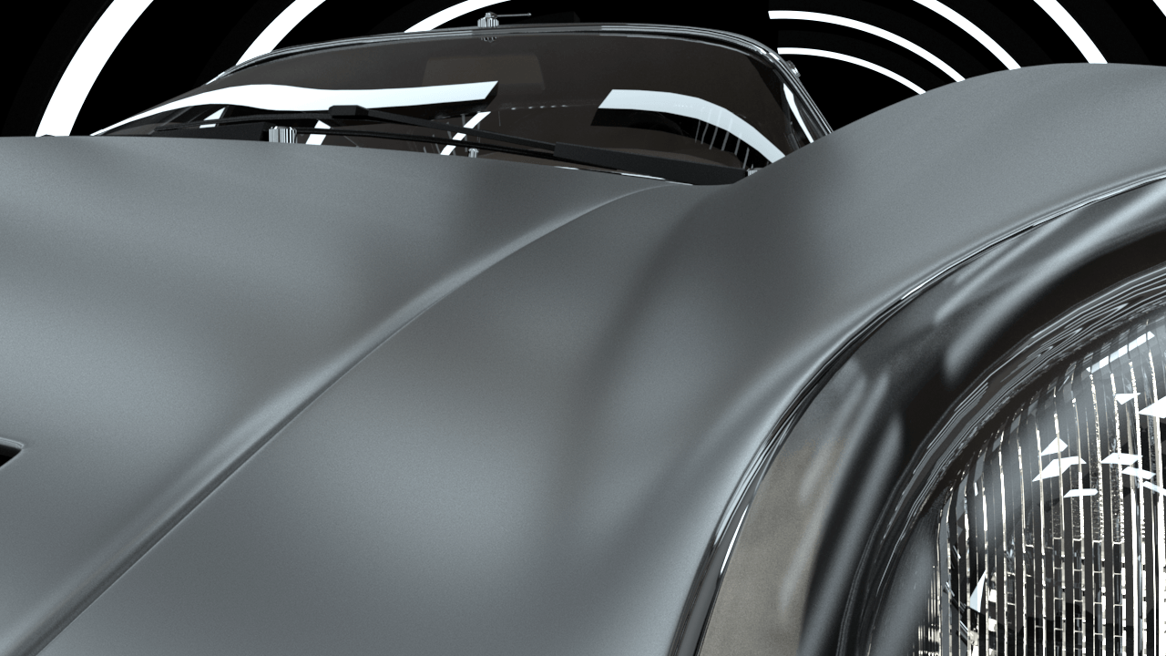

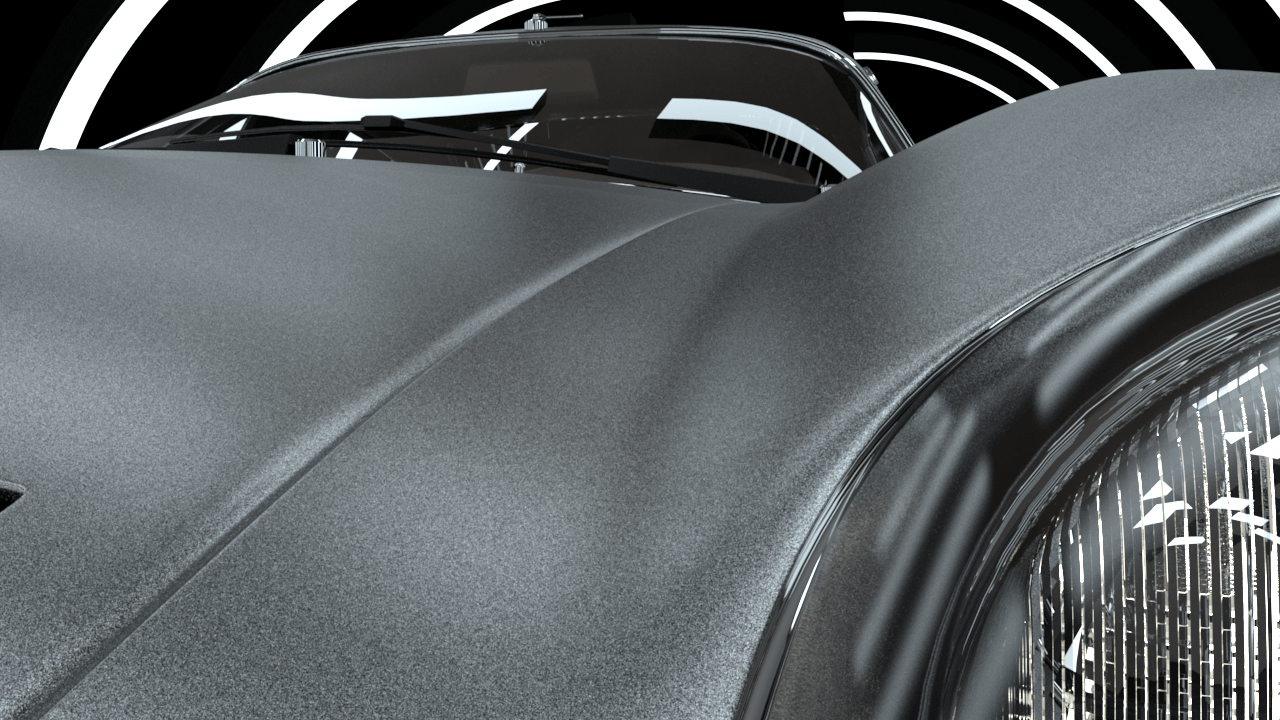

Example: Enable Flakes
The Enable Flakes parameter allows the user to turn the Stochastic Flakes effect on and off. When on, flakes will be scattered across the surface of the material. When off, the material will render with only the specified Brdf Type and Hilight Glossiness. In the example below, the BRDF type is set to GGX. Click on the image to open the full-res.
off
on

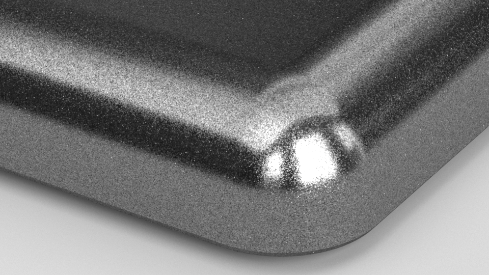

Example: Highlight Glossiness
Hilight Glossiness = 0.6
Hilight Glossiness = 0.8
Hilight Glossiness = 0.95
0.6
0.95

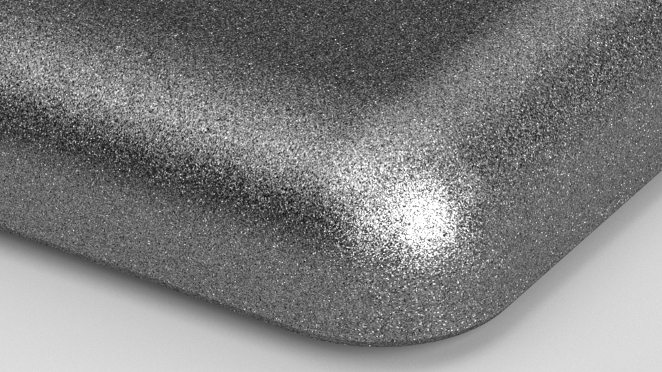

Example: Blur Angle
 Blur Angle = 1.0
Blur Angle = 3.0
Blur Angle = 6.0
1.0
6.0

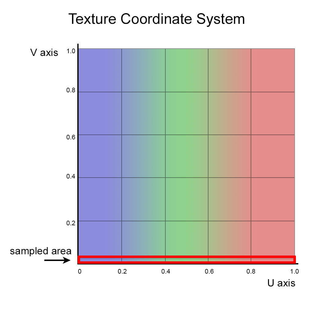

Random Color Map – Available when Colored Flakes is set to Random from Map. Specifies a texture from which random colors are sampled and applied to the flake color.
Only the bottom-most horizontal row of pixels from the texture are sampled; all other parts are ignored. See the Random Color Map example below for more information.
White Average – When enabled, renders colored flakes without the darkening effect. Note that this is not physically correct.
Tex Subdivs –
Example: Random Color Map
The Random Color Map parameter allows the user to provide a texture map for randomizing the stochastic flake colors. It is only accessible when Colored Flakes is set to Random from Map. Random colors are generated by sampling the horizontal row of pixels at the very bottom of the map along the U-axis. The sample area is only 1 pixel tall; the rest of the map is ignored.

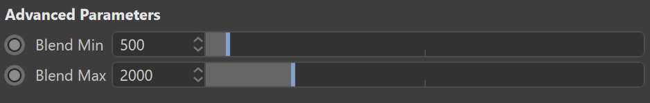

Blend Min – Specifies the number of flakes per pixel below which the flakes are computed. When the number of flakes per pixel is above this value, the material gradually transitions into a smooth (non-discrete) BRDF.
Blend Max – Specifies the number of flakes per pixel above which the material will only compute the smooth (non-discrete) BRDF. If the number of flakes per pixel is below this value, the material gradually transitions into discrete flakes.
