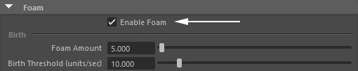

Select Resimulation → Affect → Particles and enable the respective particle system below (i.e. Splash and Mist, Foam or Wetting).
Make sure the particle system's simulation is Enabled, e.g. for Foam open the Foam rollout → select the Enable Foam option.
Hit Start to run the simulation again - the particle system will be added to the cache sequence.

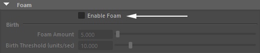

Make sure the particle system's simulation is Disabled, e.g. for Foam open the Foam rollout → deselect the Enable Foam option.
Hit Start to run the simulation again - the particle system will be removed from the cache sequence.
