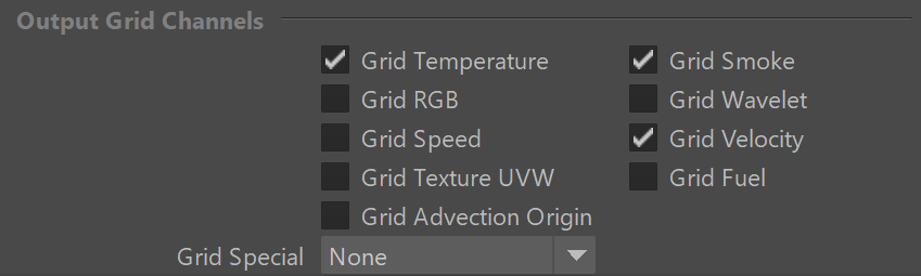

Output Grid Channels
Fluid properties are written inside Grid Channels. Here you can choose which Grid Channels will be exported to the cache files when running a simulation.
Each channel stores a type of value, such as Temperature/Liquid, Smoke, RGB, Velocity and so forth, with its own range of possible values that is most efficient for that specific channel type (see the Grid Channel Ranges). Phoenix determines the fluid’s behavior at a given time, based on the content of these Grid Channels.
Note that the more channels are used, the slower the simulation runs and the larger the output files are. While scrolling the timeline, you can check which channels are present in the loaded cache file for the current frame, from the Cache File Content section in the Simulation rollout.
Also note that in the case of FLIP / Liquid simulations, currently only Liquid particles can be automatically converted to a grid during export, while all the other systems (e.g. Foam, Splash, etc.) are exported only as particles.
Grid Temperature | outTemp – Exports the Temperature channel.
Grid Smoke outSmoke – Export the smoke density.
Grid RGB | outUVW – Export the RGB color. You can use this for simulations where you are mixing different liquid colors or materials through a Phoenix Grid Texture.
Grid Wavelet outWavelet – Export the wavelet data of a fire/smoke simulation. You need this if you are going to resimulate a fire/smoke simulation in order to increase the resolution and add more detail using wavelet turbulence.
Grid Speed | outSpeed – Export the speed of the simulation. You can use this for coloring the simulation at render time based on how fast different parts of the fluid move.
Grid Velocity | outVel – Export the velocity of the simulation. The difference between the Speed and Velocity channels is that Velocity is a vector and takes 3 times more space in the cache file than the Speed channel. However, Velocity has direction and is needed for Resimulation and motion blur of the fire/smoke simulation or the liquid mesh. Because Speed can be calculated from the Velocity, it is not exported separately when Velocity is exported.
Grid Texture UVW  | outTexUVW – Export the Texture UVW channel. Enable this to generate texture mapping coordinates that follow the movement of the fluid. This way you can change the textures you want mapped over your fluid even after the simulation has ended, without the need to simulate again. For more information on TexUVW, please check the Texture mapping, moving textures with fire/smoke/liquid, and TexUVW page.
Grid Fuel outFuel – Export the fuel density in the simulation.
Grid Advection Origin outAdvPos – Export the advection origin of each voxel in the simulation. This is needed for the Precise Tracing Blend Method for retiming simulated sequences in the Input rollout, and is also needed for the Use Advection Origin for Motion Blur option in the Simulation rollout.
Grid Special | outSpecial – Export internal or special channels into the Special channel (alias to the Smoke channel) so they can be visualized using one of the volumetric shaders of the Simulator (with Mode set to VolumetricVolumetric Geometry, or Volumetric Heat Haze). Such channels can also be read by the Grid Texture and used for rendering.
Solid Voxels – Exports the solid voxels as smoke. Voxels covered by many obstacles contain more smoke.
Divergence Symm – Exports the negative divergence of each voxel.
Divergence Smooth  – Exports the blurred negative divergence of each voxel.
Vorticity – Exports the length of the curl of each voxel. Can be used for whitewater shading.
Vorticity Smooth  – Exports the blurred length of the curl of each voxel. Can be used for whitewater shading.
Velocity Gradient –  Exports the length of the gradient of the velocity field.
Injector  – Exports the pressure term created by sources in Inject mode or formed during the simulation.
Liquid Surface – Exports the surface created by the simulation.
Solid Geom Type – Exports the internal geometry type in each voxel.
Hydrostatic Pressure – Exports the pressure of the liquid at each voxel due to the effect of gravity.
Voxelization Issues – Exports voxels where the solver would produce wrong results during simulation. Such voxels are near overlapping triangles, inverted normals, open edges or other geometry issues.
