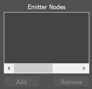

Emitter Nodes
Non-Phoenix particles, such as Particle Flow or tyFlow particles, can also act as emitters for a Phoenix Source. They can emit from a spherical 3D shape, or from instanced geometry.
Note that the Source icon itself does not emit fluid, so the position of the icon's viewport gizmo in the scene does not matter.
Instead, you must pick the geometry and/or particles that you want to use as emitters, in the Source’s Emitter Nodes list.
Emitter Nodes | sources – Specifies a list of objects that will emit fluid. Both geometry and particle systems can be selected here. Press the Add button and pick an object from the Viewport, or a list of objects using the Scene Explorer.

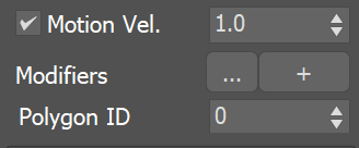

Motion Vel. | usevel, velmult – When enabled, moving emitters will affect the velocity of the fluid and make it follow the emitter. This effect is controlled with the specified multiplier. If the emitter is not moving, this option has no effect.
  • Particles with attached geometry (such as PFlow particles using a Shape Instance operator) will act like standard geometry obstacles and will push the fluid by default, as long as their Solid Phoenix property is enabled.
  • Particles without geometry (even PFlow particles with a plain Shape operator) will need to be attached to a Source in order to interact with the fluid in any way.
  • Particles without geometry can emit fluid using their shape and size using the Source's Particle Shape and Custom Prt Size options.
  • Particles without geometry will not affect the fluid's motion by default, so you need to enable Motion Vel. explicitly if you need this effect.
  • If Motion Vel. is enabled, the fluid emitted by a particle may refuse to leave the particle shape area and continue to move together with the particle, because it will have the same velocity.
Modifiers dmodvel – Discharge Modifiers can be attached here in order to affect the Motion Vel. parameter.
Polygon ID | poly_id – Only the polygons with the specified ID of the emitter geometry will emit the fluid.
