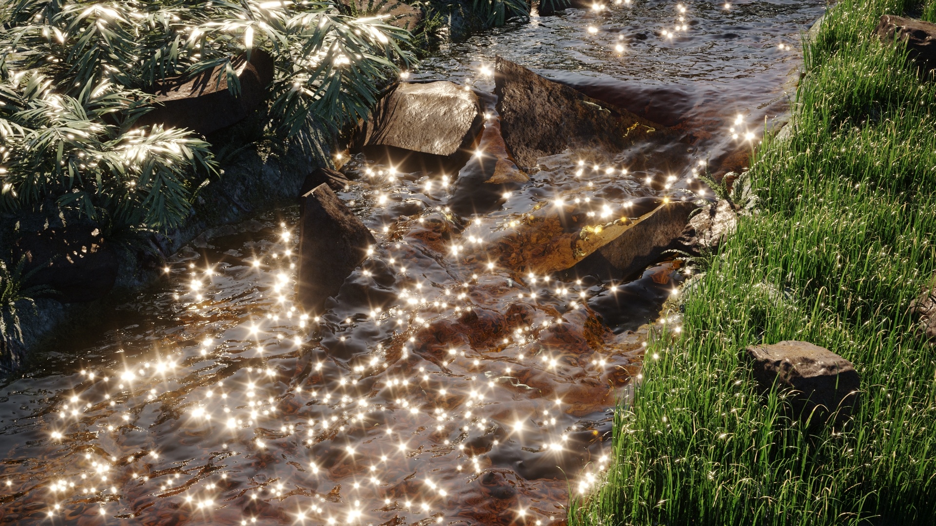

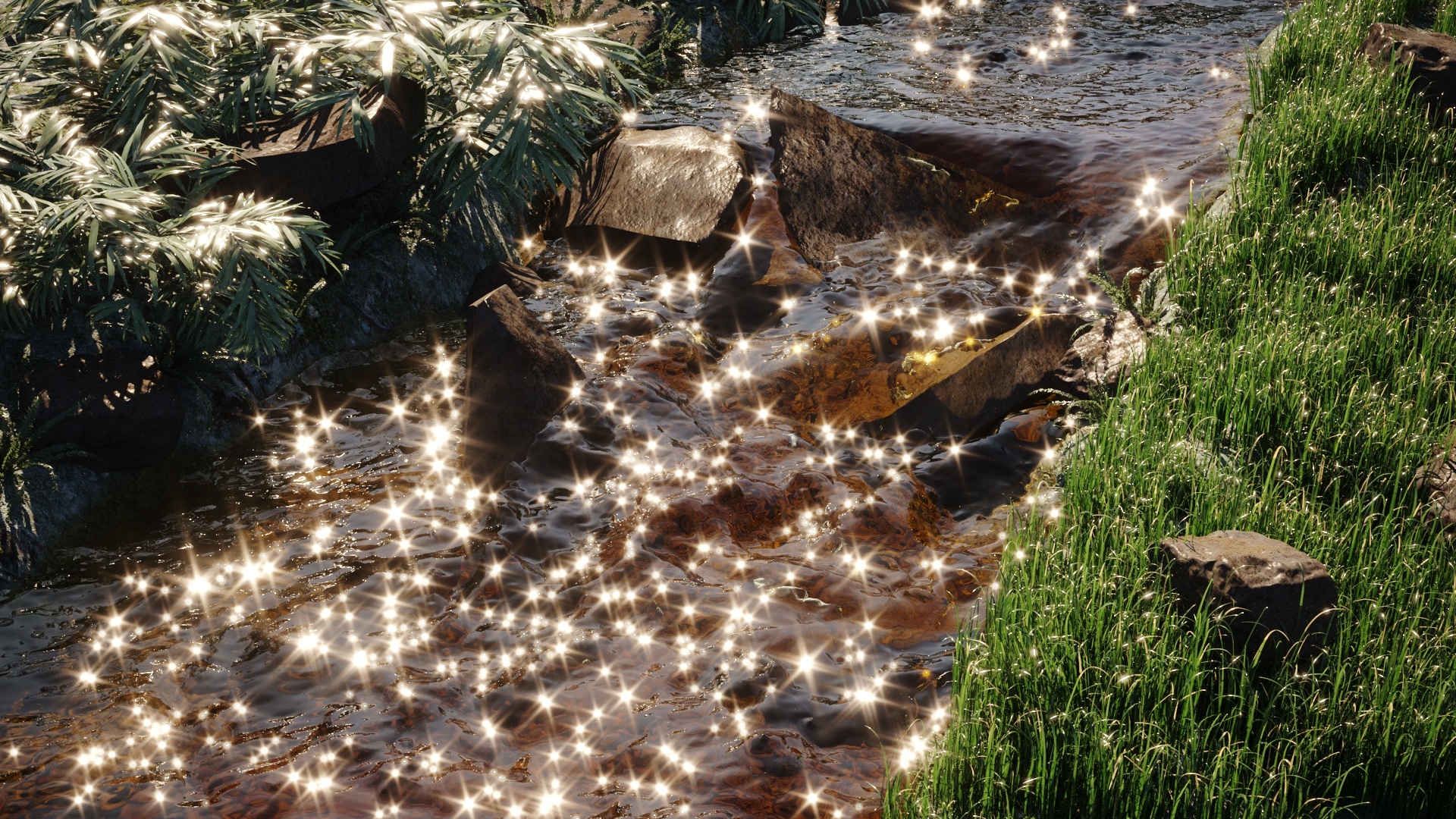

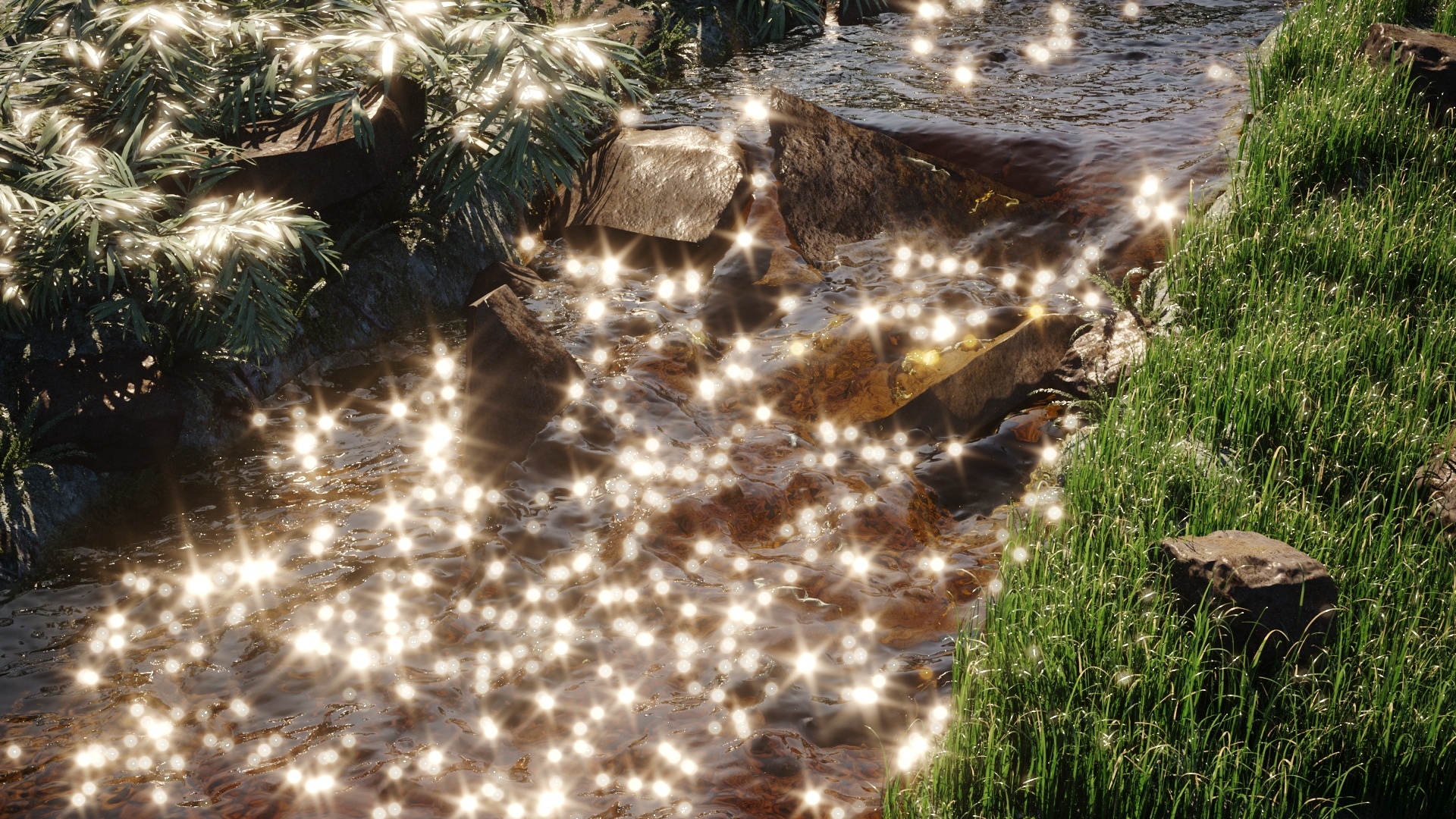

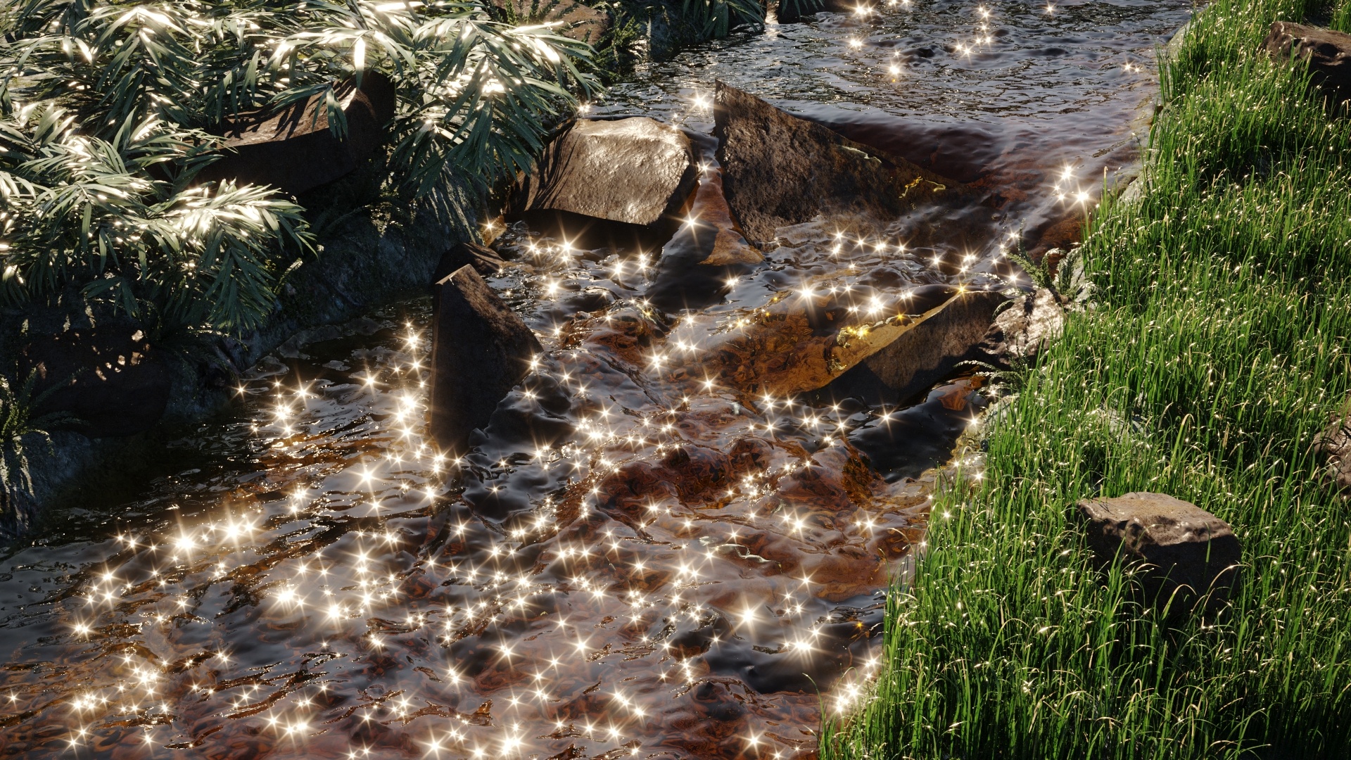

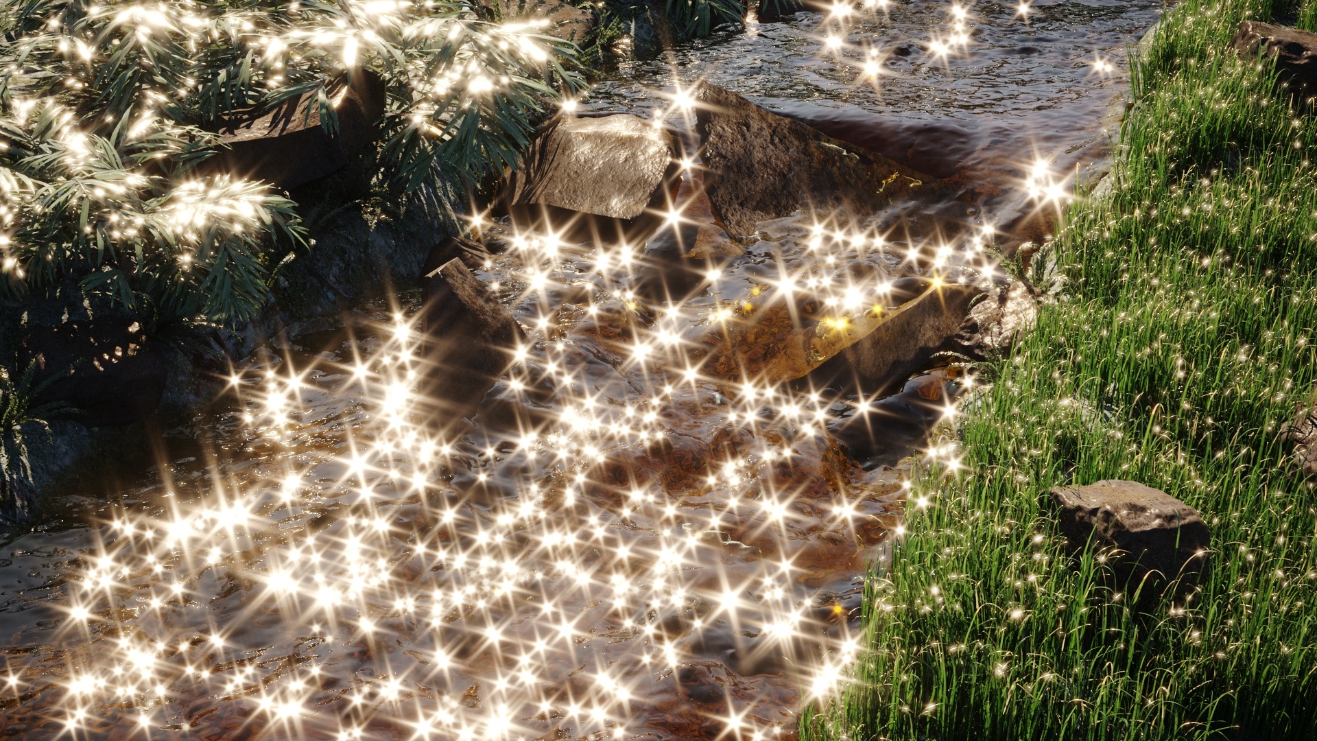

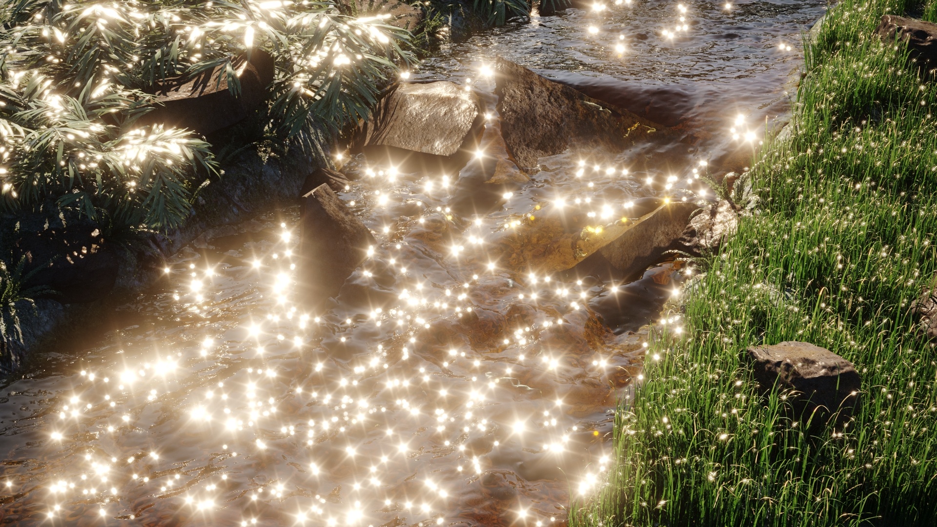

Bloom and Glare
Size Increases/decreases bloom and glare size.
Bloom intensity Increases/decreases bloom intensity.
Glare intensity Increases/decreases glare intensity.
Threshold Controls the minimum brightness which is considered for the Bloom and Glare effect. Increasing the threshold applies Bloom and Glare only to the brighter pixels. Reducing it allows the Bloom and Glare effect to be applied to pixels that are less bright.
Color intensity Controls how saturated the Bloom and Glare effect is. Higher values mean higher saturation.
Color shift  Changes the hue of the coloring added to the Bloom and Glare effect.
Streak count  Defines the number of streaks for the glare effect.
Rotation  Rotation of the glare effect in degrees.
Streak blur – Decides whether the glare streaks should be sharper or more blurry.
Custom aperture  Launches an editor which can be used to fine-tune advanced Bloom and Glare options.

Bloom and Glare - Size 10
Bloom and Glare - Size 30 (default value)
Bloom and Glare - Size 60
Bloom intensity 0.5
Bloom intensity 1
Bloom intensity 5
Glare intensity 0.5
Glare intensity - 1 (default value)
Glare intensity - 5
