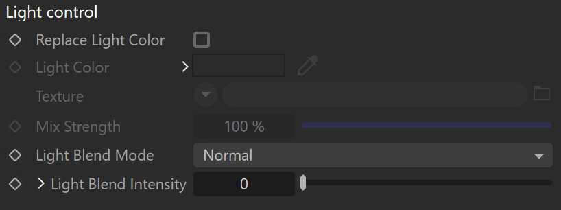

Light Control
Replace Light Color – When enabled, the color for all lights illuminating an object with the current material is replaced by Light Color.
Light Color – Replacement color for the original light color. A Texture can also be attached and blended with the color, using the Mix Strength option.
Light Blend Mode –Mode for blending the original light with the diffuse color.
None
Normal
Over
Add
Subtract
Multiply
Lighten
Darken
Saturate
Desaturate
Illuminate
Light Blend Intensity –Amount for blending the original light and the diffuse color. A value of 0 results in no light blending, while a value of 1 results in full light blending. A Texture can also be attached and blended with the value, using the Mix Strength option.

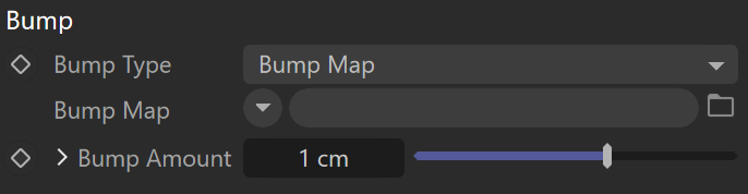

Bump
Bump Type – Determines how the Bump Map parameter is interpreted.
Bump map – Applies the map as a bump map.
Normal map in tangent space – Applies the map as a normal map in tangent space.
Normal map in object space – Applies the map as a normal map in object space.
Normal map in screen space – Applies the map as a normal map in screen/camera space.
Normal map in world space – Applies the map as a normal map in world space.
From texture bump output – The map is applied as determined by map type itself.
Explicit normal – Applies the map as an explicit normal.
Bump Map – Allows the selection of a texture for the bump or normal map. Leaving this unconnected turns off bump/normal mapping.
Bump Amount – A multiplier for the bump effect. A Texture can be attached and blended with the value, using the Mix Strength option. Choose the way they are blended with the Mix Type option.
