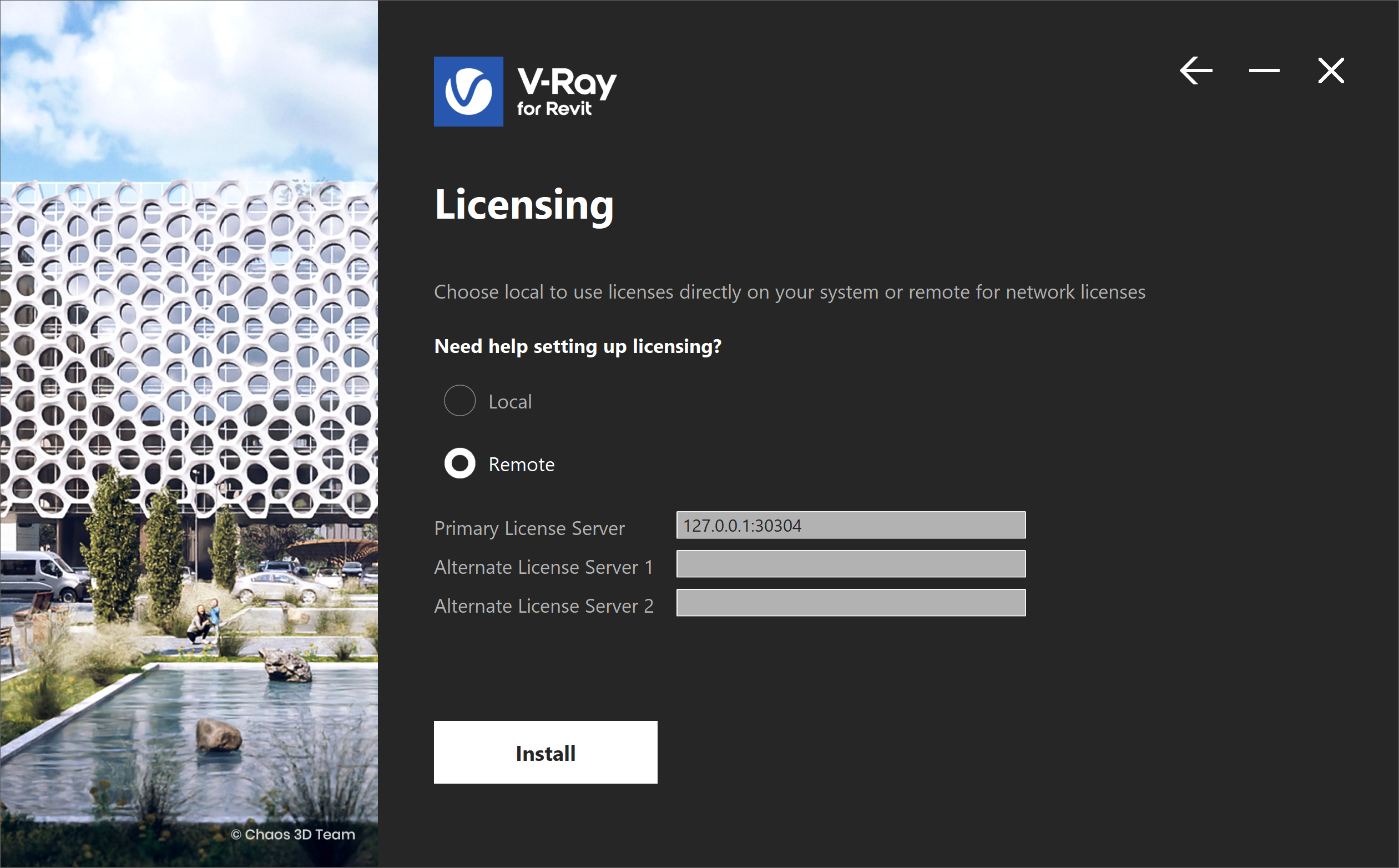

Here is how to connect to an already set-up Premium shared license:
  • The administrator needs to give you their machine's IP address. This serves as your connection point to the Chaos License.
  • When installing your Chaos product, at the Licensing step, select Remote. In the Primary License Server field, type the server IP address that your license administrator gave you. At the end, add the :30304 port.
  • Continue to finish the installation. You are connected to the active licenses after that.
Example screenshot
