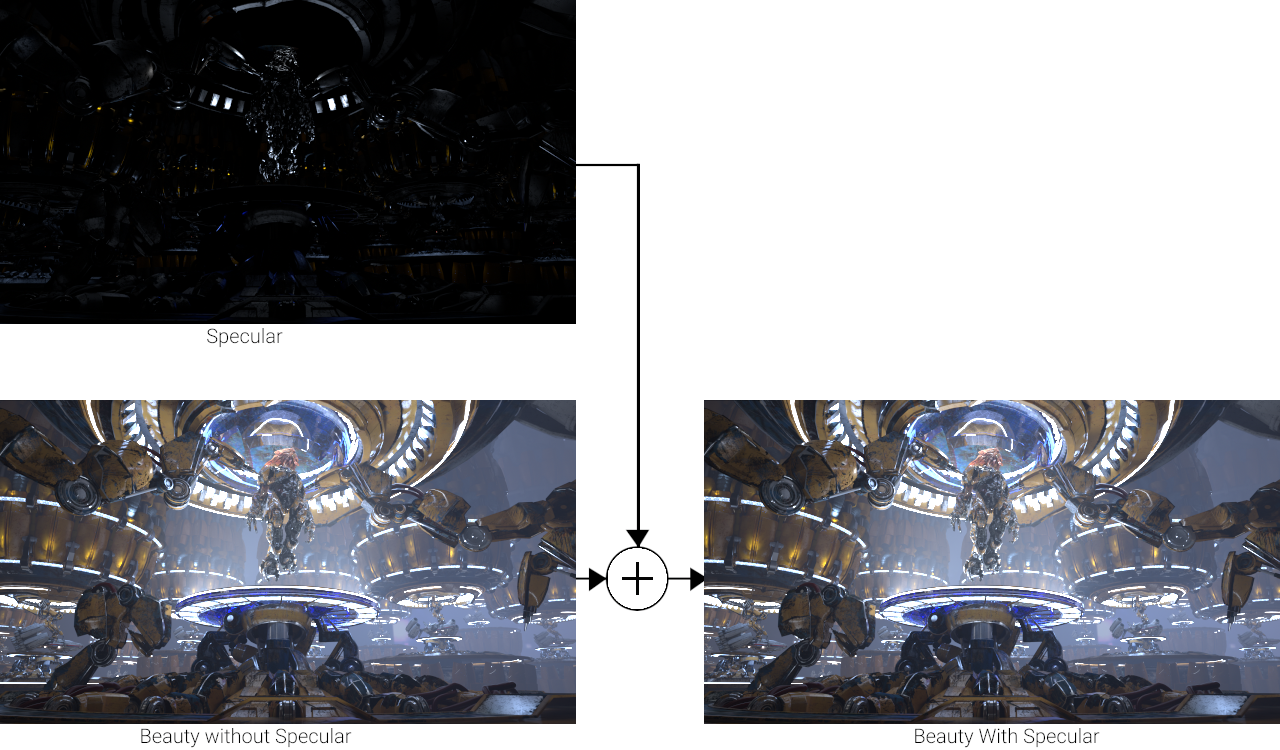

Underlying Compositing Formula
The vrayRE_Specular Render Element is added as part of the Beauty composite to form the final image.
