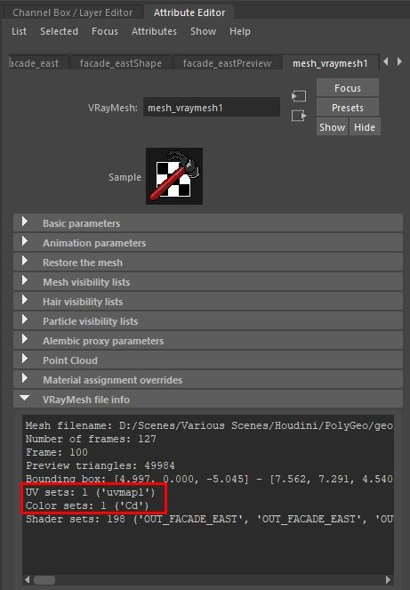

VRayMesh file info
Information about the UV sets and attributes available in the alembic file can be found in the VRayMesh file info rollout. |

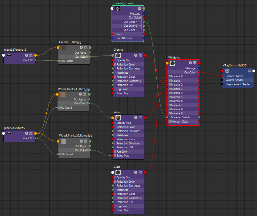

Windows MaterialTo make this material we use UVs from the alembic UV set and a component from the Color set. This material is assigned to the east_windows, north_windows, west_windows and south_windows objects. We reuse the Wood material and connect it to a new VRaySwitchMtl as Material 0. Create a new VRayMtl for the glass and set it as Material 1 in the VRaySwitchMtl. Then we make a new VRayMtl for the granite and connect it as a Material 2 in the switch material. To control what part of the geometry gets which material, we use VRayUserColor to read the material_indexes attribute and pass it as a Switch input to the VRaySwitchMtl. Use the Out Color R output of VRayUserColor to make the connection. The material_indexes attribute was specified in Houdini before packing the geometry, using a Create Attribute node. Only the red channel was used with a value of 0 for the wooden frame, 1 for the window pane and 2 for the granite sills. This way, even though the windows geometry is a single object, each part gets the correct material based on the attribute name. |
For the Glass material, the Diffuse Color is set to Black, as glass does not have diffuse color. The Reflection Color is a light gray and the Reflection glossiness is set slightly below 1 (0.98). Glass is refractive, so the Refraction Color is light gray. Refraction glossiness is set to 0.980. IOR is set to 1.530 (generally, the IOR of glass is 1.5) and a light blue tint is introduced by using the fog color with the Fog multiplier set to 0.3. |
For the Granite material, we use Granite_E_Diff.jpg as the Diffuse texture. The place2dtexture is automatically created and finds the UV coordinates from the alembic file. We introduce some reflection to the material by changing the Reflection Color to mid-gray and we lower the Reflection glossiness to 0.85. |

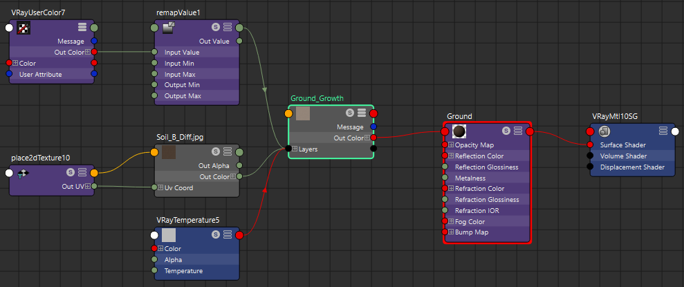

Ground MaterialFor this material we use the UVs from the alembic file and a component from the alembic Color set. The Ground material is applied to the ground object in this scene. To create the effect of gradually uncovering the ground texture with grass growing on it, we use a VRayLayeredTex with two layers. Leave all parameters at their defaults on the first layer – the diffuse will be mid-grey and the blend mode should be set to Normal. Use the Soil_BDiff.jpg texture as Tex Input for the second layer. To make the wave-like effect, we use a VRayUserColor to access the grass_bend_rnd attribute. - The red channel of this attribute stores the grass growth animation, created with a solver in Houdini.
- The green channel stores some noise generated in Houdini, that we use to bend the grass.
- The blue component stores another type of noise that can be used for additional randomization of the grass, but we do not use it in this tutorial. Feel free to try it yourself.
We only need the red channel for this material, but we'll use the other two channels later. Create a remapValue node and connect Out Color R from the VRayUserColor as input value. Add a new point to the remapValue's Color ramp at a position of 0.0075 and set the color to white. This will come in use when we make the Grass material in the next step. Connect the remapValue as the Mask of the second layer in VRayLayeredTex. |
Here is a render comparison of the ground with and without Color remapping. |
Here's how we create the grass. Select the ground object and add VRayFur to it. Select the VRayFur and set the Length to 25, Bend to 0.5 and Distribution Per Face to 8. |
Create a new VRayUserColor texture and add the grass_bend_rnd attribute name. Connect Out Color R and Out Color G to two separate remapValue nodes. Then, connect the two remapValue nodes to Length texture and Bend texture of the VRayFurProperties. Out Color G controls the bend value. The only thing to change is the Output Min, which is set to 0.3. |
Out Color R accesses an animated attribute, which controls where the grass is growing. Let's connect it to a RemapValue node and make a Value curve similar to what is shown in the image. This way, the grass will start spreading outwards like a wave with a peak in the beginning and then decreasing to the desired value. |
Here is the rendered results of the growing grass with and without remapping. You can clearly see the wave-like effect done with the remap curve. |
