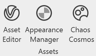

Assets
Provides access to the V-Ray Asset Editor, V-Ray Appearance Manager, and Chaos Cosmos Browser.

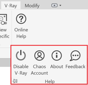

Provides access to the online V-Ray for Revit Help documents.
The following options are accessible through the panel:
- Online Help – Takes you to the V-Ray for Revit home page.
- Chaos Account – Opens the Chaos account management window. Here you can manually sign in and out, see the username of the signed-in client, and get quick access to licensing - http://127.0.0.1:30304/ , My.Chaos portal and the Chaos webstore.
- About – Displays V-Ray version information, Credits and Copyrights, and the End User License Agreement, as shown in the About Chaos V-Ray section.
- Feedback – Provide us feedback at the V-Ray for Revit forum.

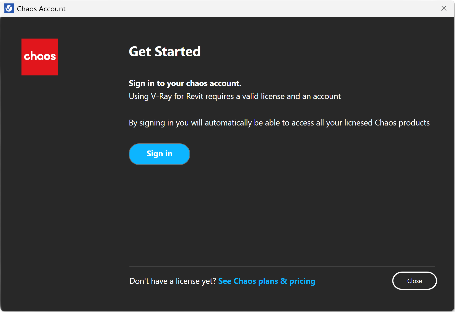

Chaos Account
This window shows you which account is currently used as a license holder. Press the Manage account button to open My Chaos portal and manage the licenses. You can assign, remove, and allocate licenses to different users. For more information, see the My Chaos Portal Guide page. To switch the current account, press the Sign Out button. If you haven't signed in during the installation, you can do so in this window:
See Chaos plans & pricing link leads you to V-Ray's pricing list on Chaos website. This window blocks all the rest of the UI, so make sure to close it once done to go back to Revit. |

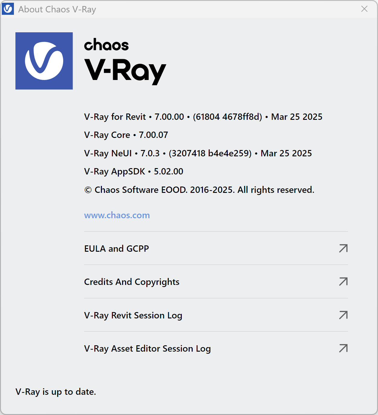

About Chaos V-Ray
The About Chaos V-Ray window displays information about V-Ray versions installed. It also provides links to the following:
The window is available from the V-Ray for Revit Ribbon > Online Help > About.
