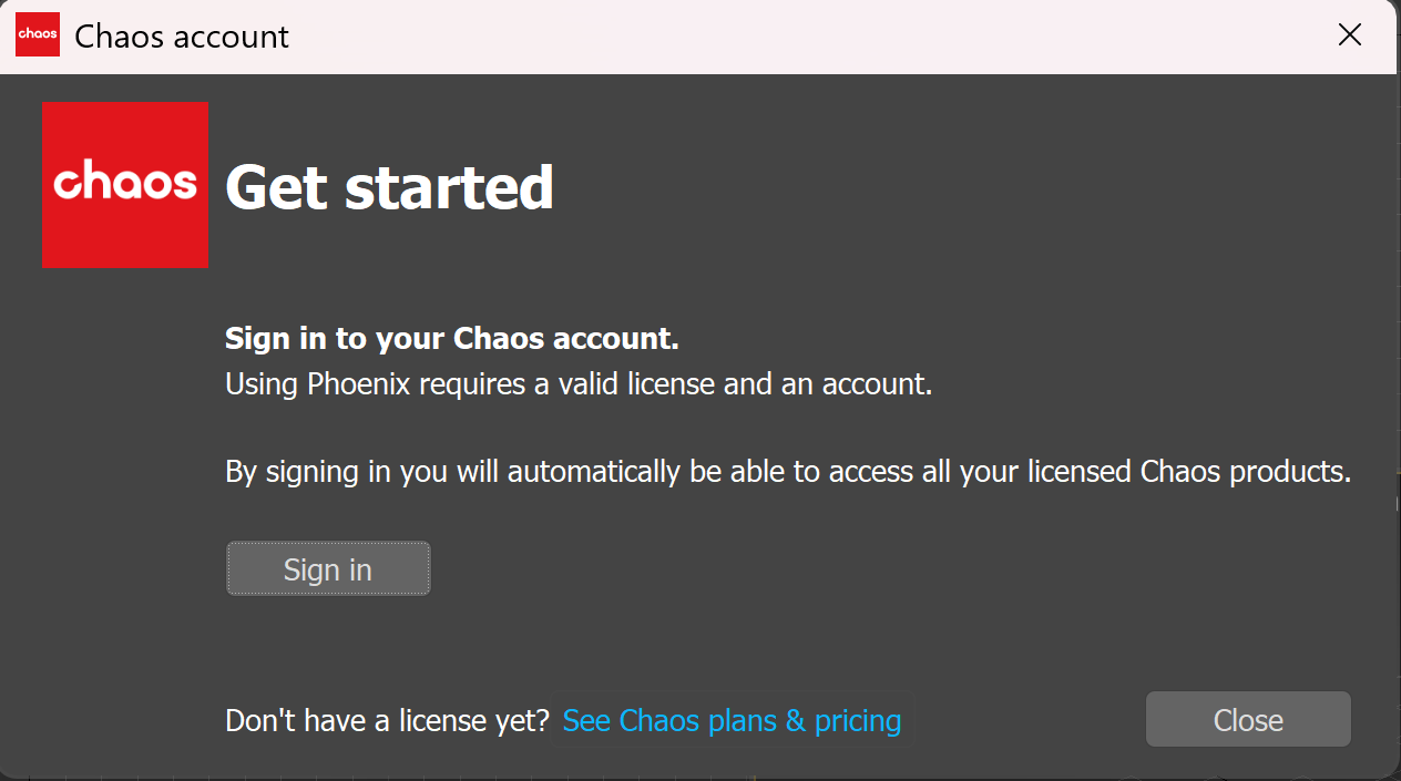

  • Open Maya and go to the Phoenix FD menu > Licensing > Chaos Account.
  • Select Sign in from this dialog.
If you don't sign in first, you are prompted to sign in the first time you use use Phoenix.
  • Enter your Chaos credentials.

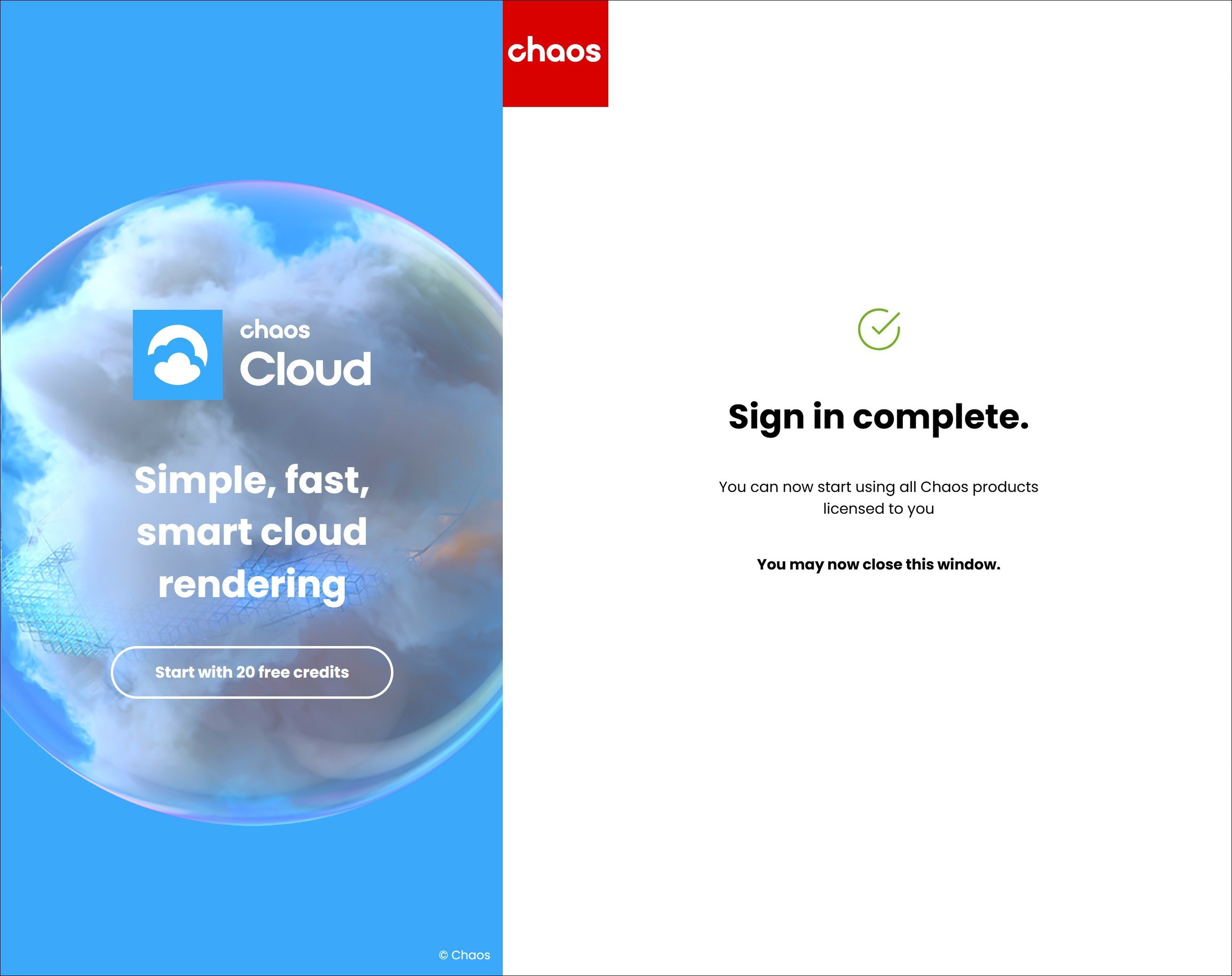

Chaos Single Sign-On Page
You can close the login page after seeing the confirmation for a successful login.
You can now start using your Chaos product.
Sign in confirmation
