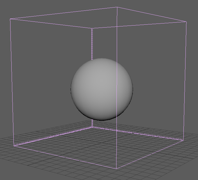

2.  Create a Phoenix Simulator using the () icon in the Shelf. Make sure the container encompasses the polySphere emitter object.

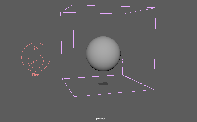

3.  Create a Fire Source (Phoenix Source) in the scene using the () icon in the Shelf, and click to place it next to the Simulator as shown in the picture.
The locator's size and position are not important, as long as it is easy to select when needed to access its attributes.

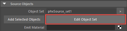

4.  Select the Phoenix Source node, and under the Source Object section in the Attribute Editor, click the Edit Object Set button to open the Relationship Editor. This allows you to connect an object to the source to be the emitter of the effect.

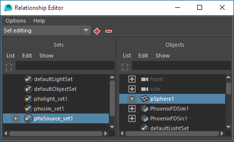

5.  Inside the Relationship Editor window, select the Object Set of the source on the left (e.g. phxSource_set...) and then click the polygon object to be the emitter on the right, so that both are highlighted, and then close the window.

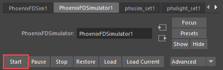

6.  Select the Phoenix Simulator.

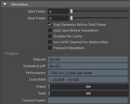

Start the simulation using the button on the Phoenix Shelf, or by clicking the Start button in the Simulation rollout of the Attribute Editor.
7.  The progress of the simulation is shown at the top of the Simulation rollout (or at the top of the viewport while the sim is calculating). To stop the simulation before it's finished, click the (Stop button in the Phoenix Shelf or the Stop icon in the Simulation rollout.
