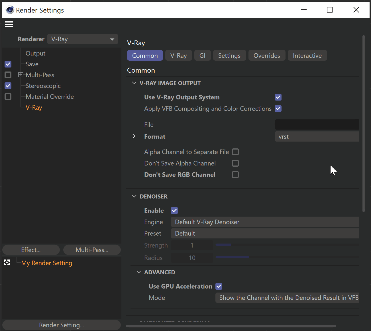

This page provides information about the Rendering Overrides Render Settings in V-Ray for Cinema 4D.
The Rendering Overrides can be used to override certain aspects of the way the scene is rendered.
UI Path: ||Render Settings|| > V-Ray > Overrides tab > Rendering rollout
