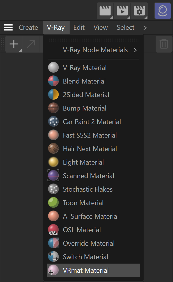

||V-Ray|| > VRmat Material

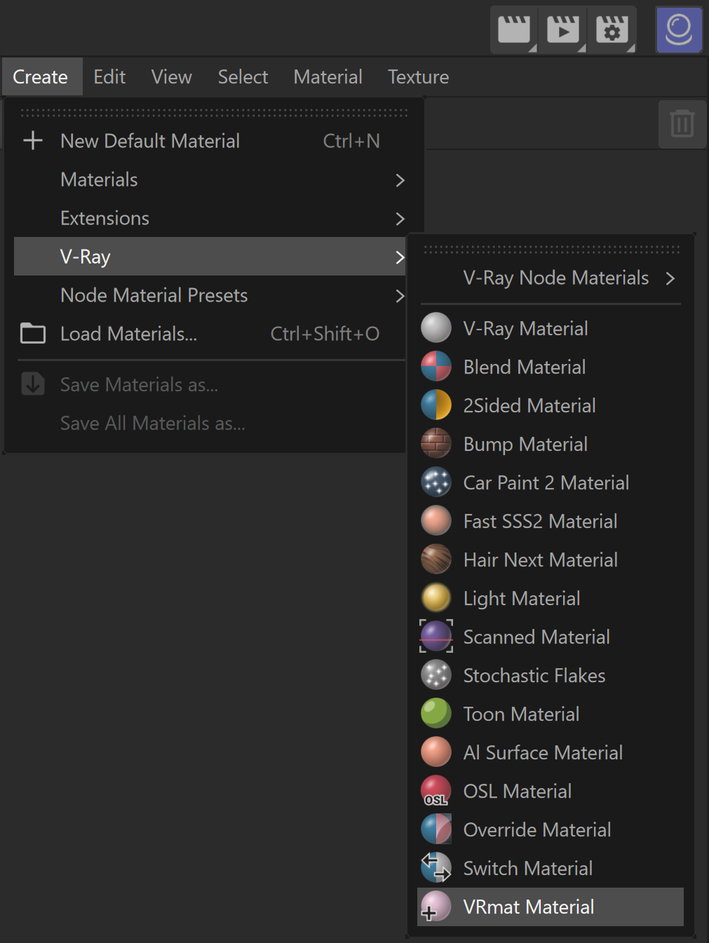

||Create|| > V-Ray > VRmat Material (disabled Separate menu for V-Ray materials)

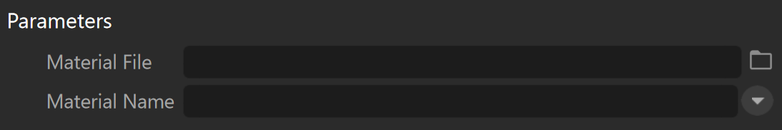

Material File – Loads a .vrmat, .vrscene, or .vismat containing one or more V-Ray materials or a .mtlx file.
Material Name – A list of all V-Ray materials saved inside the loaded .vrmat, .vismat, or .vrscene file or material loaded inside the .mtlx file.

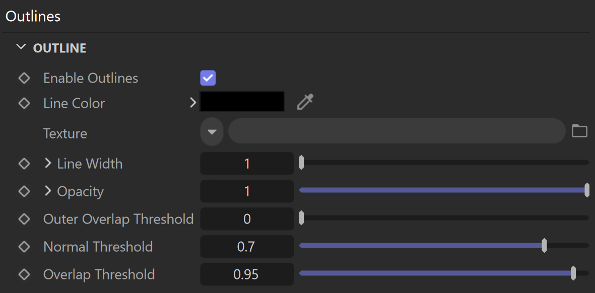

Enable Outlines – When enabled, adds outlines to the object the material is applied to. This option is disabled by default.
Line Color – Determines the color of the outlines. A Texture can be applied.
Line Width – Determines the width of the outlines in pixels. The soft limit is 100. Click on the  arrow to expand. A Texture can be applied.
Opacity – Determines how opaque the lines are. Click on the  arrow to expand. You can attach a Texture for the opacity. The Mix Strength option determines the percentage of blending between the Opacity value and the texture.
Outer Overlap Threshold – Determines when outlines are created for overlapping parts of the object. Lower values reduce the outer overlapping lines, while higher values produce more overlapping outer lines.
Normal Threshold – Determines at what point lines are created for parts of the object with varying surface normals (for example, at the inside edges of a box). Lower values mean that only sharper normals generate an edge, while a value of 0.5 means that 90 degrees or larger angles generate internal lines. Higher values mean that smoother normals can also generate an edge. Don't set this value to pure 1.0, as this fills curved objects completely.
Overlap Threshold – Determines when outlines are created for overlapping parts of the object. Lower values reduce the internal overlapping lines, while higher values produce more overlapping lines. Don't set this value to pure 1.0, as this fills the objects completely.

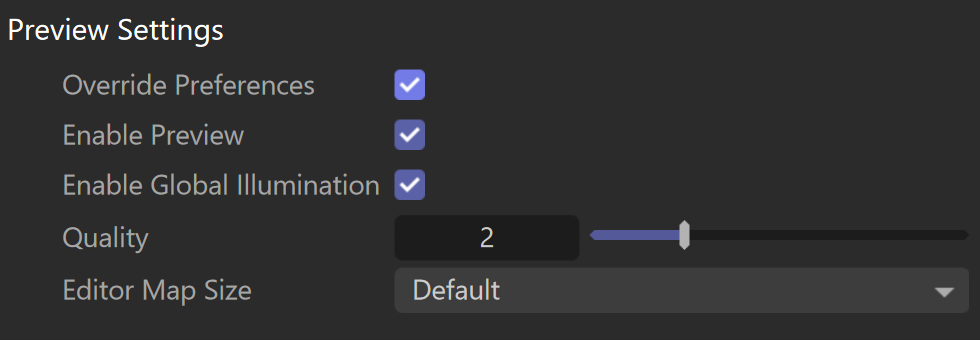

Override Preferences – When enabled, the parameters in this tab override the global preferences of the scene for the selected material.
Enable Preview – When disabled, the previews of the material in the Viewport and the Material Editor are disabled. The material is displayed in all black. This saves on processing power.
Enable Global Illumination – When disabled, global illumination is not calculated for the current material preview.
Quality – Determines the quality of the material previews. Higher values give more detail but slow down processing.
Editor Map Size – Determines the resolution of the material preview. If you have extra-detailed textures applied to the material, this option allows you to preview those textures in higher resolution at the preview step, without needing to render.
