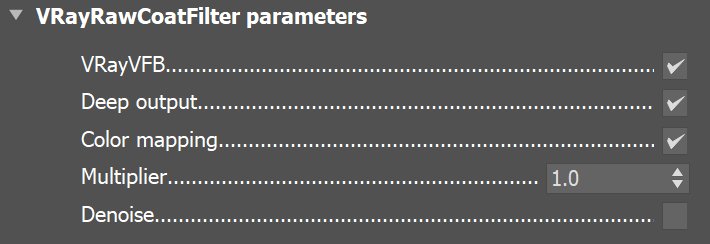

The Raw Coat Filter Render Element is similar to the Coat Filter Render Element, except it is not affected by Fresnel falloff. The result is a solid mask showing the areas of reflection calculated from the VRayMtl Coat Layer.
VRayVFB – When enabled, the render element appears in the V-Ray Frame Buffer.
Deep output – Specifies whether to include this render element in deep images.
Color mapping – Applies the color mapping options specified in the Color mapping rollout (Render Setup window > V-Ray tab) to this render element. This option is enabled by default.
Multiplier – Sets the overall intensity of the render element, where 1.0 is the standard multiplier.
Denoise – Enables the render element's denoising, provided the Denoiser render element is present.
