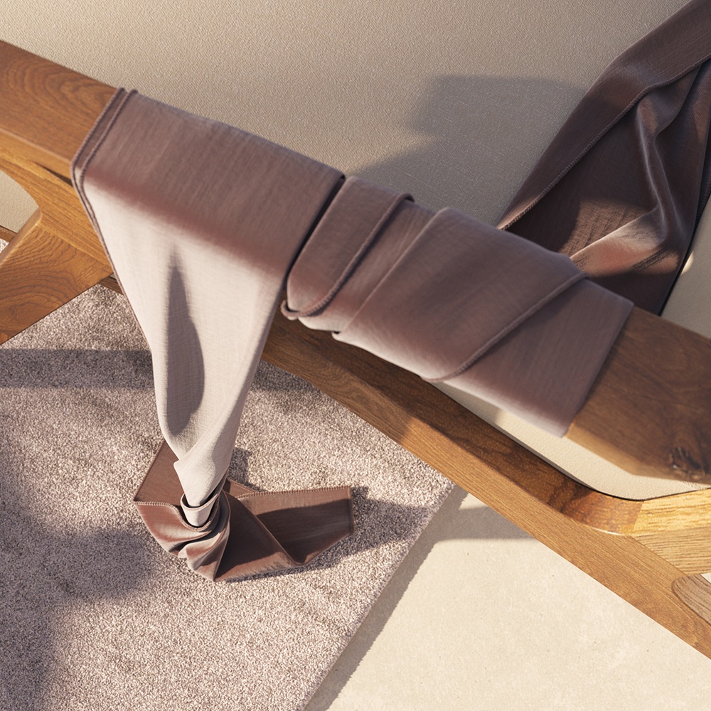

The Raw Sheen Reflection Render Element is useful for adjusting the appearance of sheen reflections, after rendering, inside a compositing or image editing software. For this example, the Raw Sheen Reflection and the Sheen Filter RE are used to brighten the reflections of the V-Ray Material's Sheen layer. See the render before and after compositing.
Before
After
