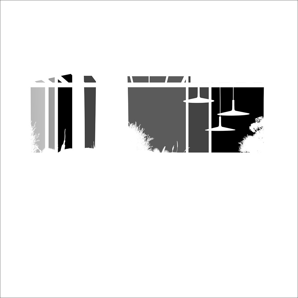

The Alpha channel is a grayscale image that stores the transparency of objects in the scene.
The Alpha channel shows the transparency of objects in the scene as grayscale colors. Solid geometry is represented by solid white, while those areas not blocked by geometry within the scene are black. Pixels at anti-aliased edges have varying shades of gray, as do semi-transparent surfaces.
The Alpha pass is generated automatically when rendering with V-Ray for Houdini.

The Alpha channel is primarily used as a mask to enable other elements to be placed behind the Beauty composite, such as the Background Render Element. The Alpha channel shown below takes into account the transparency of the glass in the windows and masks them. See how the render looks before and after compositing.

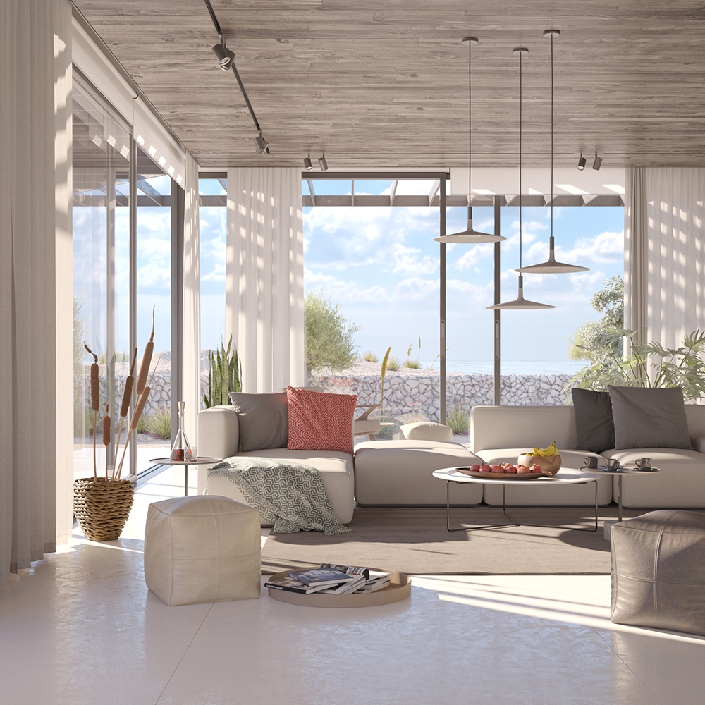

Before

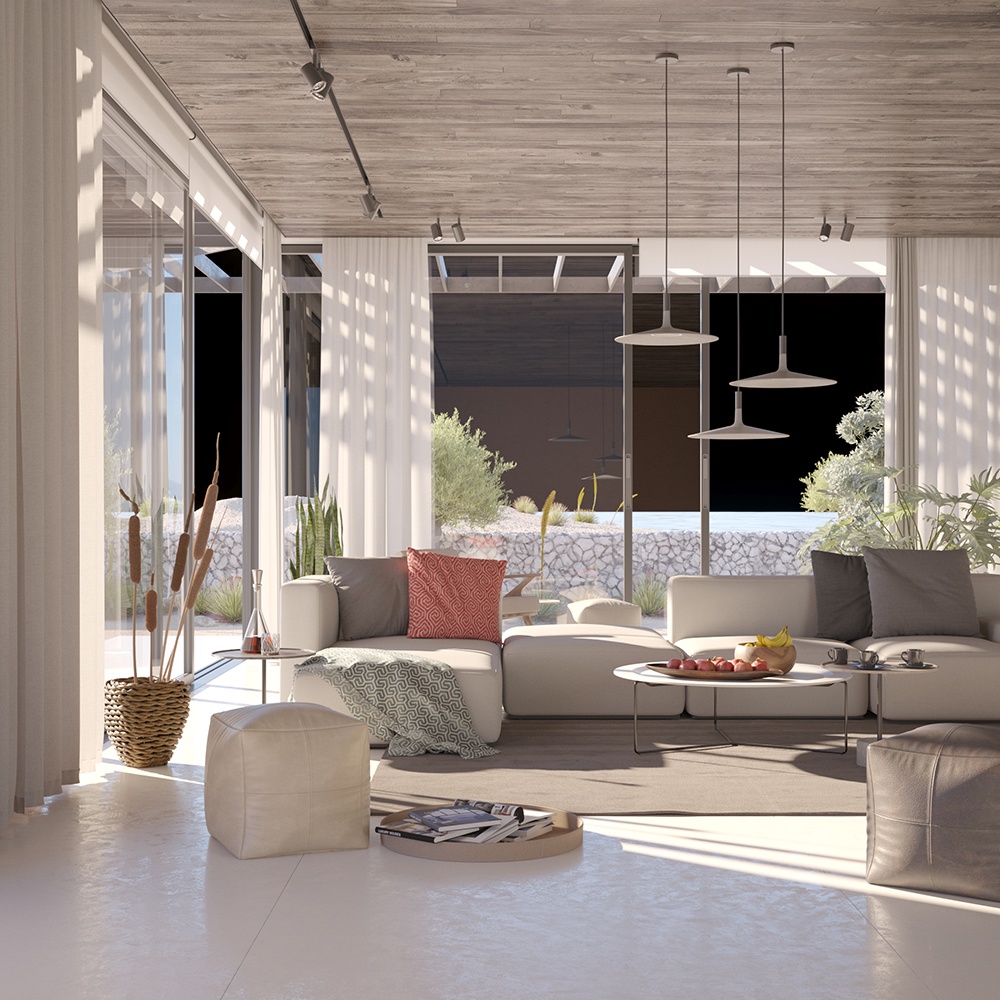

After
