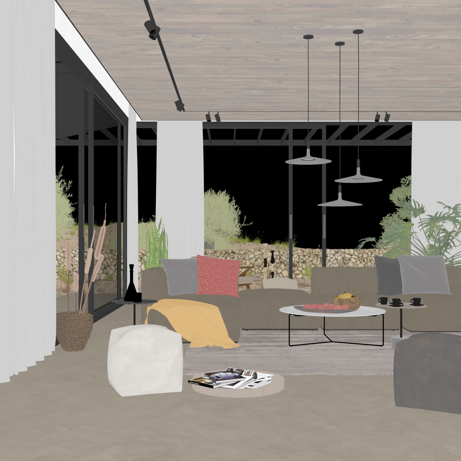

The Diffuse Render Element shows the colors and textures used in materials, flatly applied to objects with no lighting information. The colors are the actual colors set in the material definition, and each texture appears as it does in the texture (file) itself. There are no highlights or shadows, and any background image is not included.

The Diffuse is a very useful render element due to the number of raw passes with which it can be combined, giving the ability to manipulate many areas of the render at the composite level. The Diffuse pass can also be color-corrected on its own, as shown in the example. In this case, a Multi Matte Render Element is used to isolate the cloth on the sofa. The  Diffuse Render Element is used to change the cloth's color from yellow to blue. This method avoids tinting the lighting or shadowing of the scene.
Diffuse Filter Render Element
Original Beauty Render Element
Diffuse Filter Render Element with color corrections
Resulting composite with color corrections
