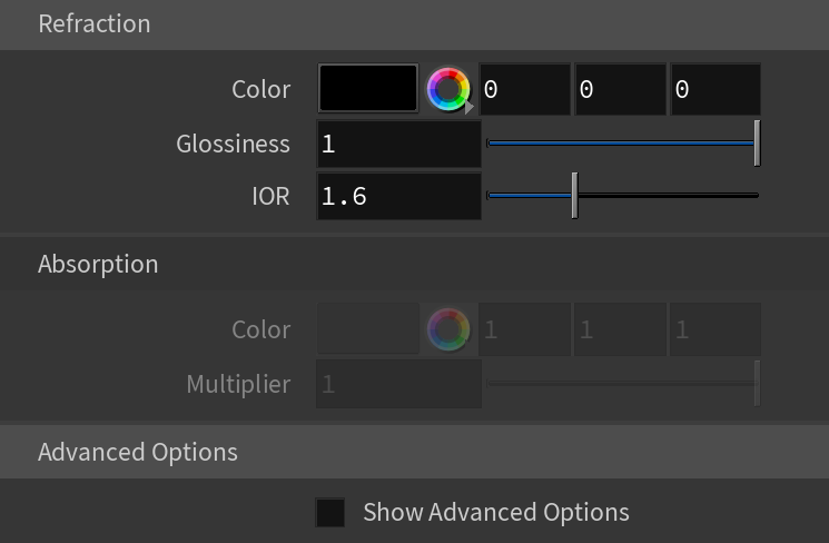

Transmission
Refraction
Color – Refraction color. Note that the actual refraction color depends on the Reflection Color as well.
Glossiness – Controls the sharpness of refractions. A value of 1.0 means perfect glass-like refraction; lower values produce blurry or glossy refractions.
IOR – Index of refraction for the material, which describes the way light bends when crossing the material surface. A value of 1.0 means the light does not change direction.
Absorption
Color – The attenuation of light as it passes through the material. This option helps simulate the fact that thick objects look less transparent than thin objects. Note that the effect of the absorption color depends on the absolute size of the objects and is therefore scene-dependent. This parameter can be mapped with a texture. It is recommended that you use a 3D texture for the purpose.
Multiplier – The strength of the absorption effect. Smaller values reduce the effect, making the material more transparent. Larger values increase the effect, making the material more opaque.
Show Advanced Options – When enabled, exposes some advanced options in this tab.

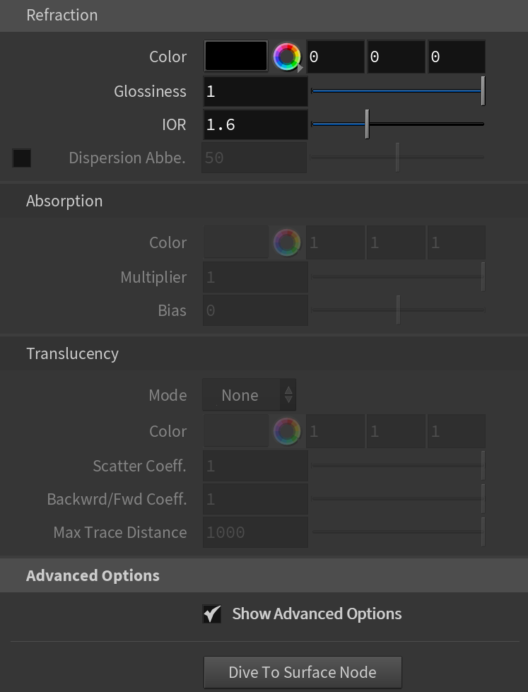

Refraction
Dispersion Abbe. – Increases or decreases the dispersion effect. Lowering it widens the dispersion and vice versa.
Absorption
Bias – Changes the way the fog color is applied. Negative values make the thin parts of the objects more transparent and the thicker parts more opaque and vice-versa (positive numbers make thinner parts more opaque and thicker parts more transparent).
Translucency
Mode – Selects the algorithm for calculating translucency (also called sub-surface scattering). Note that refraction must be enabled for this effect to be visible. Currently only single-bounce scattering is supported.
None – No translucency is calculated for the material.
Hard (wax) model – This model is specifically suited for hard materials like marble.
Soft (water) model – This model is mostly for compatibility with older V-Ray versions (1.09.x).
Hybrid model – This is the most realistic SSS model and is suitable for simulating skin, milk, fruit juice and other translucent materials.
Color – Normally the color of the sub-surface scattering effect depends on the Absorption color; this parameter allows you to additionally tint the SSS effect.
Scatter Coeff. – The amount of scattering inside the object. A value of 1.0 means rays are scattered in all directions; 0.0 means a ray cannot change its direction inside the sub-surface volume.
Backwrd/Fwd Coeff. – Controls the direction of scattering for a ray. A value of 1.0 means a ray can only go forward (away from the surface, inside the object); 0.5 means that a ray has an equal chance of going forward or backward; 0.0 means a ray is scattered backward (towards the surface, to the outside of the object).
Max Trace Distance – The number of times a ray can be reflected. Scenes with lots of reflective and refractive surfaces may require higher values to look correct.
Advanced Options
Show advanced OptionsWhen enabled, exposes some advanced options in this tab.
Dive to Surface Node – Press this button to dive into the Complex Material network of nodes and select the Surface Node.

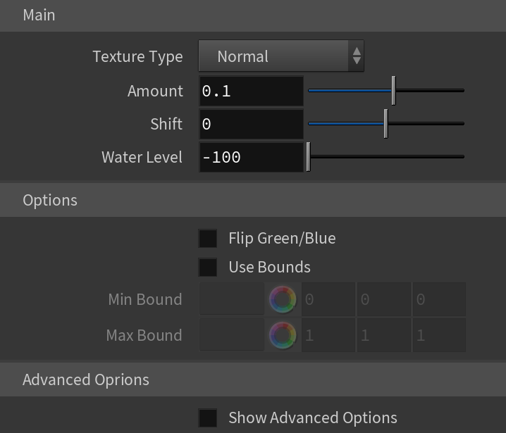

Displacement
Main
Texture Type – Specifies the mode in which the displacement is rendered.
Normal – Takes the original surface geometry and subdivides its triangles into smaller sub-triangles which are then displaced. It can be applied for arbitrary displacement maps with any kind of mapping.
2D – Bases the displacement on a texture map that is known in advance. The displaced surface is rendered as a warped height-field based on that texture map. The actual raytracing of the displaced surface is done in texture space, and the result is mapped back into 3D space. The advantage of this method is that it preserves all the details in the displacement map. However, it requires that the object have valid texture coordinates. You cannot use this method for 3D procedural textures or other textures that use object or world coordinates. The displacement map can take any values.
Vector – If using a displacement texture that is not grayscale, V-Ray converts it to grayscale before rendering the displaced geometry. This mode allows V-Ray to use the Red, Green, and Blue channels of the displacement texture to displace the geometry in the U and V directions in addition to the direction of the face normal.
Vector (Absolute) – A vector-type displacement mode in which the texture is interpreted as 0.5-based tangent space displacement map.
Vector (Object) – Only meaningful, if a VRayPtex texture is used for displacement, where the texture values represent 0-based displacement in object space. If mesh information is stored in the Ptex file, V-Ray can also displace correctly mesh deformations.
Amount – The amount of displacement for white areas of the displacement map. If Use Global Settings is enabled, this value is multiplied by the global displacement Amount option. A value of 0.0 means the object appears unchanged. Higher values produce a greater displacement effect. This can also be negative, in which case the displacement pushes geometry inside the object.
Shift – Specifies a constant which is added to the displacement map values, effectively shifting the displaced surface up and down along the normals. This can be either positive or negative.
Water Level – Geometry below this displacement level threshold is clipped away. This can be used for clip mapping a displacement map value below which geometry is clipped.
Options
Flip Green/Blue – When enabled, the Green and Blue channels of the supplied texture map are swapped.
Use Bounds – When enabled, sets the minimum and maximum values for the displacement texture.
Min/Max Bound – These two options allow you to specify custom boundaries for the displaced geometry when Use Bounds is enabled. By default is limited to values between 0 and 1.
Show Advanced OptionsWhen enabled, exposes some advanced options in this tab.

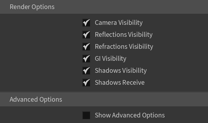

Render Options
Camera Visibility – When disabled, the object is not visible to camera rays.
Reflections Visibility – When disabled, the object appears perfectly transparent to reflection rays.
Refractions Visibility – When disabled, the object appears perfectly transparent to refraction rays.
GI Visibility – When disabled, the object is considered perfectly transparent to GI rays.
Shadows Visibility – When disabled, the object is invisible to shadow rays from lights and does not cast shadows.
Shadows Receive – When disabled, the object does not receive shadows.

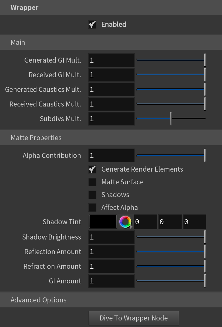

Wrapper
Enabled – Enables the Wrapper options.
Main
Generated GI Mult. – A multiplier for the amount GI generated by the material.
Received GI Mult. – A multiplier for the amount GI received by the material.
Generated Caustics Mult. – A multiplier for the amount of caustics generated by the material.
Received Caustics Mult. – A multiplier for the amount of caustics received by the material.
Subdivs Mult. – A multiplier for the subdivisions of all secondary ray tracing done for the particular surface.
Matte Properties
Alpha Contribution – Determines the appearance of the object in the alpha channel of the rendered image. A value of 1.0 means the alpha channel is derived from the transparency of the base material. A value of 0.0 means the object does not appear in the alpha channel at all and shows the alpha of the objects behind it. A value of -1.0 means that the transparency of the base material is cut out from the alpha of the objects behind. Matte objects are typically given an alpha contribution of -1.0. Note that this option is independent of the Matte surface option (i.e. a surface can have an alpha contribution of -1.0 without being a matte surface).
Generate Render Elements – When enabled, V-Ray generates zDepth, velocity, extra tex and multi matte render element for matte objects. When this check box is disabled V-Ray does not generate any render elements for matte objects.
Matte Surface – Makes the material appear as a matte material, which shows the background, instead of the base material, when viewed directly. Note that the base material is still used for things like GI, caustics, reflections, etc.
Shadows – When enabled, makes shadow visible on the matte surface.
Affect Alpha – When enabled, makes shadows affect the alpha contribution of the matte surface. Areas in perfect shadow produce white alpha, while completely unoccluded areas produce black alpha.
Shadow Tint – An optional tint for the shadows on the matte surface.
Shadow Brightness – An optional brightness parameter for the shadows on the matte surface. A value of 0.0 makes the shadows completely invisible, while a value of 1.0 shows the full shadows.
Reflection Amount – Shows the reflections from the base material.
Refraction Amount – Shows the refractions from the base material.
GI Amount – Determines the amount of GI shadows.
Advanced Options
Dive To Wrapper Node – Press this button to dive into the Complex Material network of nodes and select the Wrapper Node.
