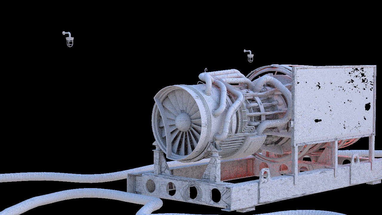

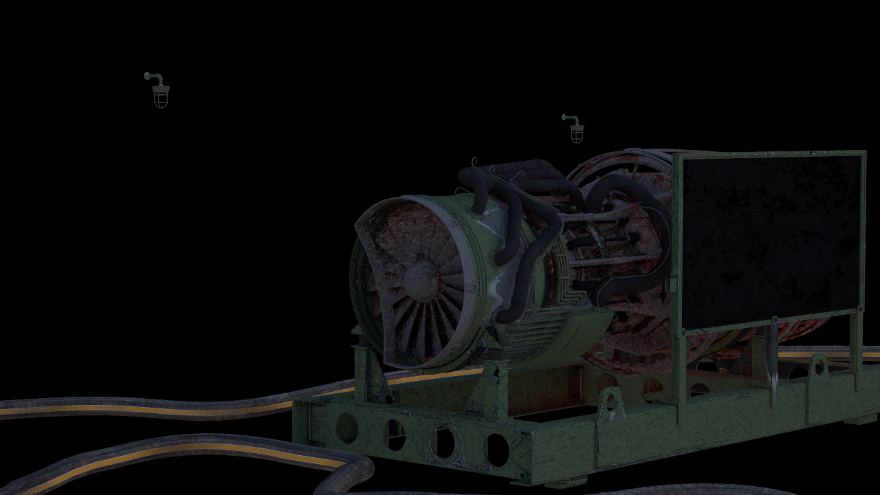

  • Global Illumination Render Element (GI) - Stores the diffuse surface global illumination in a scene when Global Illumination is enabled. This pass is already attenuated by the diffuse contribution in the scene and can be used directly in composite.
  • Raw Global Illumination Render Element (GI Raw) - Stores the raw information for the indirect lighting information calculated in the scene, untouched by the diffuse contribution. This pass is used to fine-tune the GI in a scene before attenuating it with the diffuse contributions of the scene.

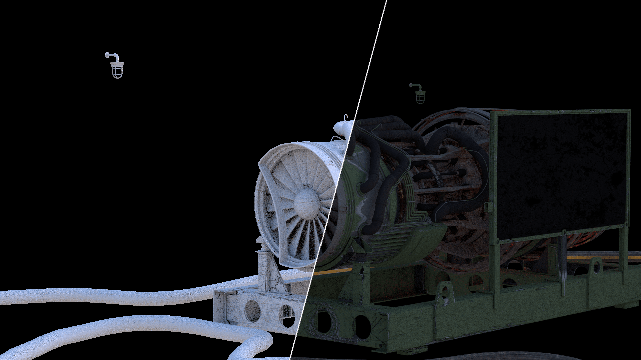

The Global Illumination render element itself (GI) can be used in Back to Beauty compositing to add in the GI lighting contribution to the scene. The GI contribution may be adjusted (tinted, brightened, darkened, etc.) in the composite as needed without the need to rerender the scene.
When even more control over the GI contribution to the final image is desired, this main Global Illumination Render Element can be re-created by multiplying the Raw Global Illumination Render Element with the Diffuse Render Element:
GI Raw x Diffuse = GI
