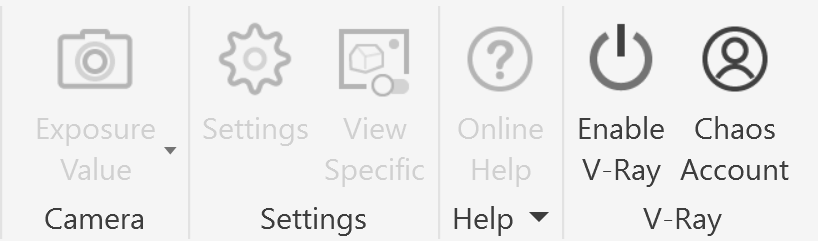

Start Revit.
Press the Enable V-Ray button.
If you prefer your V-Ray license to be engaged automatically every time when Revit is loaded, use the Obtain License on start-up option.

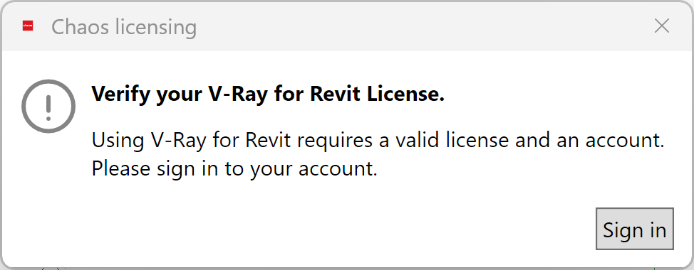

The first time you use V-Ray, a prompt to log in with your Chaos account may appear.
Alternatively,

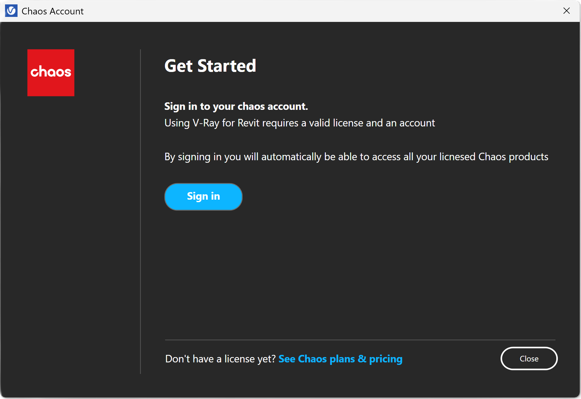

  • Open Revit and go to V-Ray Ribbon > Chaos Account.
  • Select Sign in from this dialog.
  • Enter your Chaos credentials.

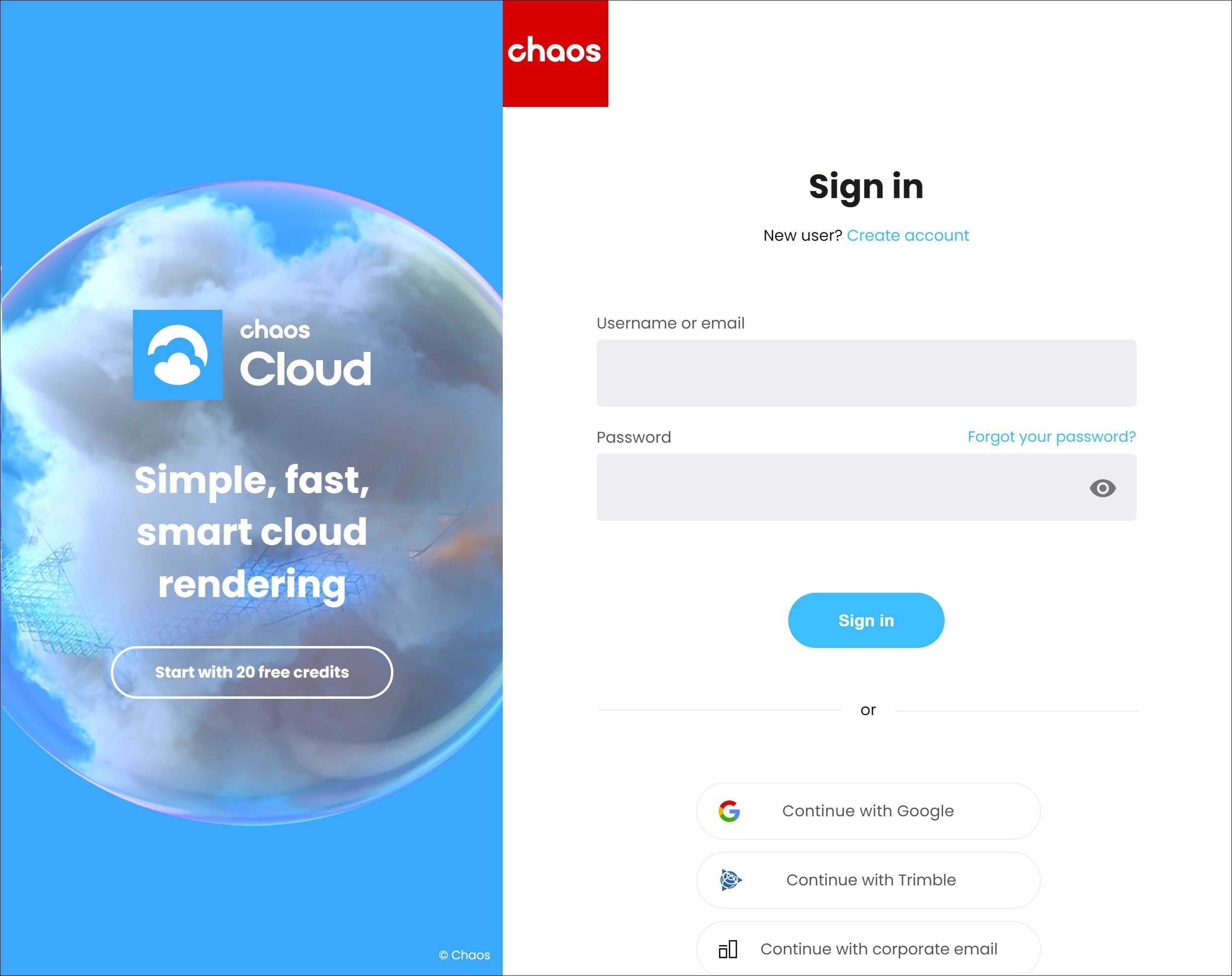

You can use your Chaos account credentials.
Your existing Enscape, V-Ray, Corona, Anima or Veras logins are all Chaos accounts and work for all our products.
If you have never had a Chaos account, you can create one at this step.
Chaos Single Sign-On Page

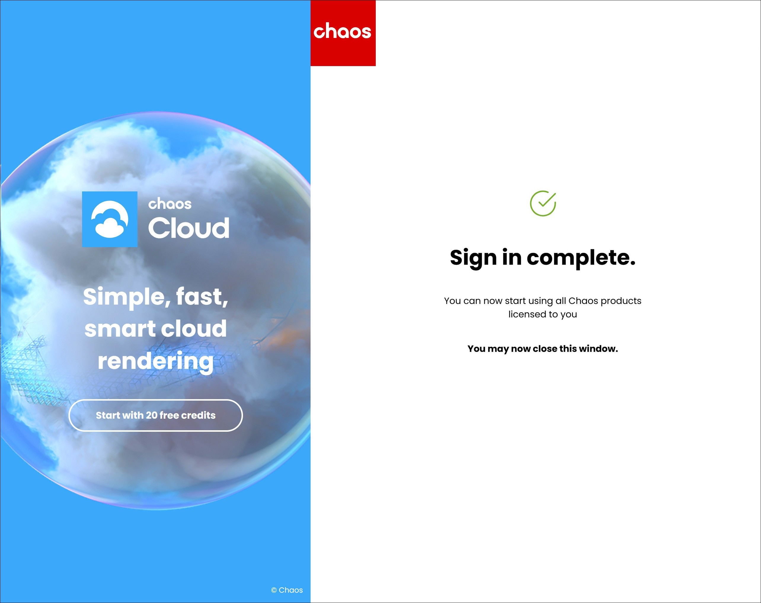

You can close the login page after seeing the confirmation for a successful login.
You can now start using your Chaos product.
Sign in confirmation
