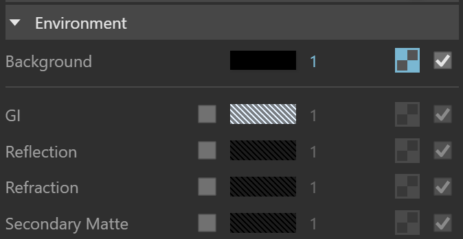

The Environment section in V-Ray render parameters is where you can specify a color or a texture map to be used during GI and reflection/refraction calculations. If you don't specify a color/map, then the background color and map specified in the Rhino Environment dialog are used by default.
For all volumetric environment effects, check Volumetric Environment page.
UI Path
||V-Ray Asset Editor|| > Settings > Environment rollout
Background – Specifies a color/texture map to be visible in the background and used during GI and reflection/refraction calculations. Press the checkerboard button to select a texture. If a texture is selected, it overrides the color as long as the texture checkbox is enabled.
GI (skylight) – Specifies a color/texture map to override the Environment GI rays. The effect of changing the GI environment is similar to a dome light. Note that Global Illumination (GI) must be enabled.
Reflection – Specifies a color/texture map to override the Environment reflection rays. Note that you can also override the reflection environment on a per material basis (see Generic) or a per map basis. If you do not enable the Refraction override, this group of controls affects both reflections and refractions. If you enable the Refraction override, then this group affects only reflections.
Refraction – Specifies a color/texture map to override the Environment refraction rays. This color is ignored if there is an environment texture specified.
Secondary Matte – Specifies a color/texture map to override the Environment rays affecting Matte objects.
