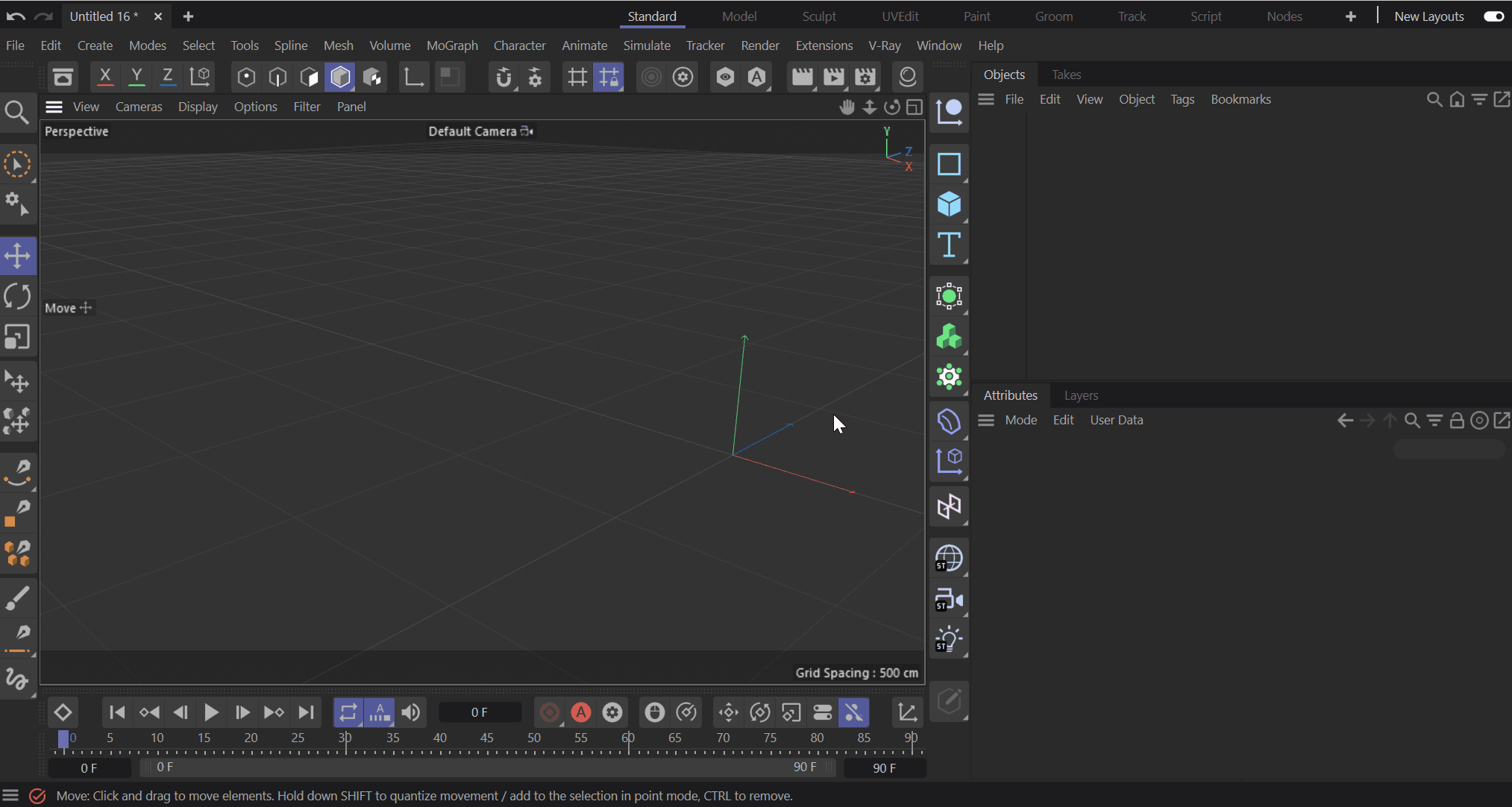

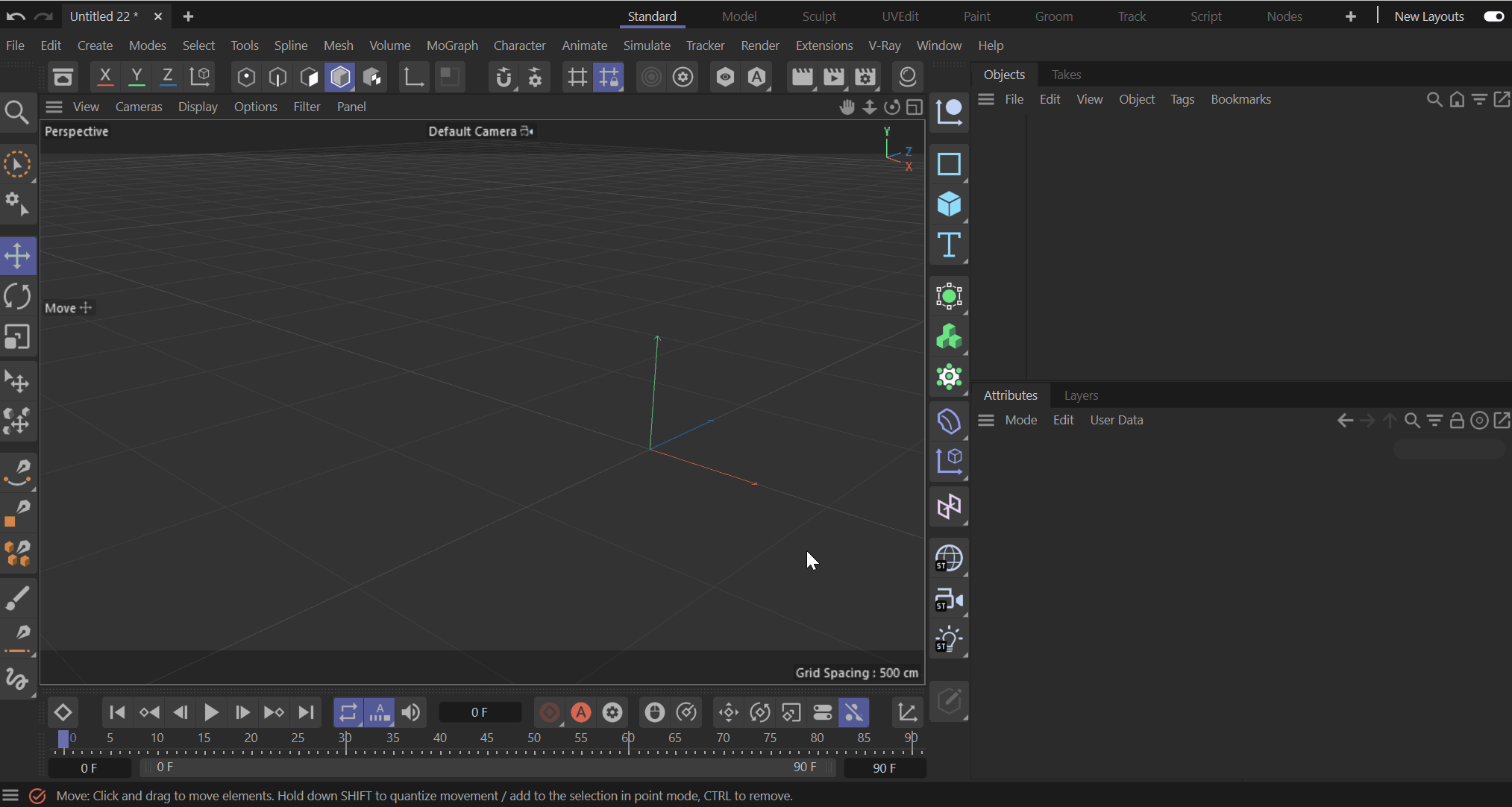

How to Import a V-Ray Scene
Drag-n-drop
To import a vrscene file, you can use the drag-and-drop functionality.
The VRaySceneImport window prompts you to choose how to import the file in Cinema 4D. See the VRaySceneImport section of this page for descriptions of all the options.
File > Open Project
Go to File > Open Project and select a .vrscene file. The VRaySceneImport window prompts you to choose how to import the V-Ray Scene into Cinema 4D.
You can also merge a V-Ray Scene into your current scene by loading it from the File > Merge Project option.
V-Ray Toolbar
Go to the V-Ray menu > Tools > V-Ray Toolbar. The V-Ray Toolbar is a palette that can be docked anywhere in the interface.
Select V-Ray Scene ( ) and select a .vrscene file. The file is imported as a V-Ray Scene Reference.
Through V-Ray menu
You can import a .vrscene file using the V-Ray menu. Select Geometry > V-Ray Scene.
From Attributes, go to the General tab of the V-Ray Scene. From File Path, select the .vrscene file. It loads in the 0,0,0 coordinates in Cinema 4D. The file is imported as a V-Ray Scene Reference.
