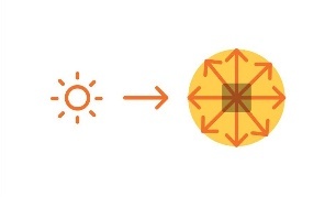

Example: Phase Function
Phase Function = -0.5
Phase Function = 0
Phase Function = 0.5
Move the slider to see the example renders.
Phase Function = -0.5 (Backward Scattering)
Phase Function = 0 (Isotropic Scattering)
Phase Function = 0.5 (Forward Scattering)
The orange arrow represents a ray of light going through the volume and the possible scattering directions for the ray.
