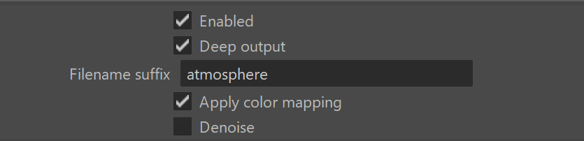

Enable – When enabled, the render element appears in the V-Ray Virtual Frame Buffer.
Deep output – Specifies whether to include this render element in deep images.
Filename suffix – The text added to the end of the rendered file, when saved as a separate file (e.g. myrender.atmosphere.vrimg).
Apply color mapping – Applies the color mapping options specified in the Color Management rollout of the VRay tab in the Render Settings window to this render element. This option is enabled by default.
Denoise – Enables the render element's denoising, provided the Denoiser render element is present.

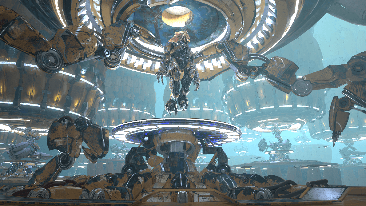

The Atmospheric Effects Render Element is useful for changing the appearance of the atmosphere and volumetric effects in a rendered image using compositing or image editing software. Below is an example of its use.

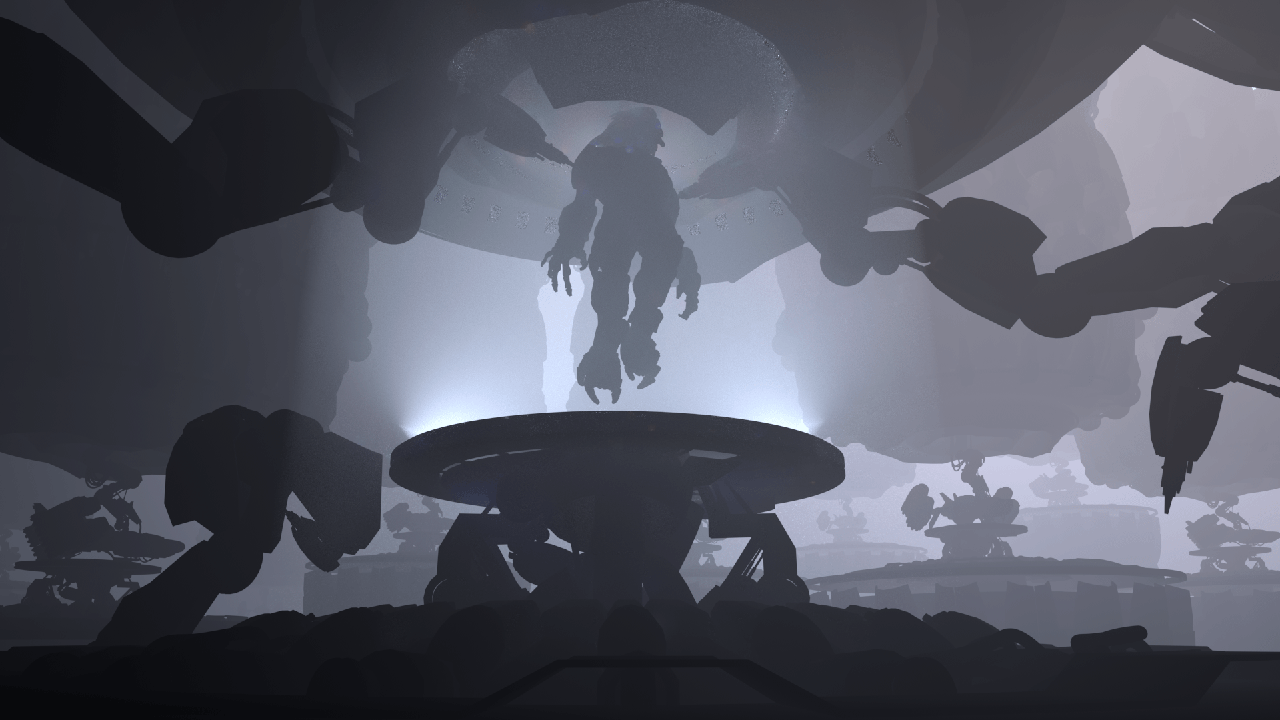

Atmosphere Render Element, with fog
generated by VRayEnvironmentFog

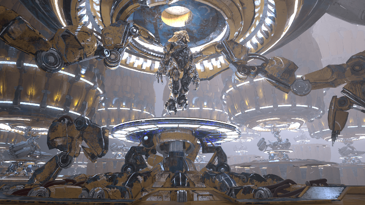

Original Beauty composite
Color of atmosphere changed and intensity increased
