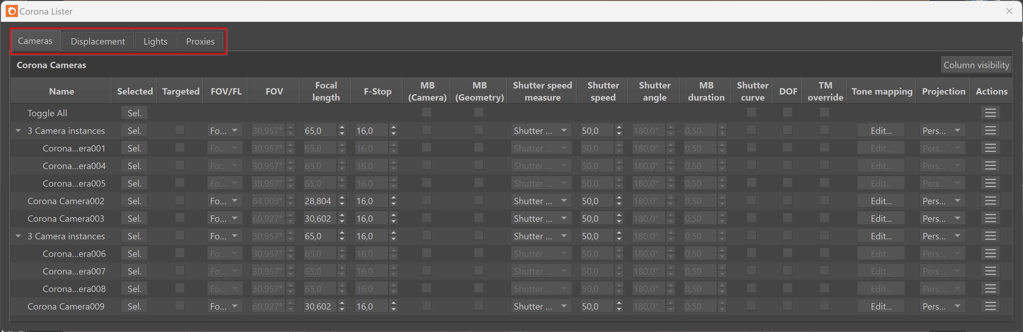

The Interface Tabs
 Corona Lister consists of four main tabs:  Cameras Displacement,  Lights, and Proxies.
Corona Lister Interface Tabs

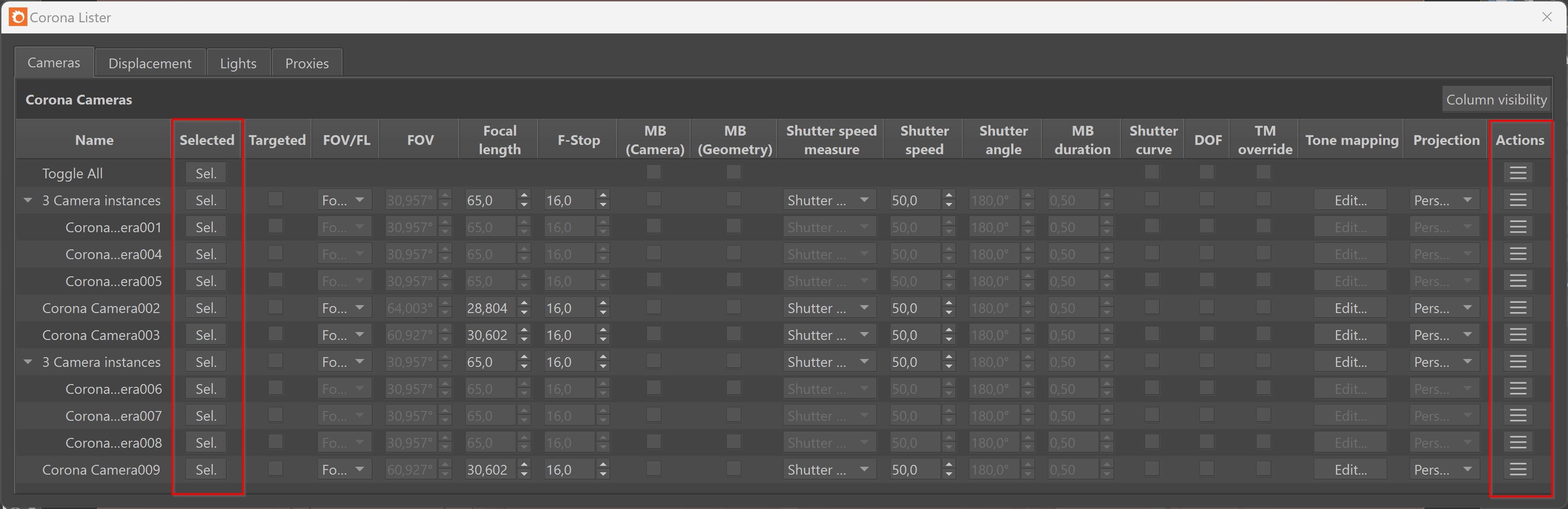

Selected and Actions Columns
The Selected column allows you to quickly select each item listed. The Actions column provides quick access to make changes to the items, with the options varying depending on the active tab.
Corona Lister 'Selected' and 'Actions' Column

Cameras Tab
Cameras Tab provides a list of all Corona Cameras available in the scene. Here, you can easily access and adjust various camera settings, including tone mapping and projection for each Corona Camera. The Instanced Corona Cameras are organized in a dropdown menu for easy selection. Any modifications made to a specific Corona Camera are automatically applied to all its instances. You can also choose to make any instance unique by right-clicking and selecting "Make unique" option.
Corona Lister showing 'Camera' Tab

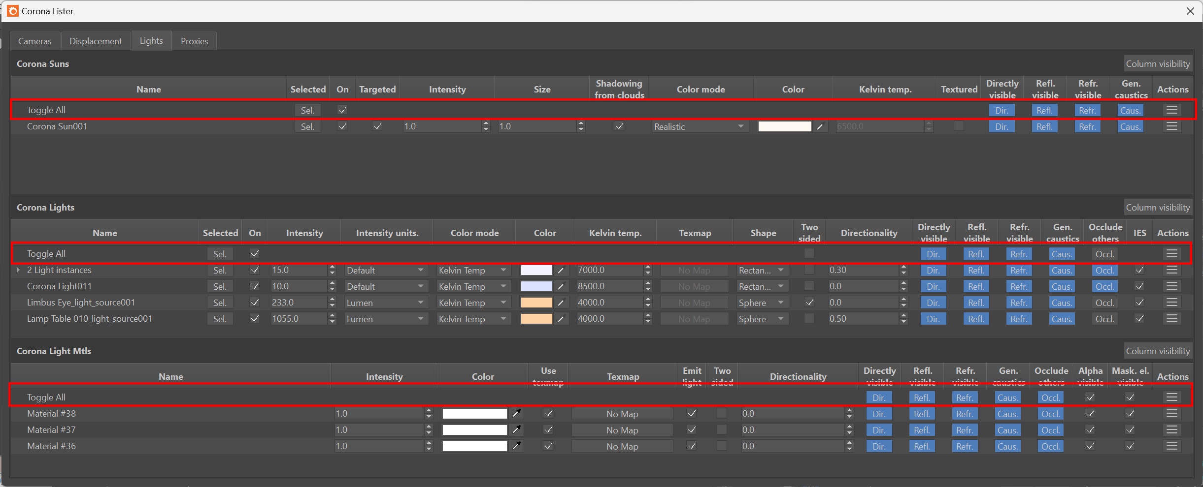

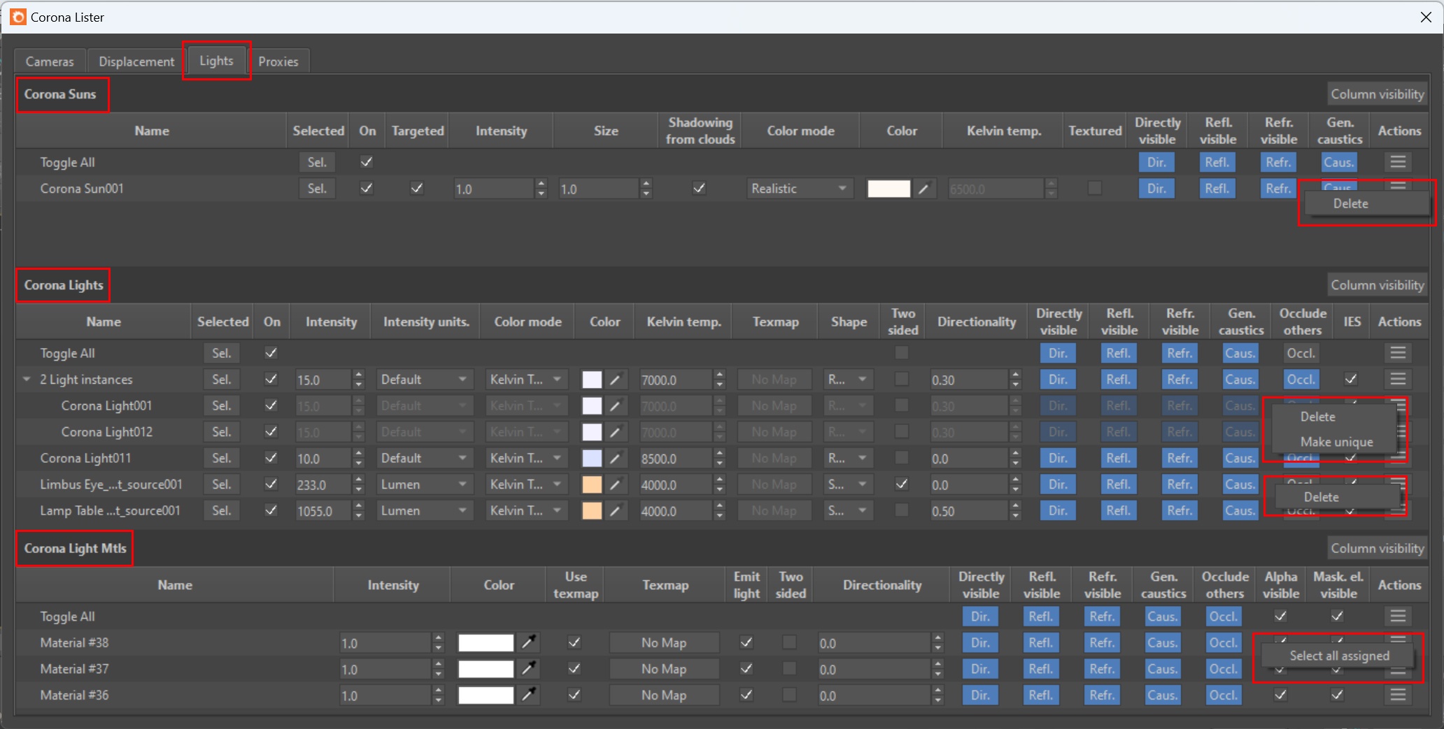

Lights Tab
The lights tab provides a list of all Corona Sun , Corona Lights, and Corona Light Materials present in the scene. The Instanced Corona Lights are easily organized and can be selected from a dropdown menu. Any modifications made to a specific Corona Light are automatically reflected across all its instances. With Corona 11 release,  the Lister also allows you to add maps to Corona Lights, and Corona Light Materials.
Corona Lister showing the 'Lights' tab
Actions available in this tab:
  • Delete: This removes the selected Corona Sun or Light.
  • Select all assigned (only for Corona Light Mtls): This selects all objects with the selected Corona Light material.
  • Make unique: To make the selected instanced light unique.
  • Select all assigned (only for Corona Light Mtls): To select all objects on which the selected Corona Light material is applied.
Corona Lister Lights Tab Actions Button options

Example Scene
In this example, we are using a simple interior scene with several Corona lights. The ceiling lights have been instanced and grouped together in the Corona Lister. To change and affect all the values of instanced lights, simply change the parameter of a single light. The side rectangle lights and floor lamp lights are listed separately in the Corona Lister because they are unique and must be adjusted individually to achieve the desired lighting effect. Also, there are multiple Corona Cameras in the scene which are listed in the Corona Lister. All settings can be quickly changed and managed using the Corona Lister.
Scene Setup
A scene with multiple Corona Lights.
Corona Lister - Lights Tab
The Corona Lister can be used to manage multiple Corona Lights in the scene.
