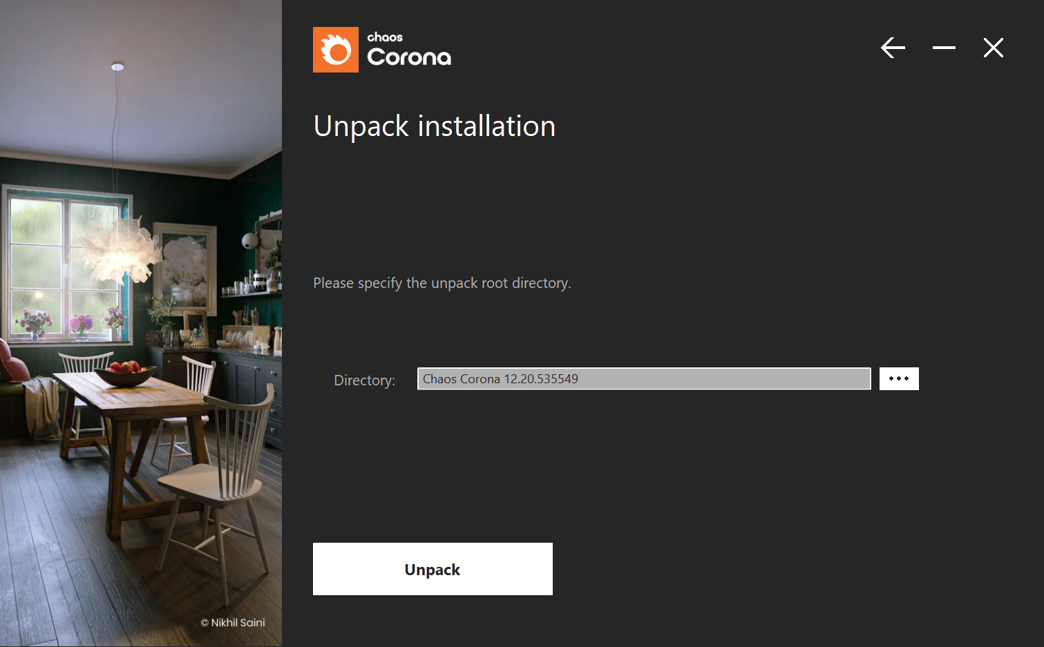

Unpack Installation
This is an optional step.
Directory – Specifies an unpack root directory where the installer files are extracted.

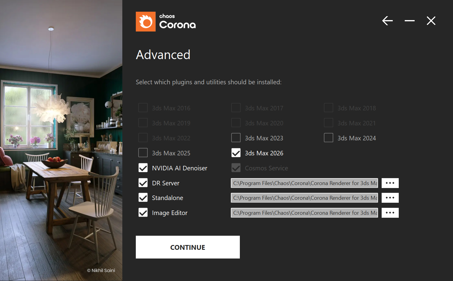

Here, you can specify for which version of 3ds Max to install Corona. You can also select components you wish to include in the installation - Chaos Cosmos Service and NVIDIA AI Denoiser.
Also, decide if you need to install the DR Server, Corona Standalone and the Corona Image Editor, and if so, where you want to install them.
Click Continue to proceed.

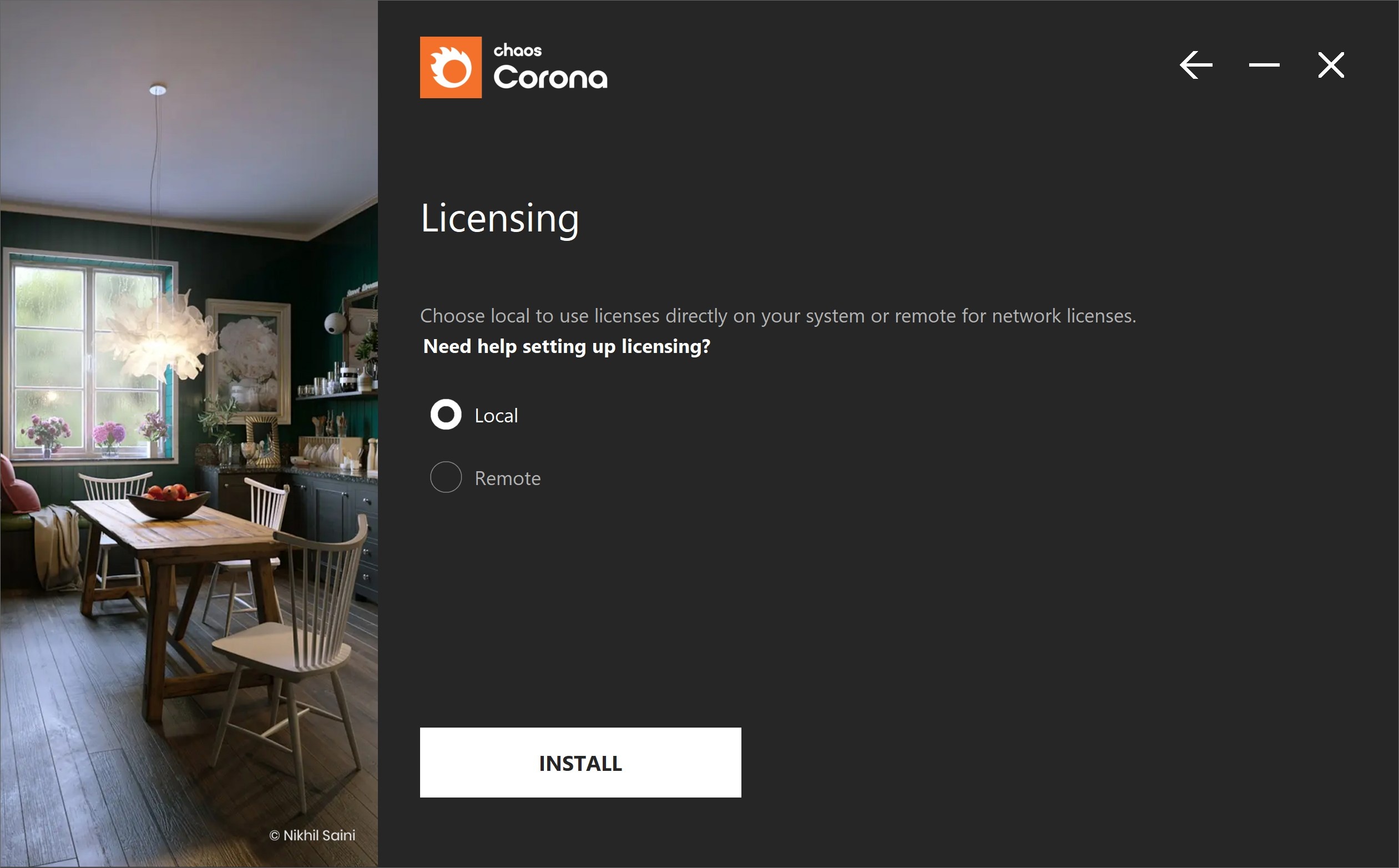

Licensing
In this step, you can specify whether the Chaos License Server runs locally or on another machine.
Local – This option installs the License Server on your machine. For a walkthrough, see the Activating Corona.
Remote – This option allows you to configure your Chaos product for floating licenses in a local network. Fill in the IP address of the Chaos License Server in your network in the Primary License Server field. Please leave the port 30304 unchanged. For more details on this setup, see the License Server Deployment page.

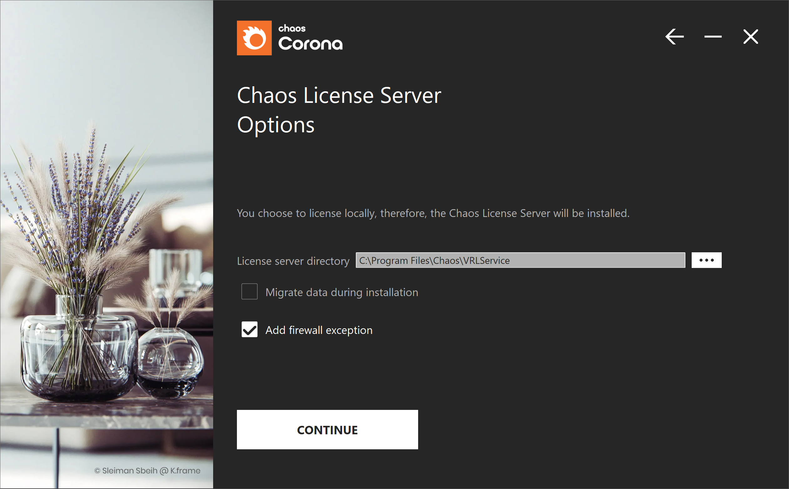

At this step, you can choose where to install the Chaos License Server.
Migrate data during installation – When enabled, it transfers all of your settings made with older versions of the License Server, such as proxy settings, etc. Disabling this option makes a clean install of License Server with any custom settings from previous installations reset to their defaults.
Add firewall exception – Allows the default licensing port (TCP 30304) in the firewall. If you disable it at this step, you must manually add firewall exceptions later.

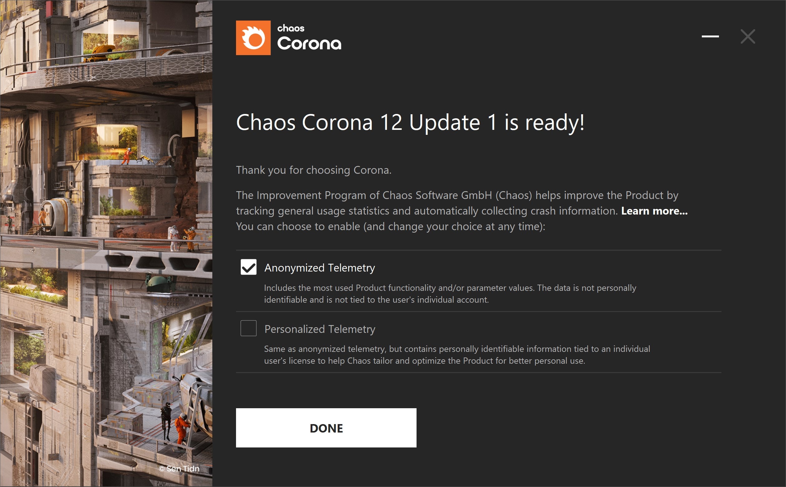

Chaos Telemetry
Corona for 3ds Max installation is successful.
Participate in the improvement decisions for future versions of Corona. No intellectual property is violated when agreeing to participate in the improvement program. Chaos does not gather scenes, assets, materials, etc. For more information, see the Chaos Telemetry page.
Anonymized Telemetry – Includes the most used product functionality and/or parameter values. The data is not personally identifiable and is not tied to the user's individual account.
Personalized Telemetry – Includes the most used product functionality, parameter values, but also contains personally identifiable information tied to an individual user's license. This helps Chaos tailor and optimize the product for better personal use.

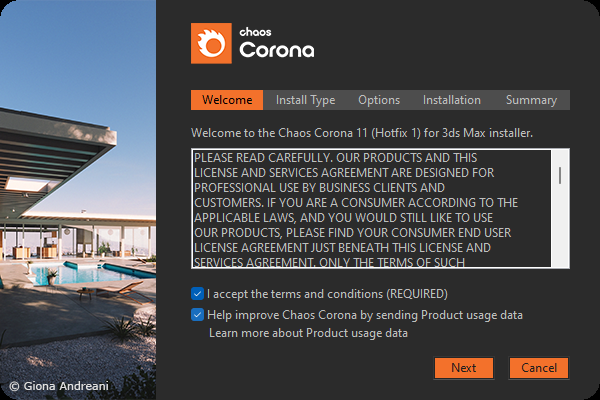

Welcome
Please take a moment to review the End User License Agreement. Once you've carefully read the License Agreement, you can click I accept the terms and conditions if you agree to the terms.
Participate in the improvement decisions for future versions of Corona by agreeing to Help improve Chaos Corona by sending Product usage data. No intellectual property is violated when agreeing to participate in the feedback program. Chaos does not gather scenes, assets, materials, etc. For more information, see the Privacy Notice.
Click Next to proceed.

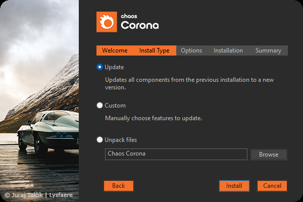

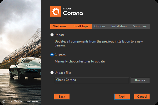

Install Type
Typical – This is the fastest, fully automated installation type. It is recommended for most users. This mode installs Corona plugins for all software versions detected, plus the Corona Image Editor (GUI and Command Line versions) and the Corona Distributed Rendering server.
If you already have an older version of Corona installed on your system, this mode is renamed to Update
When installing Corona 8 or newer, you may see this option grayed out and with a short explanation instructing you to use the Custom installation mode instead. For more information, see the Basic Information on Corona and the Chaos License Server article.
Click Install to proceed.
CustomThis is an advanced installation method that allows you to choose the specific items to be installed and their locations. Useful, for example, when you have different 3ds Max versions installed, and you want to install Corona for only one of them or if you only want to install certain components (such as the DR ServerChaos LicensingCorona Standalone, or the Corona Image Editor).
Unpack filesThis unpacks all the installer files into a specified directory. Useful for advanced users and debugging. You might opt for this option, for example, when installing the plugins manually, or if there are problems during the installation, e.g., if the installer could not find any host application, then you can unpack the files and copy them manually. For more information on the manual installation of Corona, see: How to install Corona manually?
Click Unpack to proceed.
Options
Custom Install Type
If you select the Custom installation type, after selecting Next, you are presented with the customizable options. Select the version of 3ds Max you wish to have Corona installed in. You can also select the components you wish to include in the installation - Chaos Cosmos Services, Chaos License Server, NVIDIA AI Denoiser, and the Material Library. Also, decide if you need to install the DR Server, Corona Standalone, and the Corona Image Editor, and if so, where you want to install them.

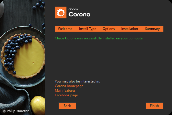

Summary
After a successful installation, you see the following message: Chaos Corona was successfully installed on your computer. Any errors are marked with a red font
Click Finish to enjoy Corona.
