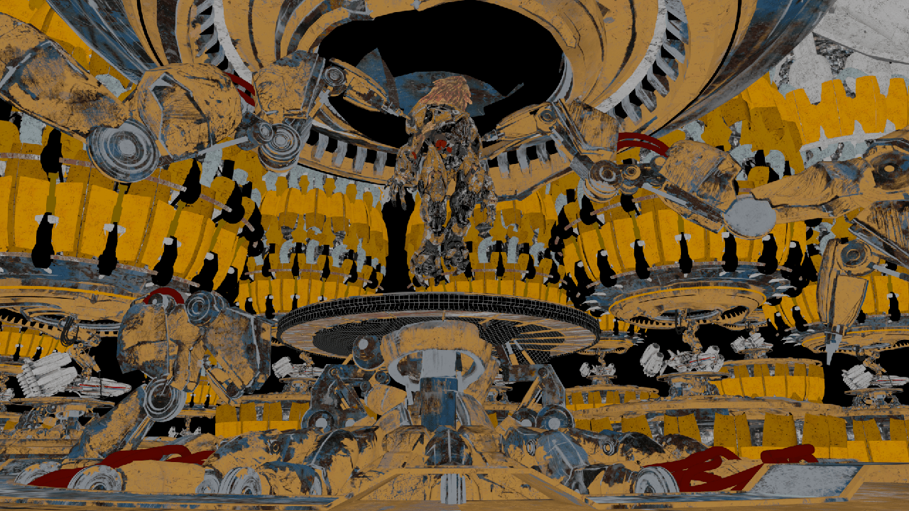

This page describes the Diffuse Render Element and how it is used to have more control of a final composited image.
The Diffuse Render Element shows the colors and textures used in materials, flatly applied to objects with no lighting information. The colors are the actual colors set in the material definition, and each texture appears as it does in the texture (file) itself. There are no highlights or shadows, and any background image is not included. Other render elements that include colors from materials are said to include the diffuse contribution or the diffuse component of the rendered scene. The Diffuse Render Element contributes this diffuse component; any render element that includes this diffuse component is a combination of vrayRE_Diffuse and other render element(s). Note that the Diffuse Filter Render Element is affected by reflection and refraction combined weight. 1  This render element is, by itself, useful for making overall adjustments and enhancements to base colors and textures during compositing without effecting things like reflections and highlights. ||Display Render Settings button|| > Render Elements tab > Diffuse

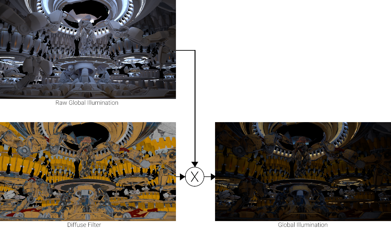

The Diffuse Render Element is useful for changing the appearance of many passes when it is combined with Raw render passes (like Raw GI, Raw Light, etc.). In the example below, the Diffuse is multiplied by the Raw Global Illumination Render Element to provide the Global Illumination pass. In this way, color correction can be performed upon the raw pass without the actual diffuse colors being changed, making it possible to tint a pass in a realistic way without re-rendering.

Underlying Compositing Formulas
vrayRE_Diffuse x vrayRE_RawGI = GI
vrayRE_Diffuse x vrayRE_Raw_Light = Lighting
vrayRE_Diffuse x Raw Shadow = Shadow
