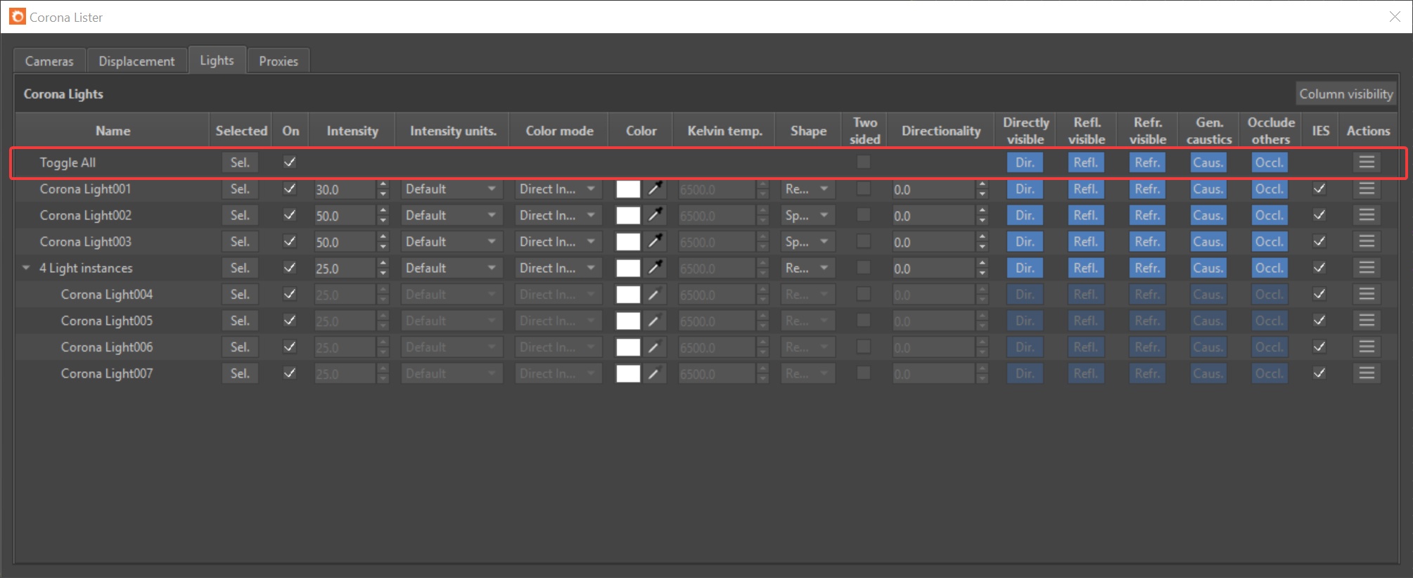

Streamlined Control with "Toggle All"
In this row, you'll find buttons or checkboxes that allow you to make quick changes to all items visible in the lister. Buttons and checkboxes vary depending on the active tab in the Corona Lister. For example, in the “Lights” tab, there is an additional “On” checkbox to enable or disable all Corona lights, and in the “Proxies” tab, there is an additional dropdown “Previz type” button to change the display for all proxies visible in the Corona lister. Similarly, you can use the button in the “Actions” column to apply changes to all visible items in the Corona lister.

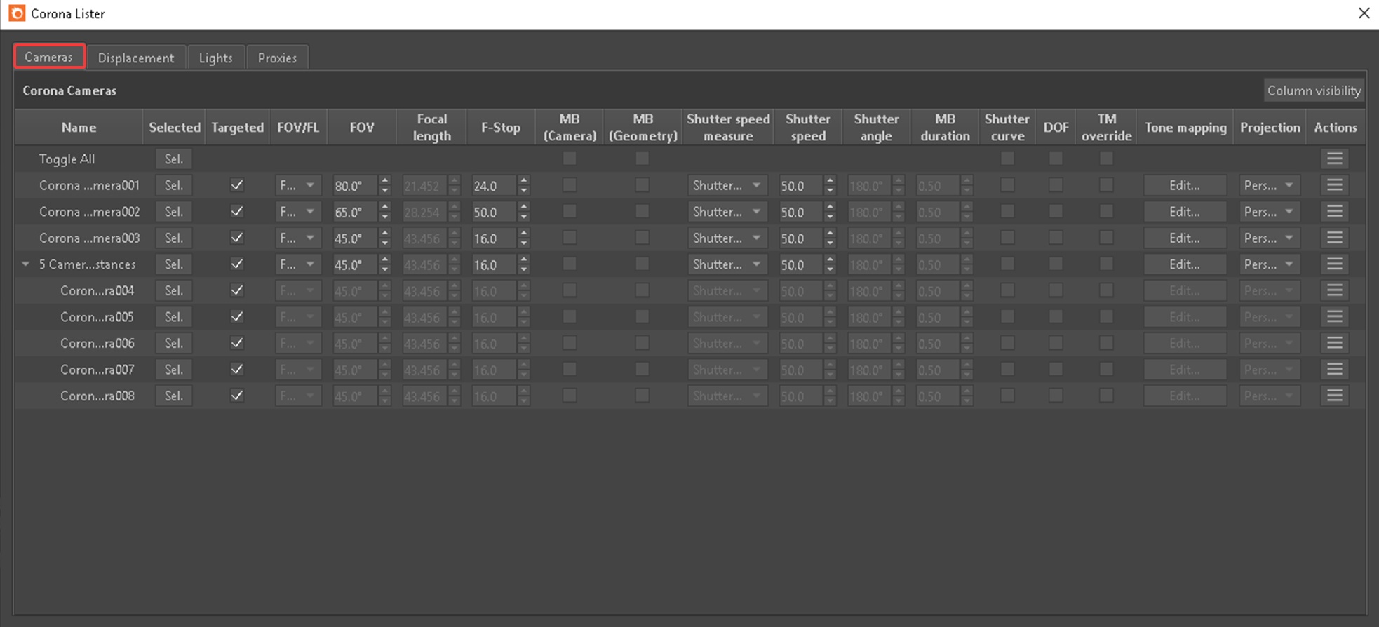

Cameras Tab
Cameras Tab provides a list of all Corona Cameras available in the scene. Here, you can easily access and adjust various camera settings, including tone mapping and projection for each Corona Camera. The Instanced Corona Cameras are organized in a dropdown menu for easy selection. Any modifications made to a specific Corona Camera are automatically applied to all its instances.
Corona Lister showing 'Camera' Tab
Actions available in this tab:
  • Delete: This removes the selected camera.
  • Use in current viewport: This sets the current viewport to the selected camera.
  • Render: This starts an interactive render from the selected camera.
Corona Lister Cameras Tab Actions Button options

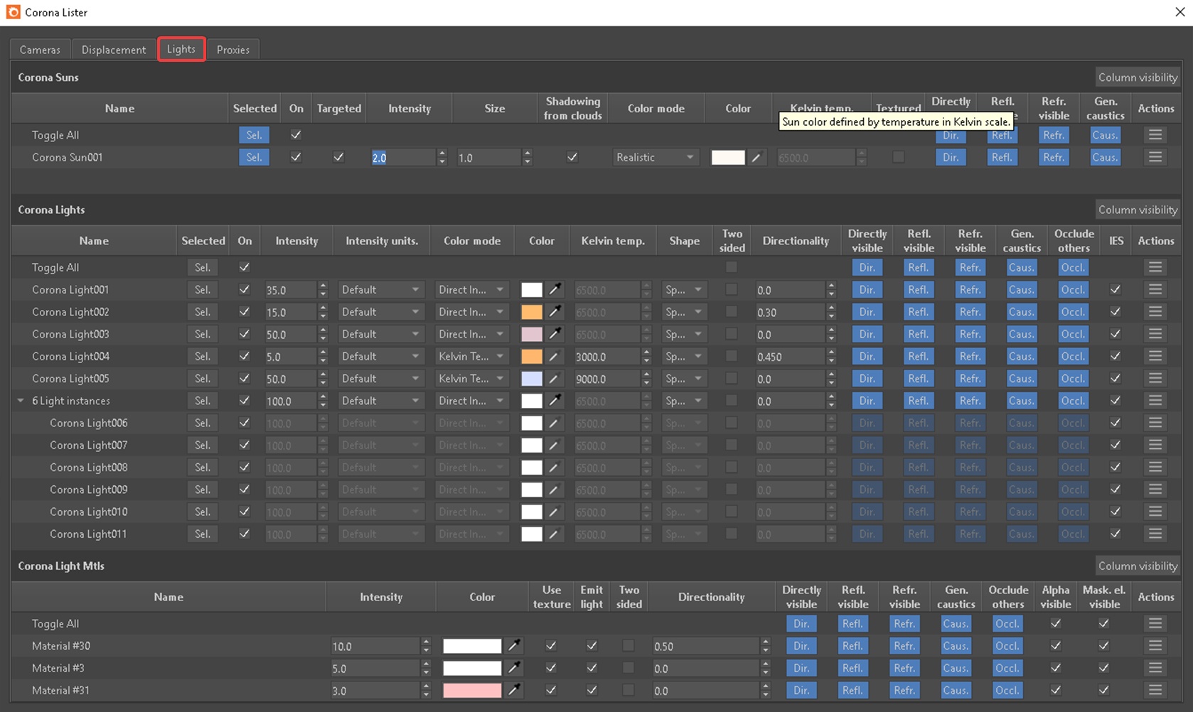

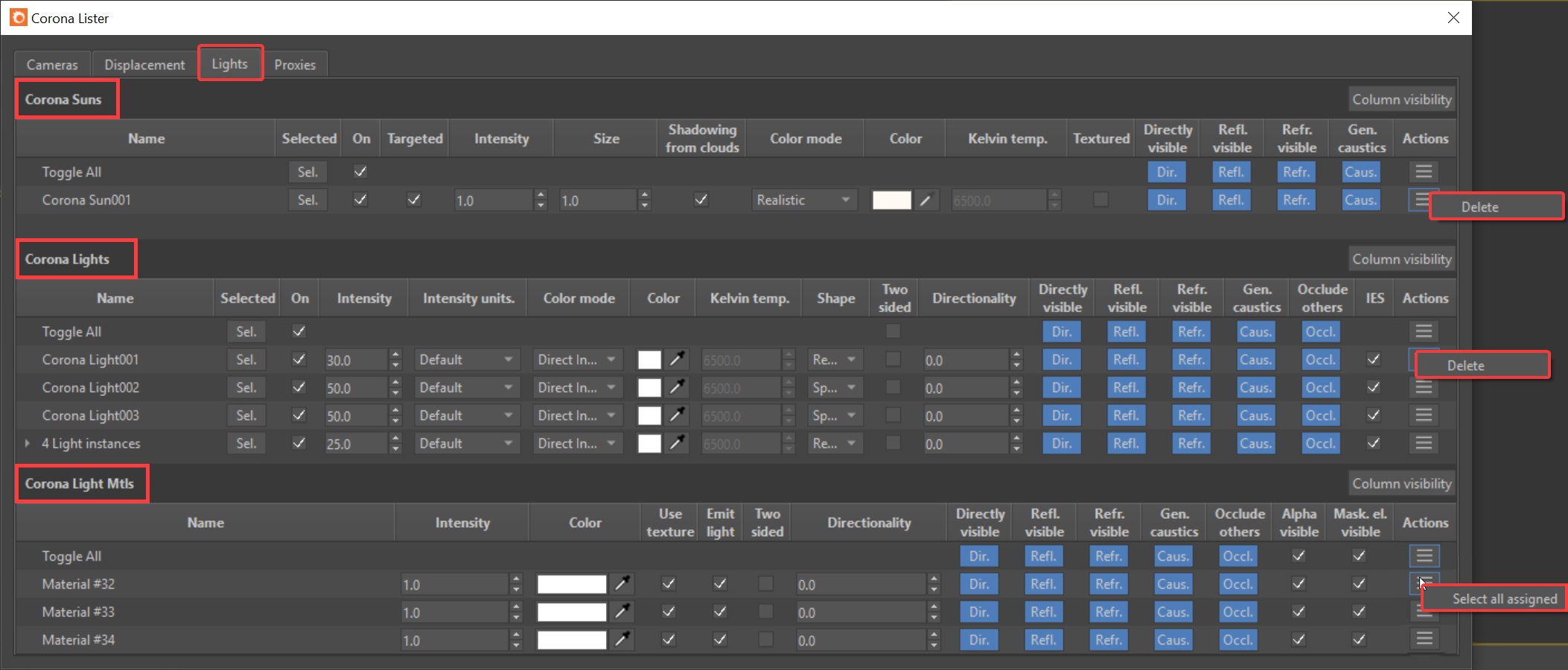

Lights Tab
The lights tab provides a list of all Corona Lights and Corona Light Materials present in the scene. The Instanced Corona Lights are easily organized and can be selected from a dropdown menu. Any modifications made to a specific Corona Light are automatically reflected across all its instances.
Corona Lister showing the 'Lights' tab
  • Delete: This removes the selected Corona Sun or Light.
  • Select all assigned (only for Corona Light Mtls): This selects all objects with the selected Corona Light material.
Corona Lister Lights Tab Actions Button options

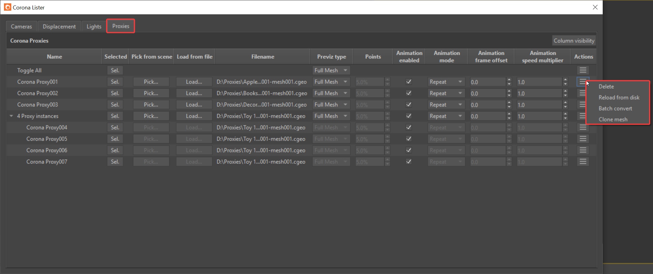

Proxies Tab
The proxies tab provides a list of all Corona Proxies available in the scene. From here, you can access and adjust the major settings for each Corona Proxy. The Instanced Corona Proxies are easily grouped and can be selected from a dropdown menu. Any modifications made to a specific Corona Proxy will be automatically applied to all instances of that proxy.
Corona Lister showing the 'Proxies' tab
  • Delete: This removes the selected Corona proxy.
  • Reload from disk: This updates the proxy from the proxy file in the scene.
  • Batch convert: Converts all proxies in a chosen directory and its subdirectories to the latest Corona format (.cgeo). Original proxy files are preserved.
  • Clone mesh: This will copy the mesh from the proxy file to a new object in the same location.
Corona Lister Proxy Tab Actions Button options

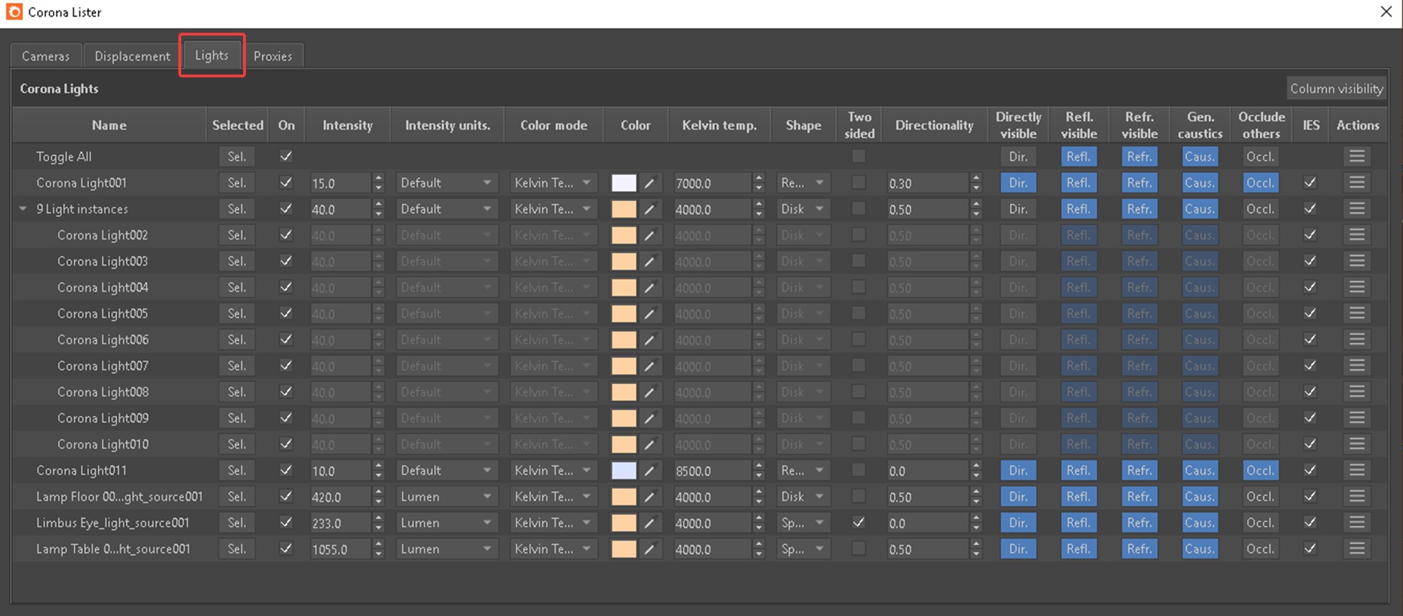

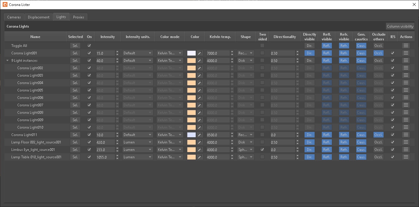

In this example, we are using a simple interior scene with several Corona lights. The ceiling lights have been instanced and grouped together in the Corona Lister. To change and affect all the values of instanced lights, simply change the parameter of a single light. The side rectangle lights and floor lamp lights are listed separately in the Corona Lister because they are unique and must be adjusted individually to achieve the desired lighting effect. Also, there are multiple Corona Cameras in the scene which are listed in the Corona Lister. All settings can be quickly changed and managed using the Corona Lister.
Scene Setup
A scene with multiple Corona Lights.
Corona Lister - Lights Tab
The Corona Lister can be used to manage multiple Corona Lights in the scene.
Scene Setup
A scene with multiple Corona Cameras.
Corona Lister - Cameras Tab
The Corona Lister can be used to manage multiple Corona Cameras in the scene.
