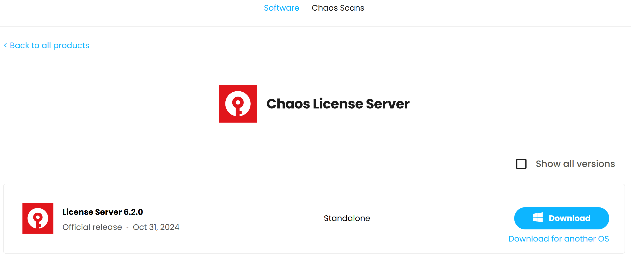

Download the Installer
Download the Chaos License Server installer from the Downloads section of the Chaos website. Log in to access it. Download the latest version of the License Server and open the file.
Download the License Server

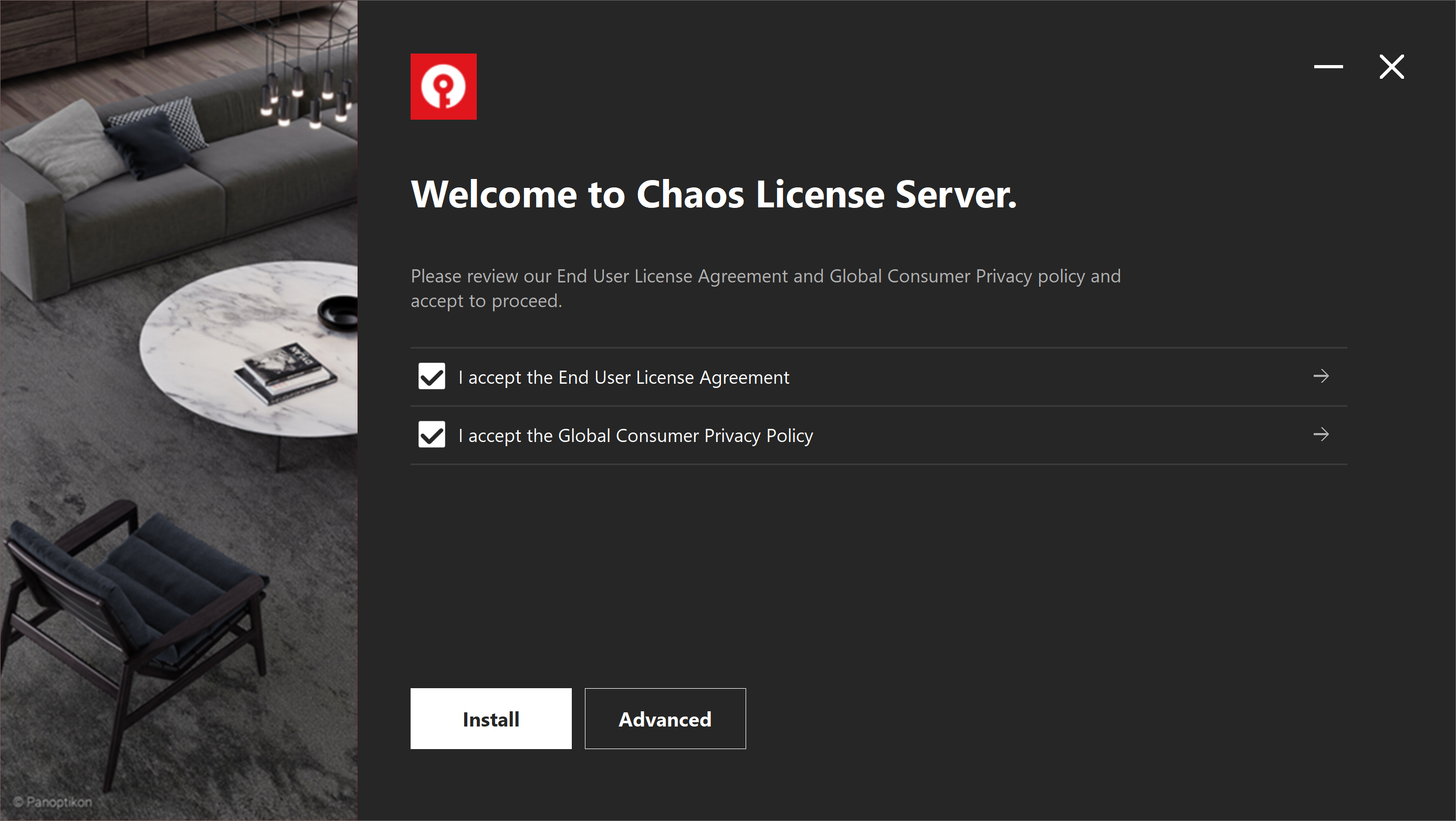

Run The Installer and Accept the EULA
On the Linux OS, please use your local user with the sudo command instead of the root user to run the installer.
Read carefully and accept the End User License Agreement and the Global Consumer Privacy Policy.
Then, click on the Install button. If you want to modify the installation, click on the Advanced button.

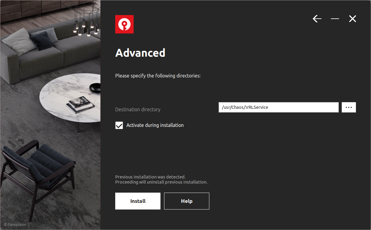

Advanced options
The Advanced installation provides the following additional options:
Destination directory – Allows you to enter a custom license server install directory.
Add firewall exception – Enabling this option allows the default licensing port (TCP 30304) in the firewall. If you disable it at this step, you will need to manually add firewall exceptions later.
Once you are happy with your setup, click Install to begin the installation. The Help button takes you to this documentation.
Windows Default Install path - C:\Program Files\Chaos\VRLService
Linux Default Install path - /usr/Chaos/VRLService
macOS Default Install path - /Applications/Chaos/VRLService

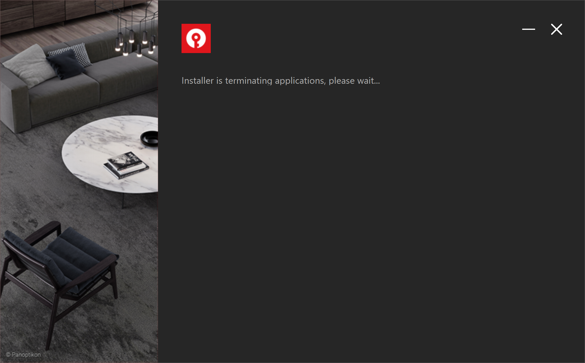

If any applications associated with the License Server are open, the installation wizard will close them before attempting installation. Please wait patiently for this process to complete; it might take a few minutes.
After that, the wizard completes the installation. Click Finish.

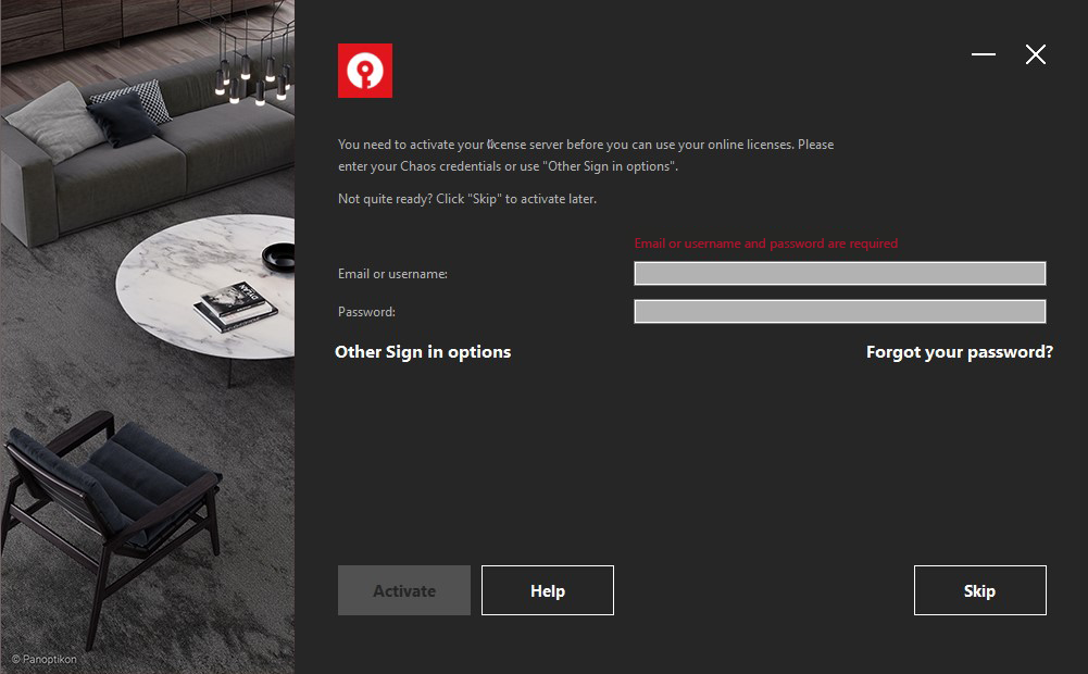

The wizard will automatically prompt you to activate. Enter your Chaos credentials. In case you have forgotten your password, click on the Forgot your password? link and it redirects you to a webpage where you can create a new password. The Other Sign in options link redirects you to the Chaos login page, where you can log in using a Google account, a Trimble account, or a corporate email.
If you don't want to activate the license right now, you can click Skip and activate it through your browser later. Keep in mind that you cannot access Chaos products without an active license.

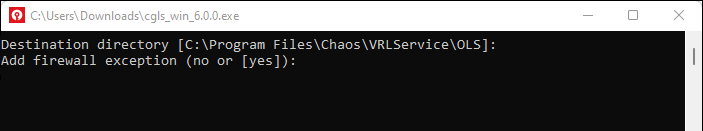

If you want to specify a custom installation directory or choose not to add firewall exceptions, run the installer with the following command:
cgls_win_6.0.0.exe -gui=0 -quiet=1
The -quiet=1 argument automatically accepts the EULA. You can then select an installation directory and choose whether to include firewall exceptions.
