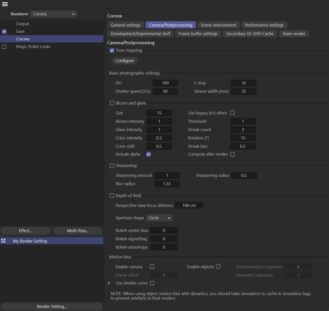

This page provides information about the Camera/Postprocessing tab in the Render settings window.
The Camera/Postprocessing tab includes the settings that affect the rendered image.
UI Path: ||Render settings window|| > Corona > Camera/Postprocessing tab

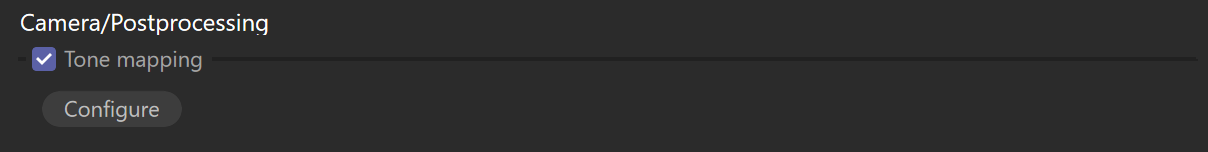

Tone mapping
Configure – Launches the tone mapping settings dialog. The available tone mapping controllers are:
Contrast
Green-Magenta Tint
Photographic Exposure
Saturation
Simple Exposure
Tint
Vignette
White balance
Advanced Filmic Mapping
Curves
Filmic Mapping
Tone Curve
Reinhard Highlight Compression
ACES Output Transform
LUT

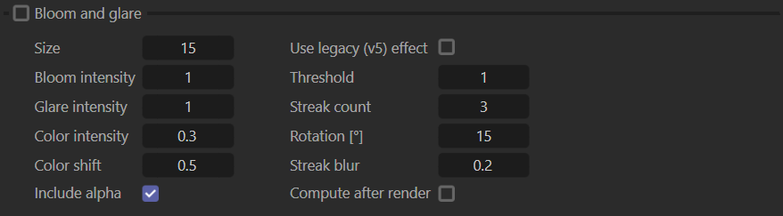

Bloom and glare
Size – This is the size of bloom and glare effect in the percentage of render size.
Bloom intensity – Linear scaling of the bloom effect (large, soft glow around bright areas); values greater than 0.0 enable the effect.
Glare intensity – Linear scaling of the glare effect (more focused glow with streaks); values greater than 0.0 enable the effect.
Color intensity – Adds color variation to the glare effect for additional artistic control.
Color shift – Alternates the colors created by the Color intensity option.
Include alphaIf enabled, the Bloom and Glare effect also processes the alpha channel.
Use legacy (v5) effect – Reproduces the bloom and glare behavior from a previous version.
Threshold – Only pixels brighter than this threshold are affected by bloom and glare. Increase this value to make the effect more localized around the brightest light sources only.
Streak count – Sets the number of streaks in the glare effect.
Rotation [°] – Alters the rotation of the glare effect.
Streak blur – Controls blurring of all streaks in the glare effect. A value equal to 0.0 results in very sharp streaks, while a value equal to 1.0 leads to over-blurred streaks.
Compute after renderIf enabled, the Bloom and Glare effect is computed at the end of the rendering process, instead of during the whole rendering.

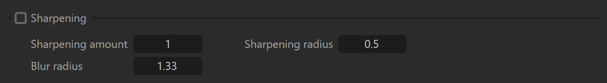

Sharpening
Sharpening amount – Applies sharpening to the image. Increasing this amount leads to a sharper image, while setting the amount to zero switches off this filter.
Blur radius – Sets the pixel radius used during blurring. Higher values lead to a greater blurring effect.
Sharpening radius – Sets the pixel radius used during sharpening. Higher values lead to more extensive sharpening.
All sharpening/blurring controls can be interactively changed during/after rendering in the VFB window.

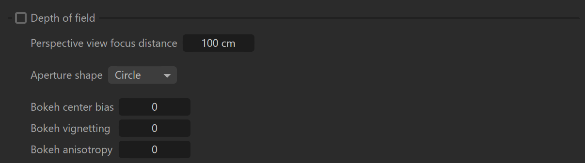

Depth of field
Perspective view focus distance – Determines the focal point distance measured from the camera to the end of the camera's frustum (a.k.a. camera's cone).
Aperture shape – Sets the aperture shape that influences the out-of-focus blur called bokeh. The options are:
Circular – Uses a circular aperture.
Bladed The result is a polygonal aperture with a given number of sides (blades).
Custom Uses a custom aperture shape defined by a shader or a texture map.
Bokeh center bias – Introduces an offset for the bokeh effect. Values between -5 and 5 can be used here.
Bokeh vignetting – Introduces a vignette around the bokeh effect. Values between -3 and 3 can be used here.
Bokeh anisotropy – Deforms the bokeh effect. Depending on the value used, it can be deformed on one axis or another. For this option, values between -0.999 and 0.999 can be used.

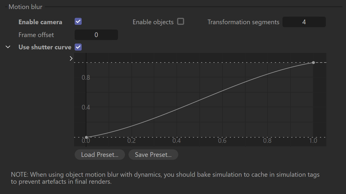

Motion blur
Enable camera – Enables motion blur due to camera movement. For a complete motion blur solution, you need to enable objects motion blur as well.
Enable objects – Enables motion blur due to the movement of scene geometry. For a complete motion blur solution, you need to enable camera motion blur as well.
Transformation segments – Quality of the non-linear rigid (transformation) motion blur. Increasing this value increases the quality at the expense of some rendering speed and memory usage. Setting this value too low can result in movement stutter and/or artifacts.
Frame Offset – Offsets the time interval from which the motion blur effect is generated. The value is defined in frames, with 0 meaning that the center of the interval is exactly in the current frame, -1 meaning that the entire interval happens just before the current frame, and 1 meaning the entire interval happens just after the current frame.
When using object motion blur with dynamics, the simulation should be cached to prevent artifacts in the final render.
Use shutter curve – When enabled, the shutter curve allows fine-tuning the movement and look of how the motion blur results will appear in the rendered image. This simulates how fast or slow the shutter opens for each frame and enforces a good sense of motion on your subject.
To learn more about it, see also: Camera Motion Blur Shutter Curve
Video: Motion Blur Shutter Curve Examples
