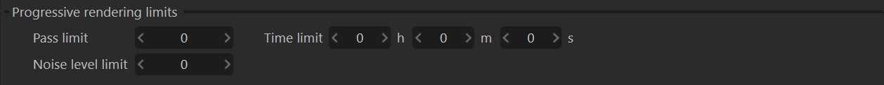

Progressive rendering limits
Pass limit – Number of passes after which the rendering stops.
Time limit – The time after which the rendering stops (hours, minutes, seconds).
Noise level limit – Sets the target error (noise level) at which the rendering stops.
Setting any of the rendering limits to 0 disables that limit. If all rendering limits are set to 0, the image renders infinitely until you stop it.
If you enable more than one rendering limit at a time, the rendering stops once any of those limits are reached. For example, when using a pass limit of 100 and a time limit of 1 minute, the rendering stops either after 100 passes or after 1 minute, depending on which of those limits is reached first.

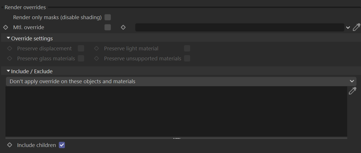

Render overrides
Render only masks (disable shading) – Enables rendering for mask passes only and skips rendering of beauty-dependent passes. This is useful for quickly rendering masks without the need to spend time on other passes.
Mtl. override – Enables the override material that will be applied to all scene objects. This is useful for creating "clay renders" (usually for debugging problematic scenes).
Override settings – The following options allow you to discard the overriding material for the given material's característics.
Preserve displacement – Avoids the overriding of materials using the displacement channel.
Preserve glass materials – Avoids the overriding of materials using the refraction channel.
Preserve light materialAvoids the overriding of Corona Light materials that are being used in the scene.
Preserve unsupported materials – Avoids the overriding of unsupported materials in the scene.
Include/Exclude – This list allows you to include or exclude objects from being affected by the material override option depending on the include/exclude selected method.
Available include/exclude options are:
Apply override only on these objects and materials – Applies the overriding material only to the objects in the list.
Don't apply override on these objects and materials – Prevents the overriding material from being used in the objects from the list.
Include children – Considers nested objects (children objects) for the include/exclude list. This way, there's no need to define every single object, only the grouping objects.

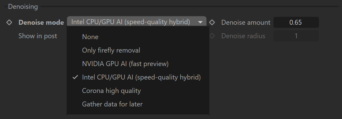

Denoising
The following options specify the post-render image denoising. If enabled, the beauty element is replaced with its denoised version after rendering. You can then use the Denoise Amount option to interactively control the effect's strength. The following denoising modes are available:
None – This mode disables any kind of denoising.
Only firefly removal – This mode is a fast filter that just removes very bright pixels from the image (created by any source like noise, caustics, sun reflections, etc.).
NVIDIA GPU AI (fast preview) – This option is a very fast denoiser that also denoises the image during rendering, not just at the end. Not suitable for denoising animations. Available only on NVIDIA GPUs when the optional NVIDIA AI Denoiser Corona component has been installed.
Intel CPU/GPU AI (speed-quality hybrid) – This mode is also known as Intel Open Image Denoise – Fast denoising filter and it's applied when render ends. It is a CPU-based denoiser, running on both the Intel and AMD CPUs. It does not have any additional requirements to be executed; if your CPU runs Corona, it can run this denoiser. It is slower than NVIDIA GPU AI denoiser but can achieve better quality.
In Corona 11, the Intel AI denoiser is supported only by Windows-based systems, and its GPU mode only works on NVIDIA GPUs.
Corona high quality – This mode is a more memory and CPU-intensive filter available exclusively in Corona. It takes the longest to compute but produces the best denoising quality of all integrated denoisers.
Gather data for later – This mode just gathers denoising data for later processing via the Corona Image Editor.
When using this mode, the image must be saved as a Corona EXR (.cxr) to use the gathered data.
Show in post – Displays the denoised image in the Corona VFB.
Denoise amount – This option is a mixing coefficient between the original (noisy) and processed (non-noisy) image. It allows fine-tuning the effect strength to find the sweet spot between preserving the finest details and removing excessive noise. This parameter can be changed interactively after rendering.
Denoise radius – Controls the blurring radius of the Corona High-Quality denoiser. Increasing the value can prevent splotches when denoising extremely noisy images, and lowering it can prevent loss of details, but the default value usually works best. This parameter must be set before rendering - it cannot be changed interactively after rendering like the Denoise amount.
