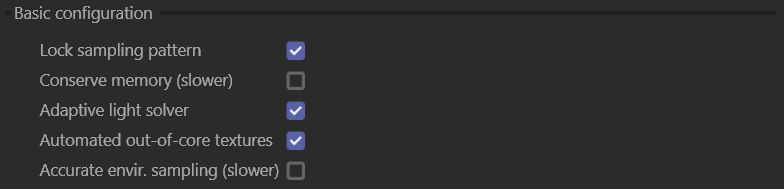

Basic configuration
Lock sampling pattern – When enabled, the noise is 'locked' in place, both in still frames and animations, making it less visible. Disabling this option produces a completely different noise pattern for each frame, which is required by some third-party de-noising applications (but not by the Corona denoiser). When rendering using Distributed Rendering or a render farm service, the noise might be different from frame to frame regardless of this option.
Conserve memory (slower) – When enabled, Corona consumes less memory at the cost of rendering performance. This option can decrease peak memory usage by up to 30%. Consider turning this on if you are running out of memory during rendering.
Adaptive light solver – Toggles an improved method of rendering lights. This algorithm can speed up your renders by learning which scene lights are important at a particular location. Those lights then receive more rays than the others, resulting in a lower noise level. Enabling this option may significantly reduce render times, especially in scenes:
  • With many lights (e.g. 10 or more)
  • Where lights have complex shapes
  • With complex lighting scenarios (e.g. if the lights are occluded by some objects, blocking the path from the light source to the camera)
It may sometimes appear that the adaptive light solver produces brighter images, however:
The difference in brightness should disappear after a longer render time (the image with the adaptive solver enabled will simply converge to the correct result faster than the one with the adaptive solver disabled).
The results produced with the adaptive solver enabled are always less biased (more realistic) than with the adaptive solver disabled.
Automated out–of–core textures – When enabled, Corona automatically offloads unused parts of textures to HDD to consume less memory. Additional settings are located in the Corona Preferences window.
Accurate envir. sampling (slower)This option enables accurate sampling of environment maps. It is slower but more accurate for high detail maps. This can make lighting and shadows from environment maps sharper, specifically for small light sources(s) in the map (e.g. the sun). Enable it if there is flickering in the lighting.

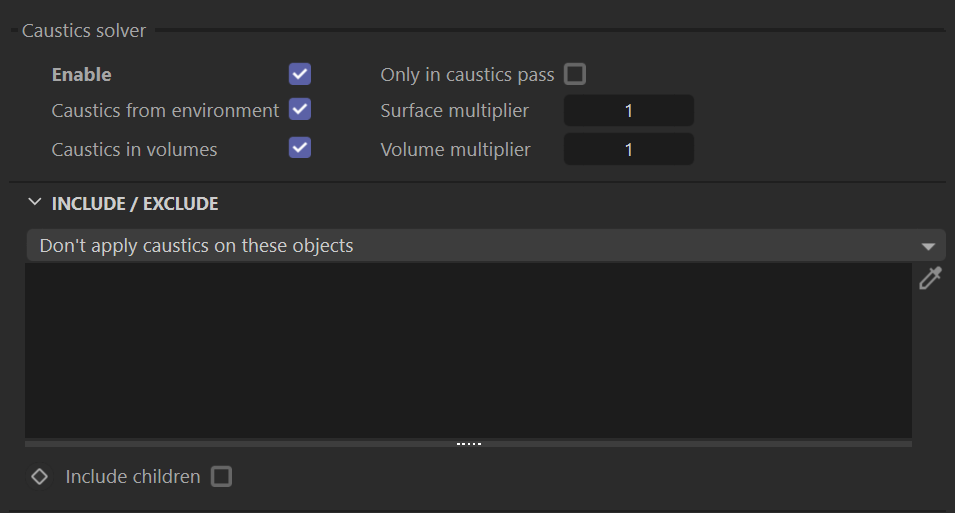

Fast Caustics Solver
Enable – Generates physically correct caustics at the cost of lower rendering performance. Note that to render refractive caustics, you need to enable them in the Corona Material (either if it's a legacy or physical material).
Caustics from environment – When enabled, the caustics solver generates caustics from the scene environment lighting. This option does not influence caustics generation by the sun.
Caustics in volumes – If set to true, the Caustic solver will be used to compute caustics in volumes.
Only in caustics pass – When enabled, caustics are rendered only in a special Caustics multi-pass. When disabled, caustics also appear in beauty, light select, and all other applicable multi-pass elements.
Surface multiplier – Multiplies the intensity of caustics on surfaces. Changing the default value of 1 leads to inaccurate (darker/brighter) surface caustics rendering.
Volume multiplier – Multiplies the intensity of caustics in volumes. Changing the default value of 1 leads to inaccurate (darker/brighter) surface caustics rendering.
Include/Exclude – These options allow you to include or exclude specific objects from being affected by caustics.
Available Include/exclude modes:
Apply caustics only on these objects – Using this mode, caustics are only visible in the defined objects from the list.
Don't apply caustics on these objectsUsing this mode, caustics are not visible in the defined objects from the list.

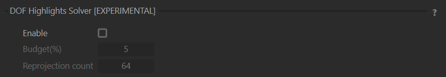

DOF Highlights Solver
Enable – Enables the DOF Highlights Solver that improves the speed of rendering of out-of-focus objects (at the cost of casting more rays).
Budget (%) – Increasing this value improves the rendering of out-of-focus objects, but it leads to slower rendering of all other effects.
Reprojection count – For debugging purposes only. When a highlight blurred by depth of field is found, it is projected back to the image. This number changes how many times the highlight is projected back.
To learn more about the DOF Highlights Solver, see: How to enable and control Depth of Field at the Chaos Help Center
