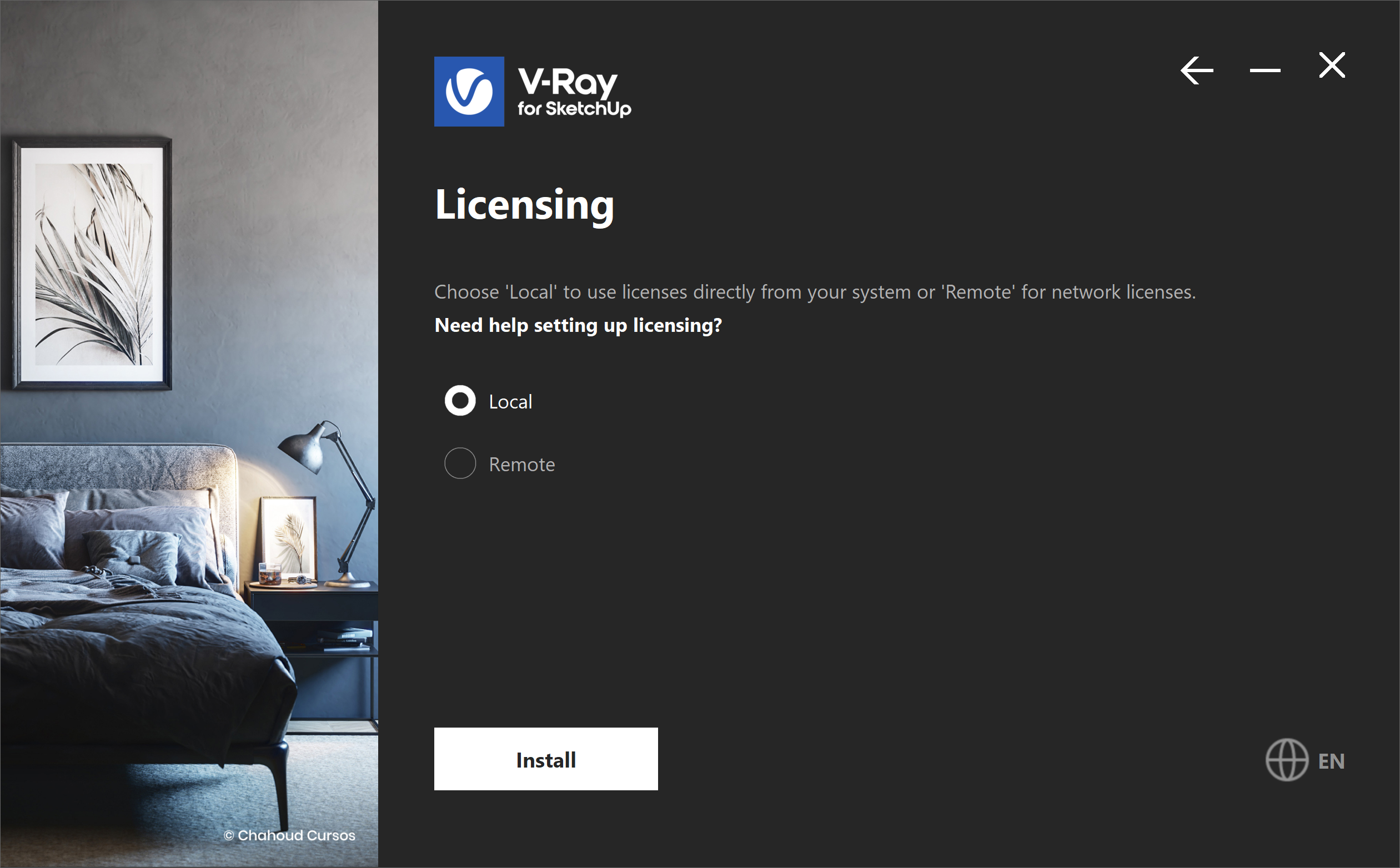

Licensing
In this step, you can specify whether the Chaos License Server runs locally or on another machine.
Local – This option installs the License Server on your machine. For a walkthrough, see the Chaos License Quick Start Guide.
Remote – This option allows you to configure your Chaos product for floating licenses in a local network. Fill in the IP address of the Chaos License Server in your network in the Primary License Server field. Please leave the port 30304 unchanged. For more details on this setup, see the License Server Deployment page.
