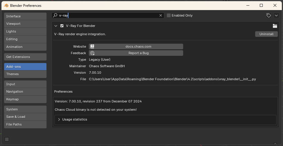

  • Open Blender and go to Edit > Preferences.
  • Go to the Add-ons tab, and search for V-Ray. Make sure to turn off the Enabled Only option.
  • Enable the V-Ray For Blender plugin.

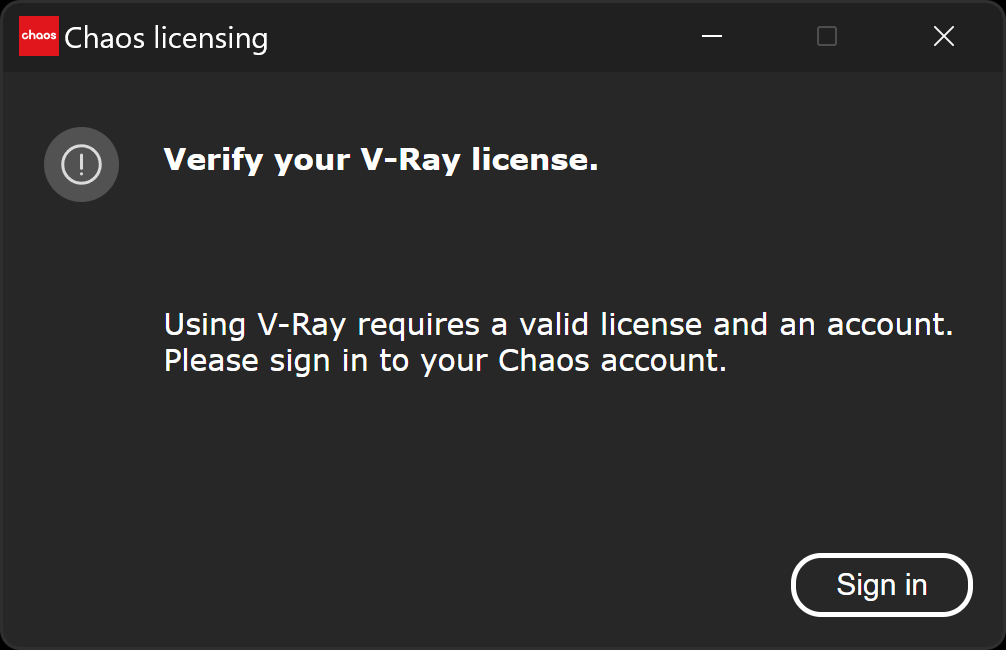

V-Ray may prompt you to sign in with your Chaos account, if needed.
Select Sign in from this dialog.

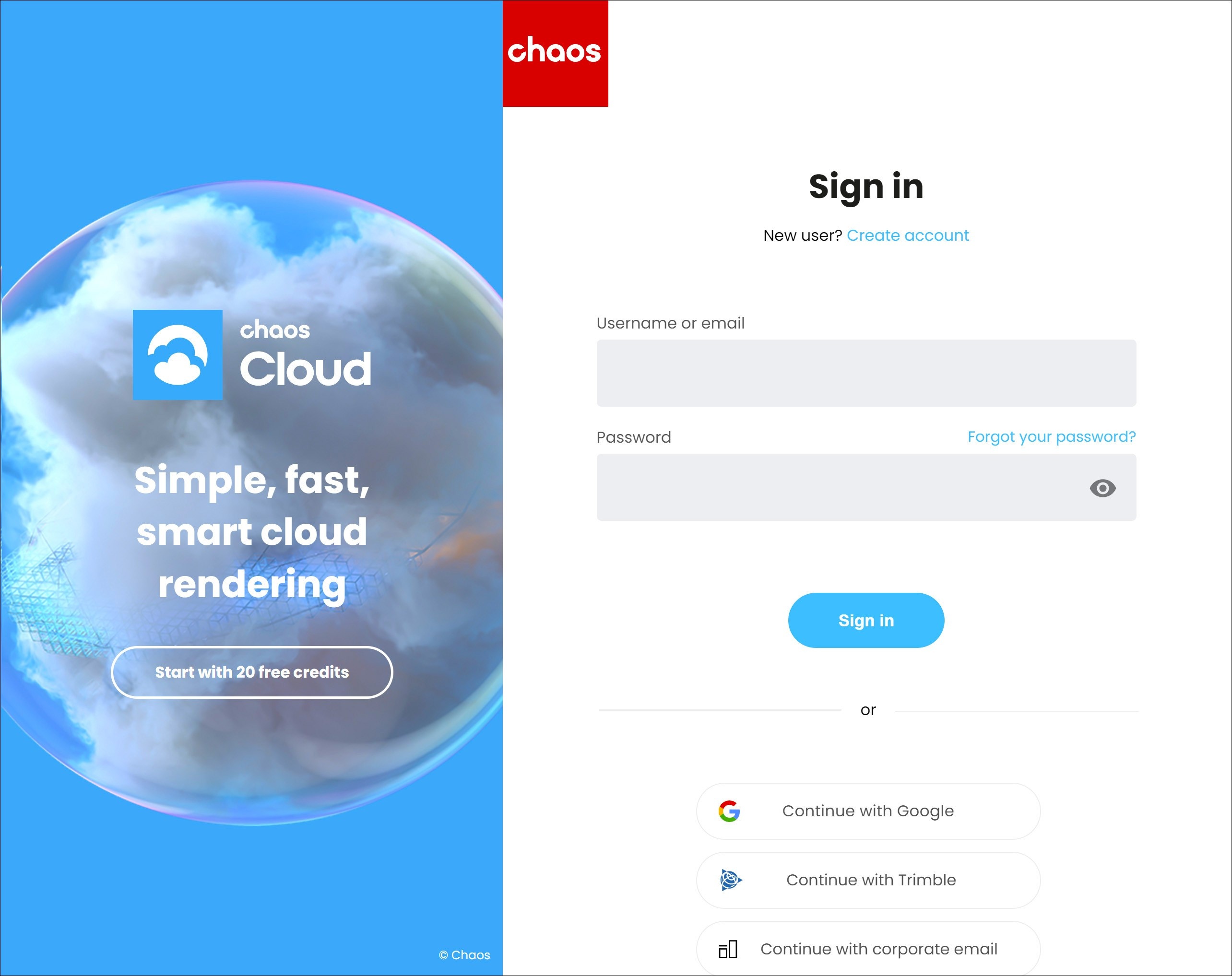

  • Enter your Chaos credentials.
You can use your Chaos account credentials.
Your existing Enscape, V-Ray, Corona, Anima or Veras logins are all Chaos accounts and work for all our products.
If you have never had a Chaos account, you can create one at this step.

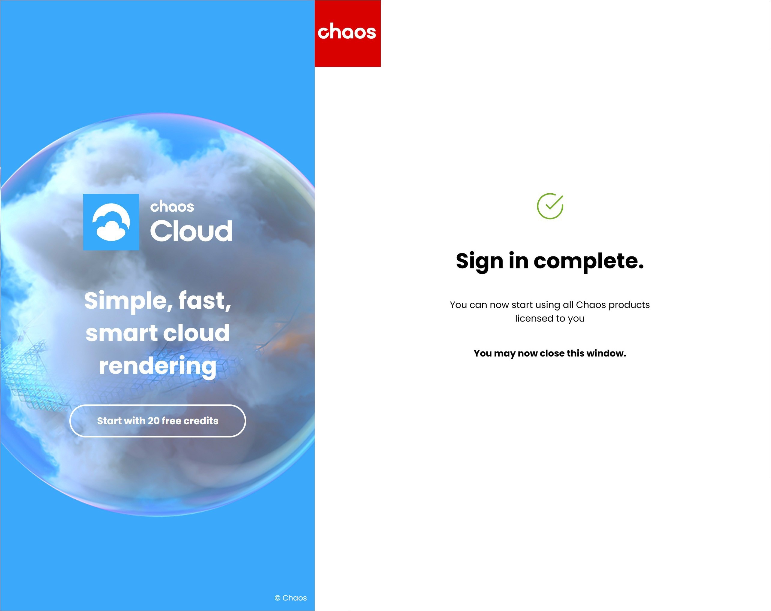

You can close the login page after seeing the confirmation for a successful login.
You can now start using your Chaos product.

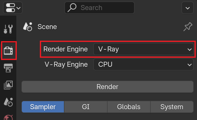

Set V-Ray as the current renderer
To render with V-Ray, select V-Ray as the Render Engine from the Render Properties.
