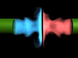

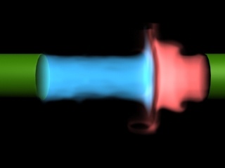

Example: Uniform Density Parameter
How does density affect the simulation from the non-physical point of view? In this example, we have two jets of gases: a cold one and a hot one. When directed into a collision course, the cold jet will prevail over the hot jet due to its higher density.
Uniform Density - On
Uniform Density - Off

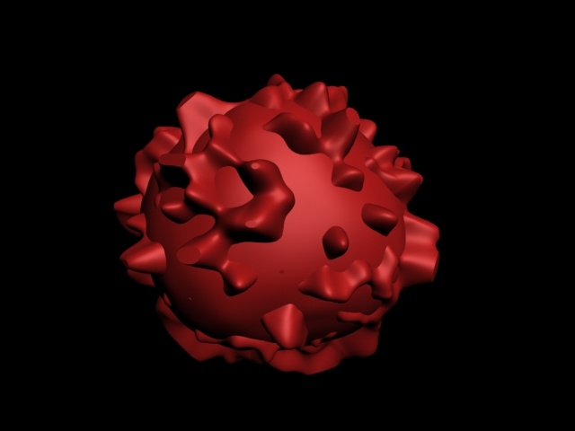

Surface Driven vs. Volumetric Displacement
Displacement in Phoenix works by shifting the point of sampling with an offset, the direction of which is determined by the gradient of the effects channel while the distance is determined by the brightness of a given map. There are two different modes used to sample the aforementioned map, switched by a checkbox in the rendering rollout. If the checkbox is NOT checked, the map is sampled at the point of shading, and we call this "volumetric displacement". If the checkbox is checked, the coordinates are first projected over the surface as determined by the effects channel. The point of projection is then used as map coordinates. We call this "surface driven displacement." Surface driven displacement is slower and requires some initial calculations, but it keeps the topology of the isosurfaces. Volumetric displacement is faster, but tends to produce island-like formations if the displacement value is too big. Beside performance, volumetric displacement has one more important advantage: it does not require the distinct surface of the effects channel. Therefore, it will work fine in scenes where surface-driven displacement produces flickering.
Example: Surface Driven vs Volumetric Displacement
Volumetric displacement.
Note the small islands floating above the original surface.

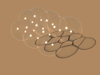

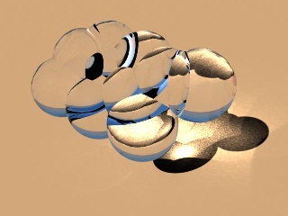

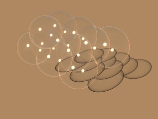

The Particle Shader node can render the particle systems in several different ways - as separate bubbles/droplets, as points, as mist, or as fog. In fog mode, the bounding box of all particles is calculated and a grid based shader is constructed using the bounding box and the fog resolution parameter. This mode is most suitable for surface foams, when the grid height is relatively large and the particle count is huge. The other mode (particle-based shading) is more complicated and interesting; it allows us to achieve a larger variety of effects. One reasonable question about this mode is why we need it, when one can render each particle as geometry with the proper material instead. There are several advantages, but the most important one is the ability to convert the scattering into diffuse color, which gives the natural bright appearance of the foam and the splashes. Another important advantage is cellular mode, which allows shading of close-up foam.
There are three different modes of shading for spherical particles - bubbles, cellular, and splashes. In each mode, a particle is represented as a sphere with a radius equal to its size and with certain optical properties. The "bubble" and "cellular" modes are intended for foam rendering and have the same optical properties of the surface. They differ in the geometry representation only - bubble mode uses simple spheres, whereas cellular mode builds polyhedron-like cells, similar to real foam. The cell walls are not flat, but slightly curved, which provides a more realistic appearance.
Example: Rendering of Foam and Splashes
Bubble mode
Cellular mode
Splashes mode
