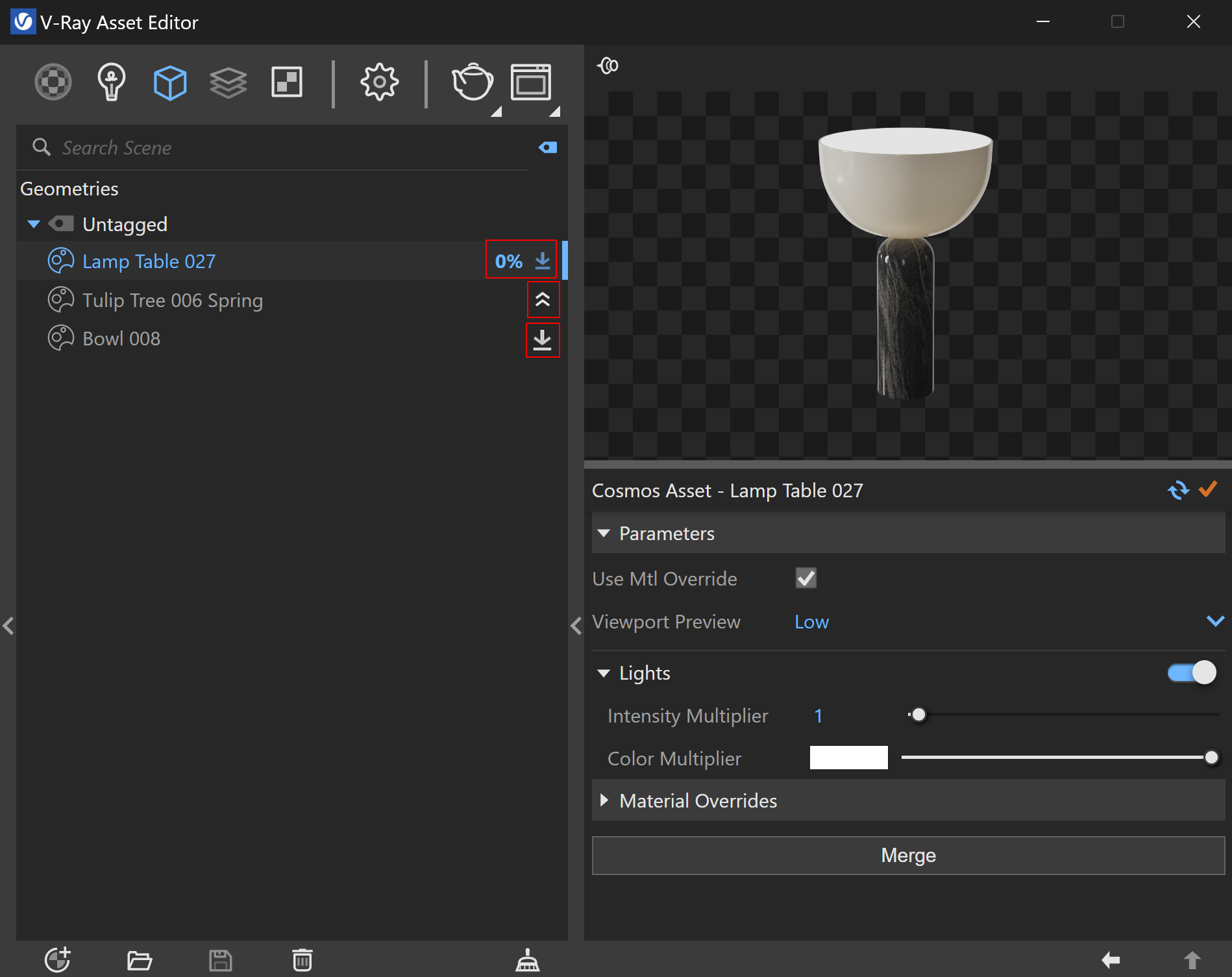

Downloaded Cosmos assets are listed in the Asset Editor under the Geometry section. They can be identified by the Cosmos icon. They can be renamed, deleted, used as replacements, moved, and merged.
The Use as replacement/Replace in scene option is possible only for other Cosmos Assets. It replaces all scene instances of the asset. The replaced asset is not deleted and is stored in the Asset Editor.
Use Mtl Override - When enabled, the global Material Override option in the Render Settings overrides the asset. When disabled, the asset in the referenced scene is not affected by the Material Override option in the Render Settings.

Updates
Cosmos assets with newer versions on the server have an "update" button in the Asset Editor. Press the update button () to start the update.
Note that the update can change the appearance of the object and the rendered result.
If the asset files are missing, a Download button () is present.
The download progress is present next to the button ().
If the asset has more than one version, the Download button downloads the original version and the update button - the newest one.
