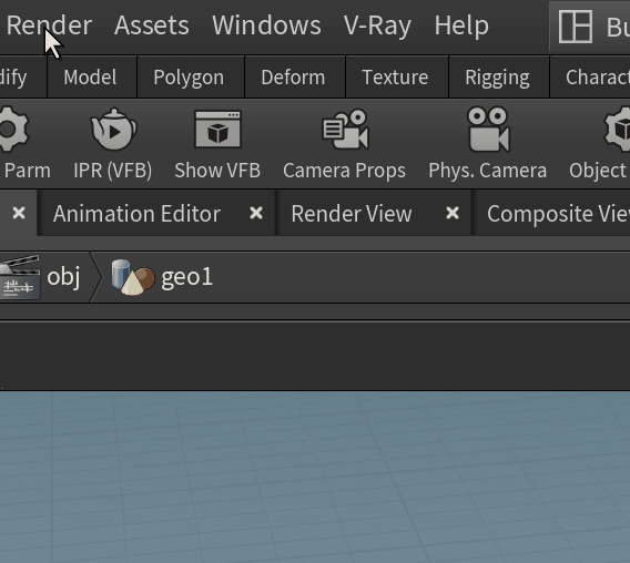

This page provides information on how V-Ray options are integrated into the Houdini menus.

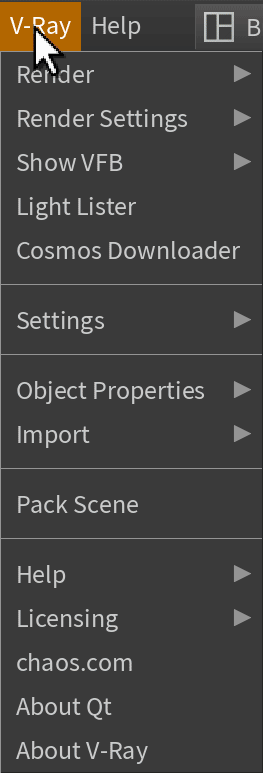

V-Ray adds a number of commonly used V-Ray components to Houdini's main menu. From these options, you can manage Render, Object, and Displacement properties; import files; and manage VFB and V-Ray IPR.

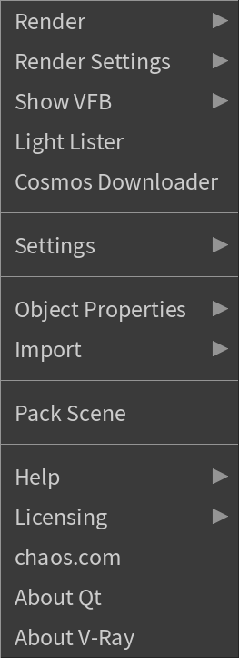

V-Ray menu
Render menu
V-Ray Menu
Menu | Description |
Render | Selects a V-Ray ROP from a dropdown menu and starts rendering. |
Render Settings | Selects a V-Ray ROP from a dropdown menu and opens its V-Ray Render Settings. |
Show VFB | Opens the V-Ray Frame Buffer. |
Light Lister | Opens the V-Ray Light Lister dialog. |
Cosmos Downloader | Opens the V-Ray Cosmos Downloader. |
Settings | Opens the Settings submenu. |
Object Properties | Opens the Object Properties submenu. |
Import | Opens the Import submenu. |
Pack Scene | Opens the Report Bug/RFE dialog. |
Opens Chaos website. | |
Help | Opens the Help submenu. |
About QT | Opens the About QT window. |
Licensing | Opens the Licensing submenu. |
About V-Ray | Opens the About V-Ray window. |

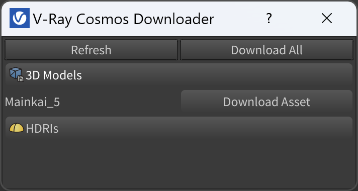

If you open a scene that contains Cosmos assets which are no longer present on the local machine, you can download them from the V-Ray Cosmos Downloader.
The V-Ray Cosmos Downloader is now supported in Houdini under Mac OS, starting with Houdini version 20.0.506. Cosmos Mac OS support for the ARM architecture is planned for the future but currently not available.

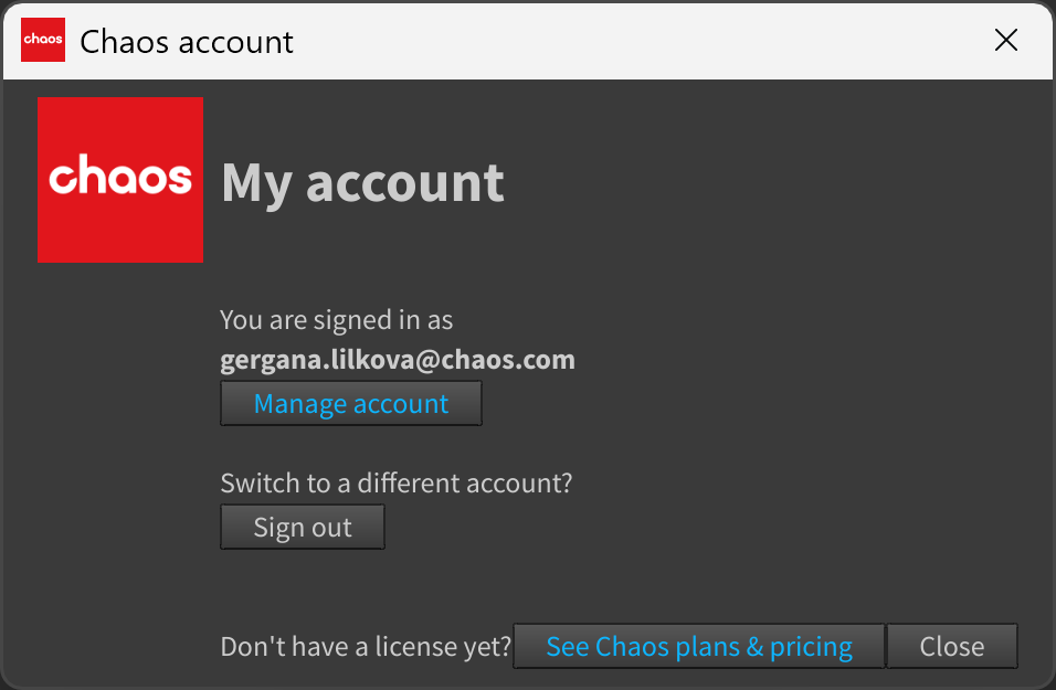

Chaos Account Window
The Chaos account window, accessible from V-Ray > Licensing > Chaos account in Houdini, shows you which account is used currently as a license holder.
Press the Manage account button to open My Chaos portal and manage the licenses. You can assign, remove, allocate licenses to different users. For more information, see the My Chaos Portal Guide page.
To switch the current account, press the Sing out button.

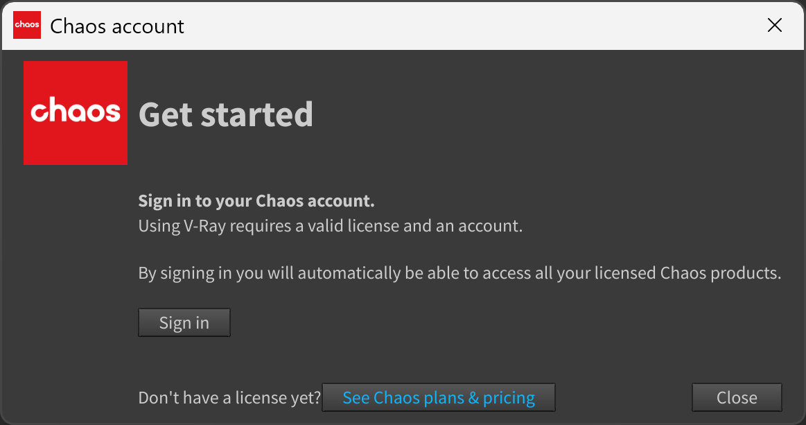

If you haven't signed in during the installation, you can do so in this window:
See Chaos plans & pricing link leads you to V-Ray's pricing list on Chaos website.
This window blocks all the rest of the UI, so make sure to close it once done to go back to V-Ray for Houdini.

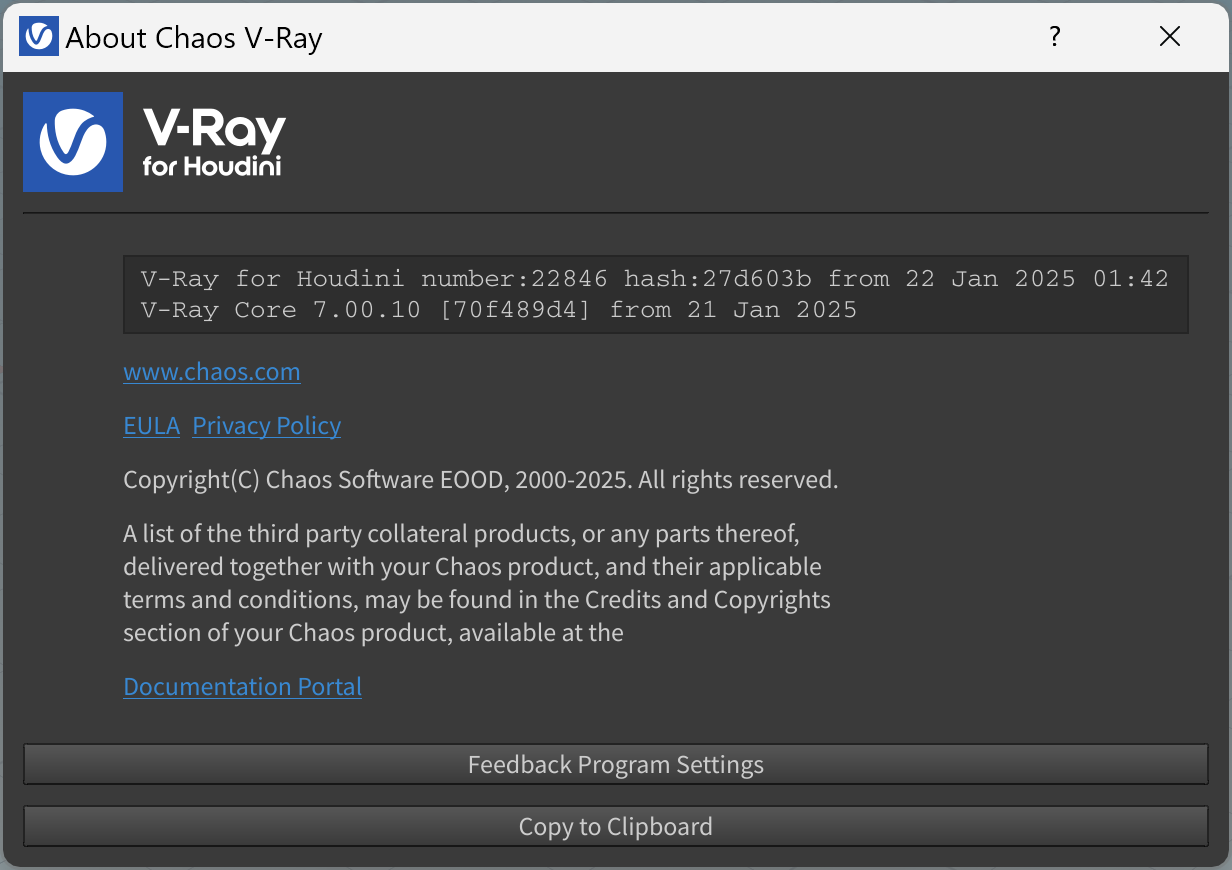

About V-Ray Window
The About V-Ray window is available when you click V-Ray menu > About V-Ray.
The windows shows information about the installed V-Ray version. It also provides links to the following:
- Chaos website
- End User License Agreement
- Chaos Global Privacy Policy
- Credits and Copyrights
- Chaos Feedback Program Settings
The Feedback Program Settings button opens the Chaos Telemetry window where you can enable/disable anonymized and personalized telemetry.
