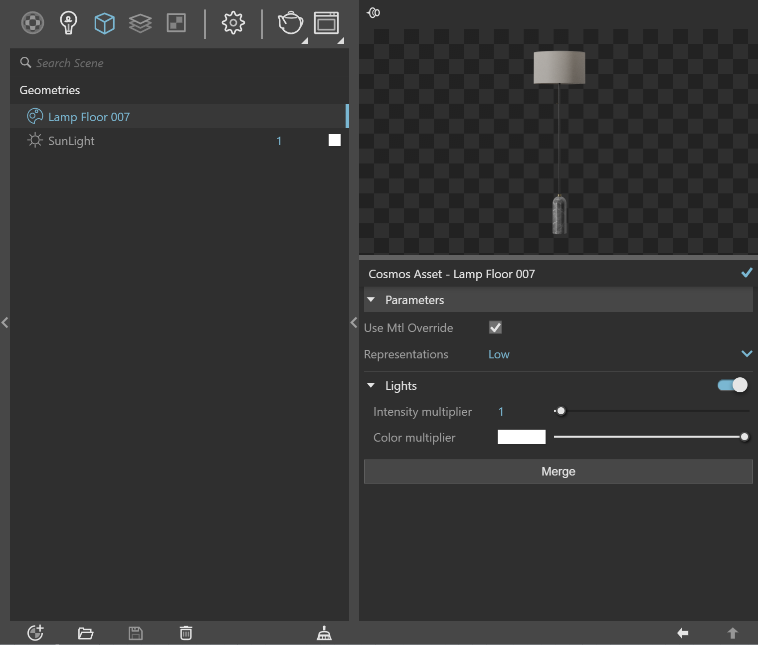

Downloaded Cosmos assets are listed in the Asset Editor under the Geometry section. They can be identified by the Cosmos icon. They can be renamed, deleted, used as replacements, moved, and merged.
The Use as replacement/Replace in scene option is possible only for other Cosmos Assets. It replaces all scene instances of the asset. The replaced asset is not deleted and is stored in the Asset Editor.
Use Mtl Override - When enabled, the global Material Override option in the Render Settings overrides the asset. When disabled, the asset in the referenced scene is not affected by the Material Override option in the Render Settings.
Representations - Offers different viewport preview representations of the Chaos Cosmos assets.
High - Displays the original mesh in the viewport. Using this option with heavy meshes and scenes might take longer before the mesh is displayed in the viewport and might slow down SketchUp significantly. The process is dependent on the poly-count and the representation is quite detailed.

Lights
The toggle enables the Cosmos Light asset.
Intensity Multiplier - Multiplies the intensity of all instances of the Cosmos asset.
Color Multiplier - Multiplies the color of all instances of the Cosmos asset. For more information regarding the color swatch, refer to the V-Ray Asset Editor page.
Cosmos assets with light sources are listed in the LightMix render channel.
Cosmos assets that rely on self-illumination through materials, do not have these controls exposed. However, the self-illumination of specific Cosmos assets can be adjusted after merging them by modifying the self-illumination layer parameters of some of their materials.
Merge - Converts the Chaos Cosmos asset to a standard proxy mesh with material assignments and populates the scene with materials and lights. That way, you can edit the asset's materials. The process is irreversible. For more information on proxy meshes, refer to the Proxy Mesh page.
Note that this automatically switches the asset to High LOD, and if you render with V-Ray Vision, the link to Cosmos is broken and the special LOD assignment used by Vision is no longer there. Lower level-of-detail (LOD) versions of the proxy mesh that are used by V-Ray Vision are lost.

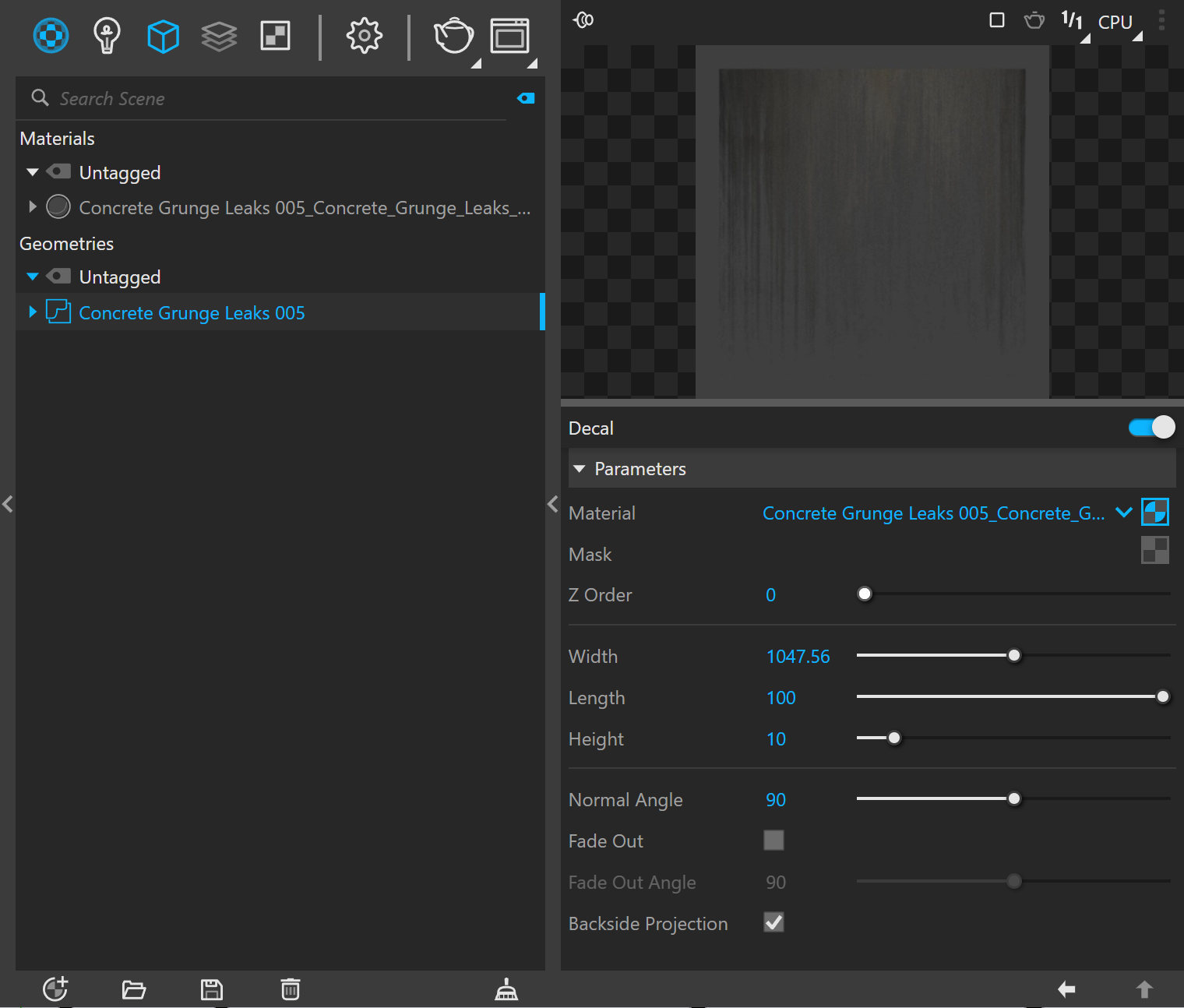

Starting with V-Ray 6, Cosmos decal assets are supported in SketchUp.
The Cosmos Decal material asset consists of a geometry Decal asset coupled with a material asset, which the decal projects. Opacity mask controlling which parts of the material is projected is found in most Cosmos Decal assets. Additional opacity texture can also be added in the Decal mask's slot to adjust the projection manually.
