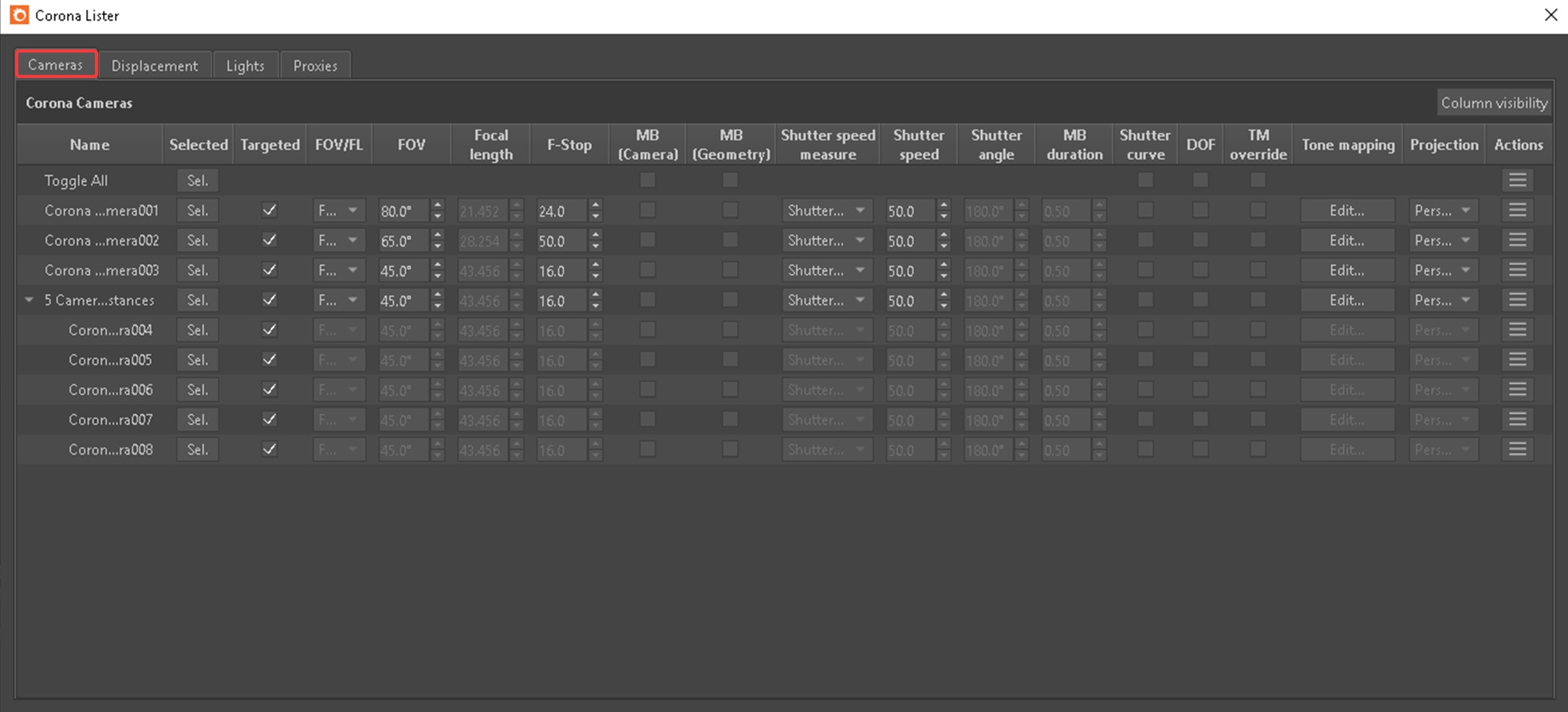

Cameras  Tab
Cameras Tab provides a list of all Corona Cameras available in the scene. Here, you can easily access and adjust various camera settings, including tone mapping and projection for each Corona Camera. The Instanced Corona Cameras are organized in a dropdown menu for easy selection. Any modifications made to a specific Corona Camera are automatically applied to all its instances.
Corona Lister showing a list of Corona Cameras

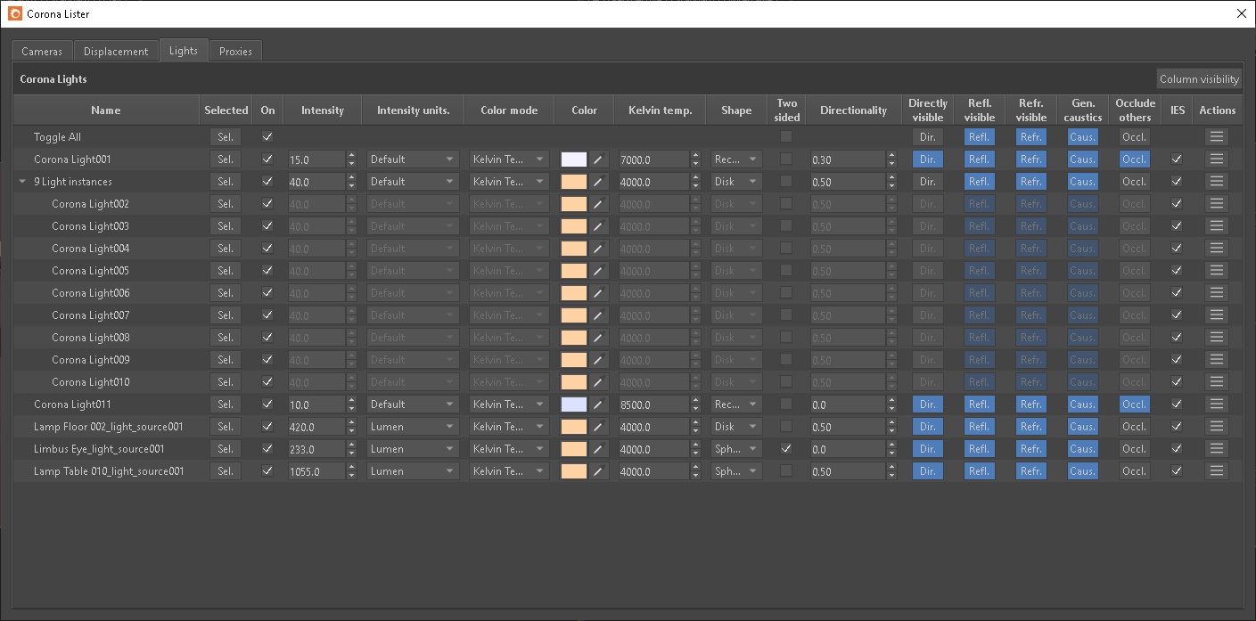

Lights Tab
The lights tab provides a list of all Corona Lights and Corona Light Materials present in the scene. The Instanced Corona Lights are easily organized and can be selected from a dropdown menu. Any modifications made to a specific Corona Light are automatically reflected across all its instances.
Corona Lister showing a list of Corona Lights

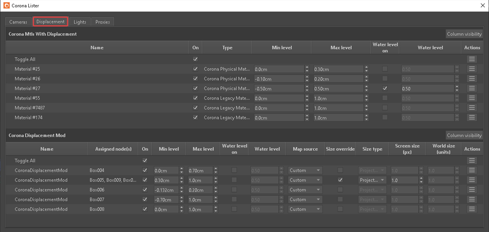

Displacement Tab
The displacement tab provides a list and the ability to access and modify all the Corona Displacement settings from Corona Physical Material, Corona Legacy Material, and Corona Displacement Modifier present in the scene.
The Instanced Corona Displacement modifiers are grouped. Any changes you make to a particular Corona Displacement modifier will be automatically applied to all its instances. You can select the assigned objects by right-clicking on a particular material or Corona Displacement modifier.
Corona Lister showing a list of Corona Displacements

In this example, we are using a simple interior scene with several Corona lights. The ceiling lights have been instanced and grouped together in the Corona Lister. To change and affect all the values of instanced lights, simply change the parameter of a single light.
The side rectangle lights and floor lamp lights are listed separately in the Corona Lister because they are unique and must be adjusted individually to achieve the desired lighting effect.
Also, there are multiple Corona Cameras in the scene which are listed in the Corona Lister. All settings can be quickly changed and managed from here.

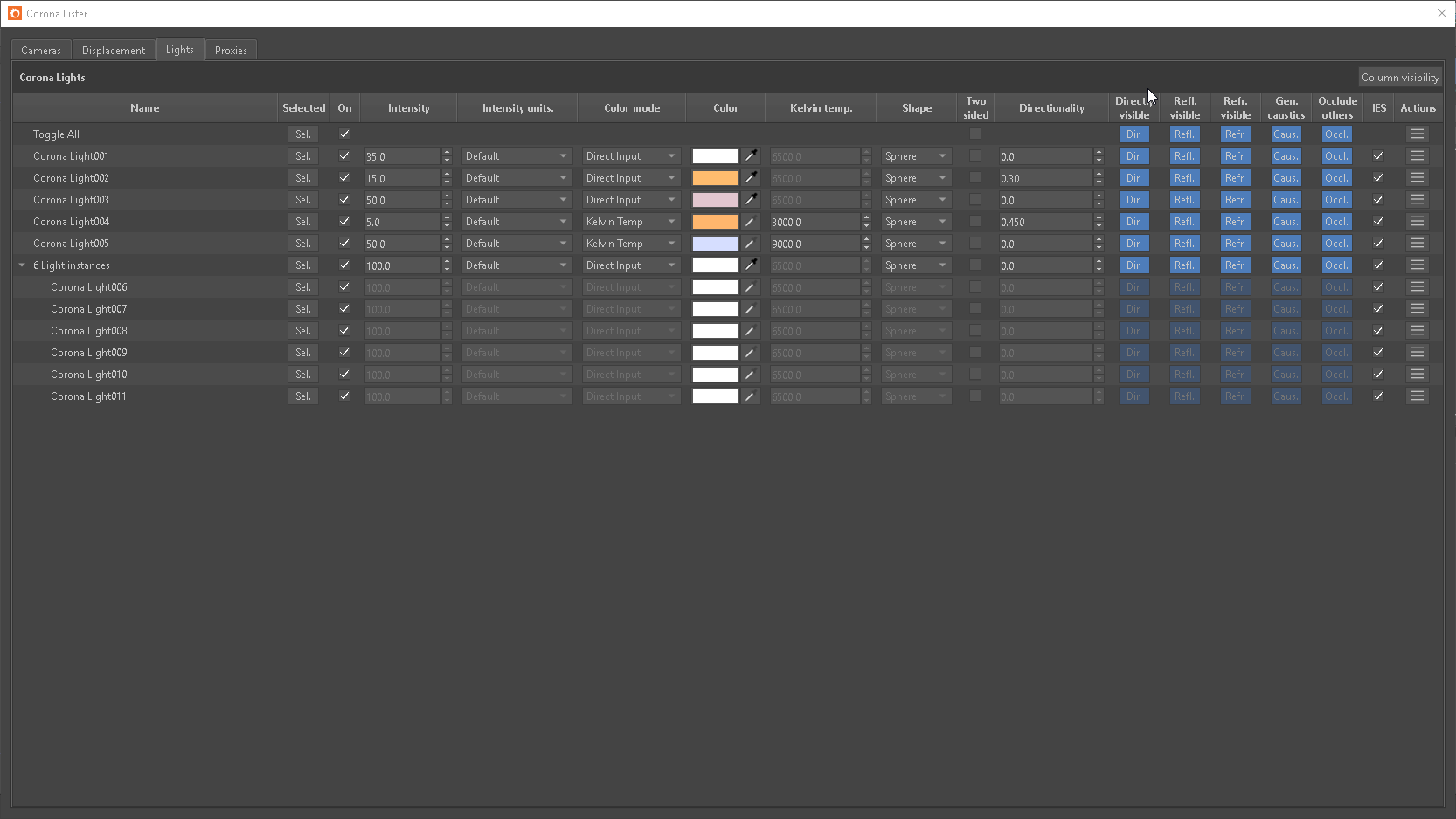

Corona Lister Lights Tab
In this example, we are using the Corona lister to manage multiple Corona lights in the scene.
