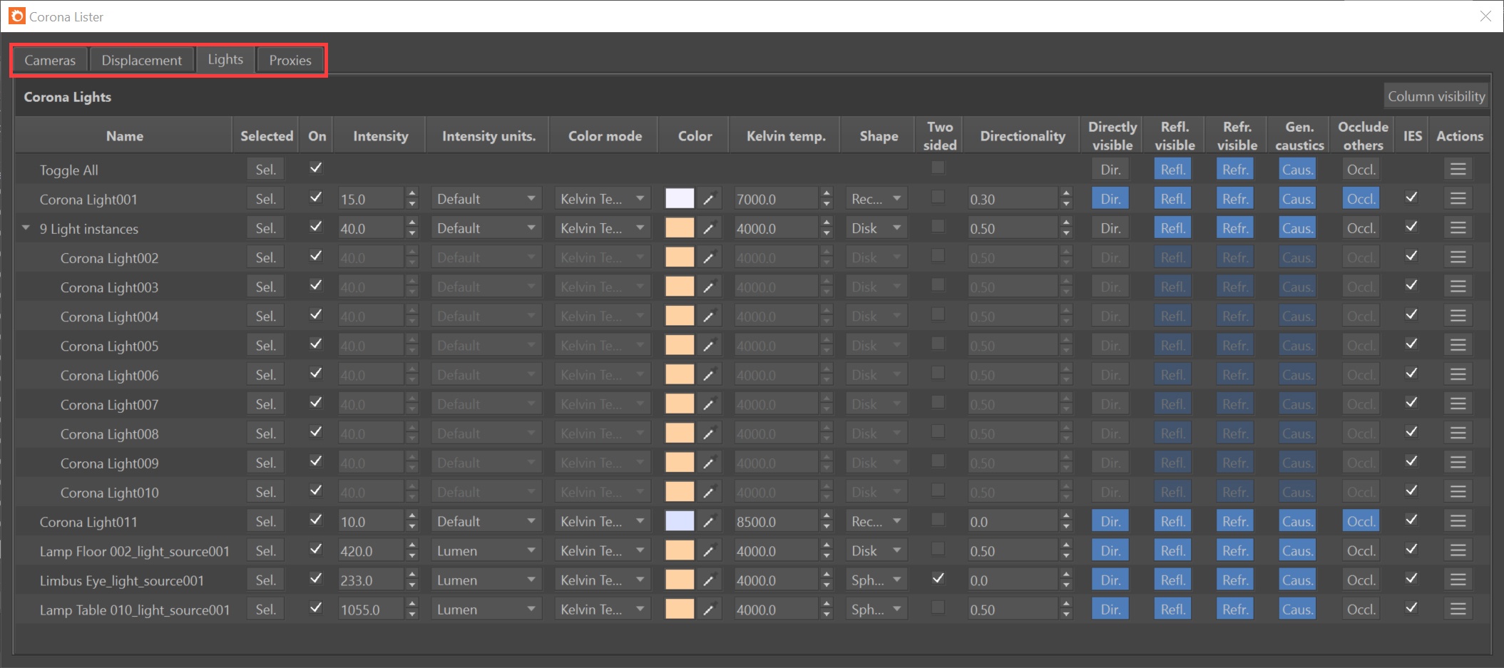

The Interface Tabs
 Corona Lister consists of four main tabs:  Cameras Displacement,  Lights, and Proxies.
Corona Lister Interface Tabs

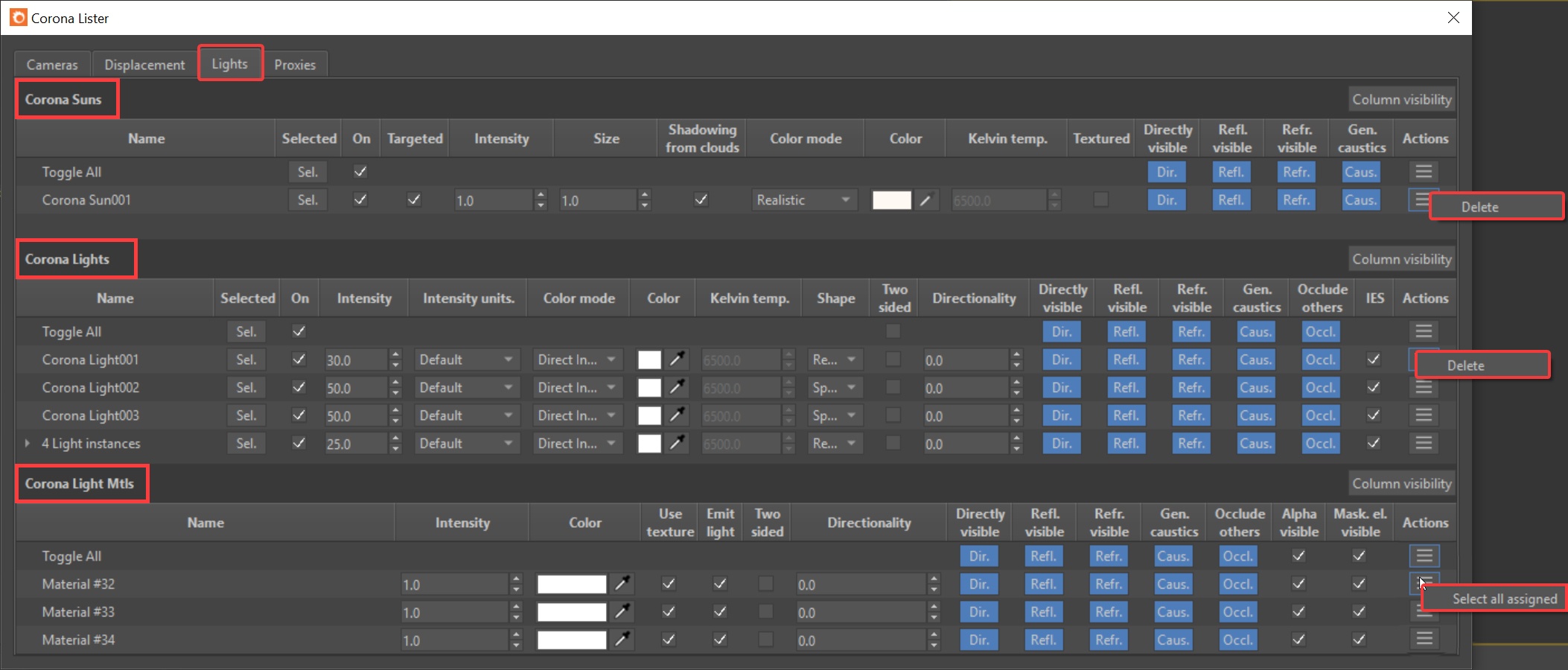

Lights Tab
The lights tab provides a list of all Corona Lights and Corona Light Materials present in the scene. The Instanced Corona Lights are easily organized and can be selected from a dropdown menu. Any modifications made to a specific Corona Light are automatically reflected across all its instances.
Corona Lister showing the 'Lights' tab
Actions available in this tab:
  • Delete: This removes the selected Corona Sun or Light.
  • Select all assigned (only for Corona Light Mtls): This selects all objects with the selected Corona Light material.
Corona Lister Lights Tab Actions Button options

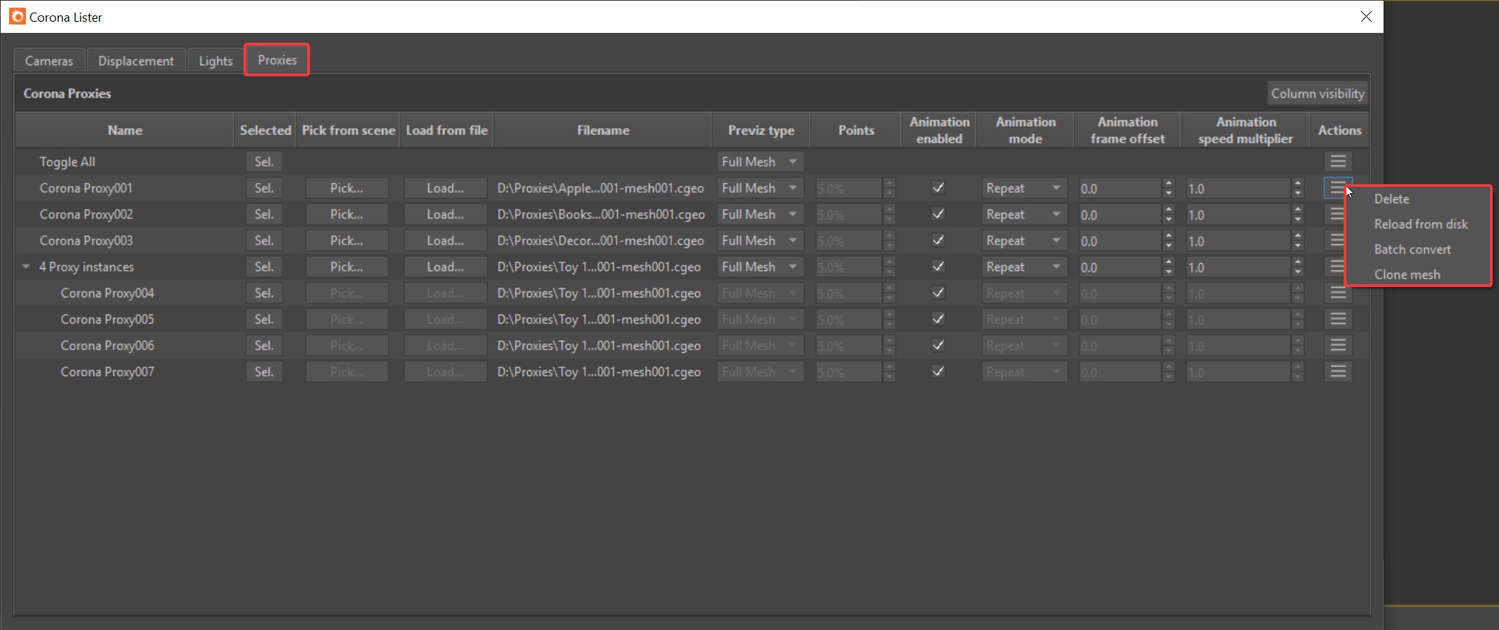

Proxies Tab
The proxies tab provides a list of all Corona Proxies available in the scene. From here, you can access and adjust the major settings for each Corona Proxy. The Instanced Corona Proxies are easily grouped and can be selected from a dropdown menu. Any modifications made to a specific Corona Proxy will be automatically applied to all instances of that proxy.
Corona Lister showing the 'Proxies' tab
  • Delete: This removes the selected Corona proxy.
  • Reload from disk: This updates the proxy from the proxy file in the scene.
  • Batch convert: Converts all proxies in a chosen directory and its subdirectories to the latest Corona format (.cgeo). Original proxy files are preserved.
  • Clone mesh: This will copy the mesh from the proxy file to a new object in the same location.
Corona Lister Proxy Tab Actions Button options

In this example, we are using a simple interior scene with several Corona lights. The ceiling lights have been instanced and grouped together in the Corona Lister. To change and affect all the values of instanced lights, simply change the parameter of a single light. The side rectangle lights and floor lamp lights are listed separately in the Corona Lister because they are unique and must be adjusted individually to achieve the desired lighting effect. Also, there are multiple Corona Cameras in the scene which are listed in the Corona Lister. All settings can be quickly changed and managed using the Corona Lister.
Scene Setup
A scene with multiple Corona Lights.
Corona Lister - Lights Tab
The Corona Lister can be used to manage multiple Corona Lights in the scene.
