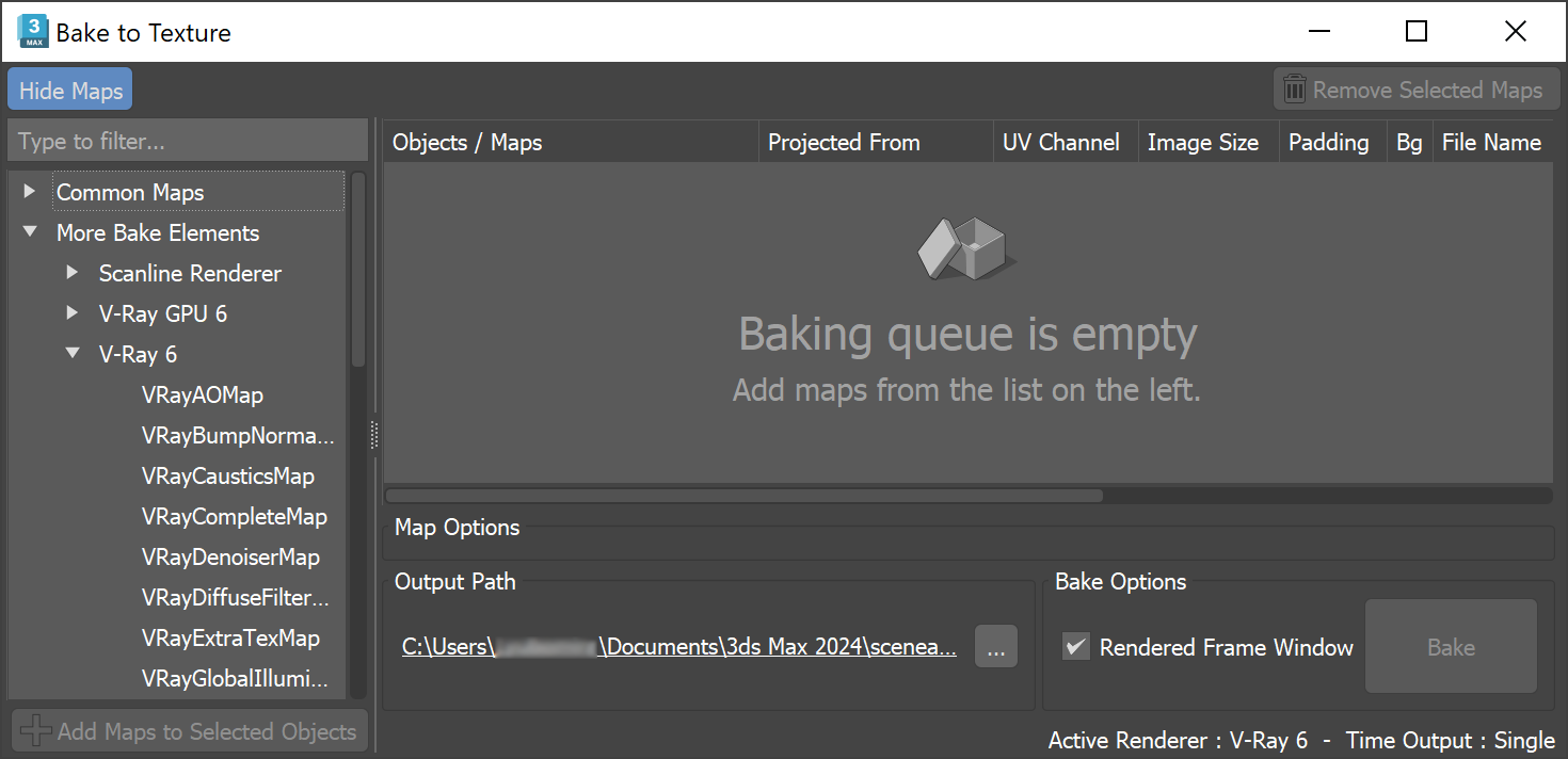

In 3ds Max 2021 and above, the newer Bake to Texture feature is also available and works with the V-Ray bake elements.
UI Path: Rendering menu >...
||Rendering menu|| > Bake to Texture > Select bake elements > Add Maps to Selected Objects button (for 3ds Max 2021 and newer)

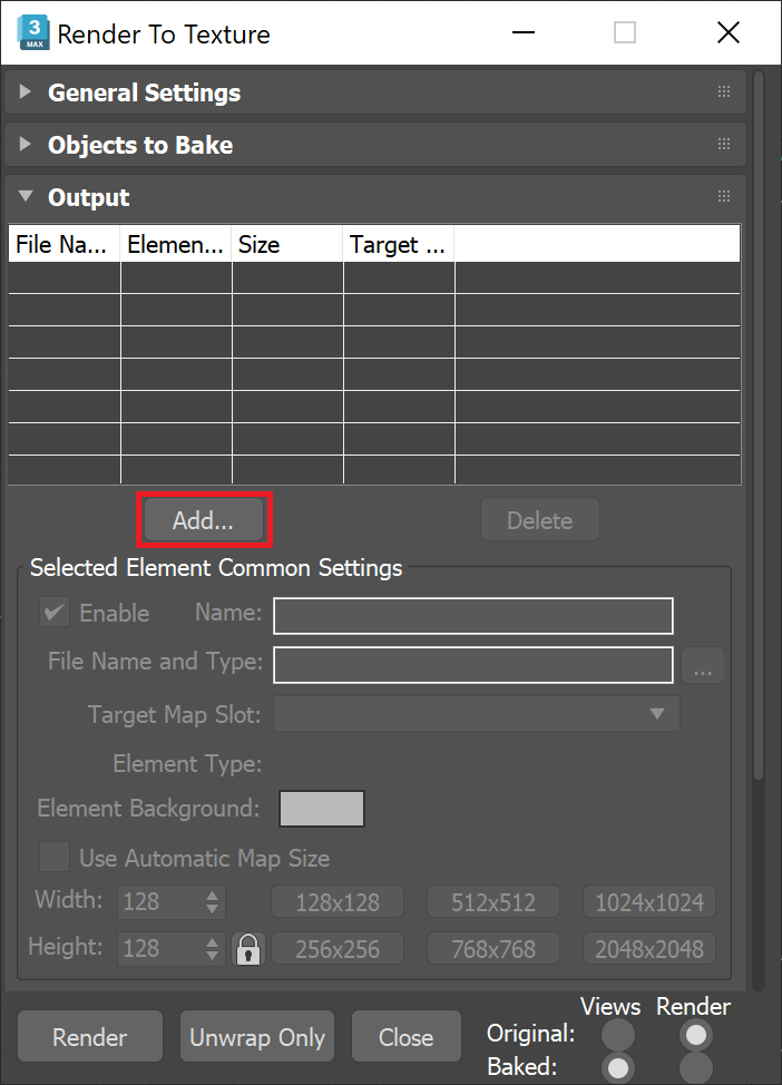

||Rendering menu|| > Render To Texture > Output rollout > Add button > Select bake element > Add Elements button (for older versions of 3ds Max)

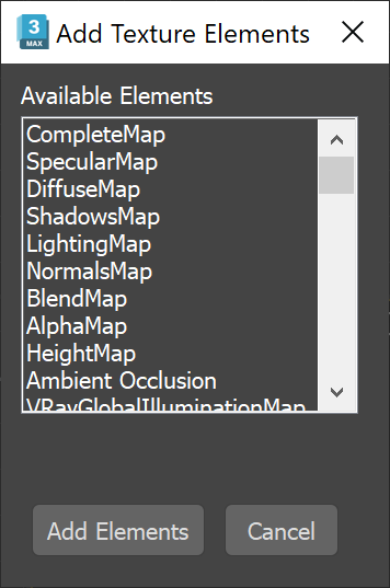

The following bake elements are available through the Add Texture Elements dialog. For information on the type of image or data included in each bake element, see the page for the corresponding Render Element.
Bake ElementCorresponding Render Element
