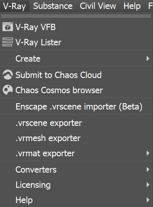

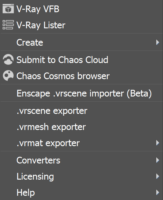

V-Ray includes a menu with easy shortcuts to some of the most commonly used V-Ray components. The menu can be accessed in the 3ds Max menu bar.
The menu consists of several different submenu's:
  • V-Ray VFB
  • V-Ray Lister
  • Create
  • Submit to Chaos Cloud
  • Chaos Cosmos browser
  • Enscape .vrscene importer
  • .vrscene exporter
  • .vrmesh exporter
  • .vrmat exporter
  • Converters
  • Licensing
  • Help
V-Ray Menu
MenuDescription
V-Ray VFBOpens the V-Ray Frame Buffer.
CreateOpens the Create submenu, where you can create geometry, lights, cameras, helpers, modifiers, and materials.
V-Ray ListerOpens the V-Ray Lister, where you can manage all lights and cameras in the scene.
Submit to Chaos CloudOpens the Submit to Chaos Cloud rendering window, where you can submit your job and render it in Chaos Cloud Rendering.
Chaos Cosmos browserOpens the Chaos Cosmos Browser, where you can find various assets ready for use.
Enscape .vrscene importerOpens the Enscape .vrscene importer, where you can import geometry, shading, lights, and cameras in your 3ds Max scene from .vrscene files exported by Enscape.
.vrscene exporterOpens the V-Ray Scene Exporter standalone tool.
.vrmesh exporterOpens the VRay mesh export window.
.vrmat exporterOpens the VRmat Exporter submenu.
ConvertersOpens the V-Ray Scene Converter submenu.
LicensingOpens the Licensing submenu.
HelpOpens the Help submenu.

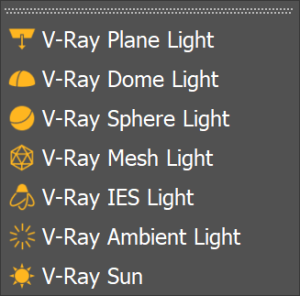

Lights
Opens a lights submenu where you can create:
V-Ray Plane Light
 V-Ray Dome Light
 V-Ray Sphere Light
V-Ray Mesh Light
 V-Ray IES Light
 V-Ray Ambient Light
 V-Ray Sun Light

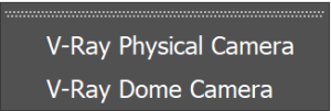

Cameras
Opens a cameras submenu where you can create:
V-Ray Physical Camera
V-Ray Dome Camera

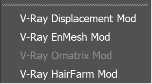

Modifiers
Opens a modifiers submenu where you can apply:
V-Ray Displacement Mod
V-Ray Enmesh Mod
V-Ray Ornatrix Mod
V-Ray HairFarm Mod

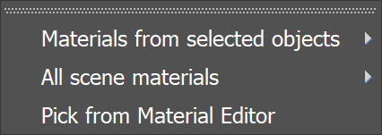

.vrmat exporter Submenu
MenuDescription
Material from selected objects
Exports materials from selected objects to:
to a single .vrmat file Opens a browser for saving a single file; name and location are required.
to separate .vrmat files Opens a browser for saving multiple files; folder selection is required. The separate files inherit the original material names from 3ds Max.
All scene materials
Exports all materials from the scene:
– to a single .vrmat file – Opens a browser for saving a single file; name and location are required.
– to separate .vrmat files – Opens a browser for saving multiple files; folder selection is required. The separate files inherit the original material names from 3ds Max.
Pick from Material Editor
Opens the Material Editor for picking a material and then opens a browser for saving a single file; name and location are required.

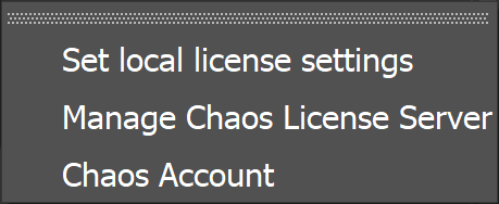

Licensing Submenu
MenuDescription
Set local license settingsOpens a window where you can change your Chaos License Server settings.
Manage Chaos License ServerOpens Chaos License Server.
Chaos AccountOpens the Chaos account management window.

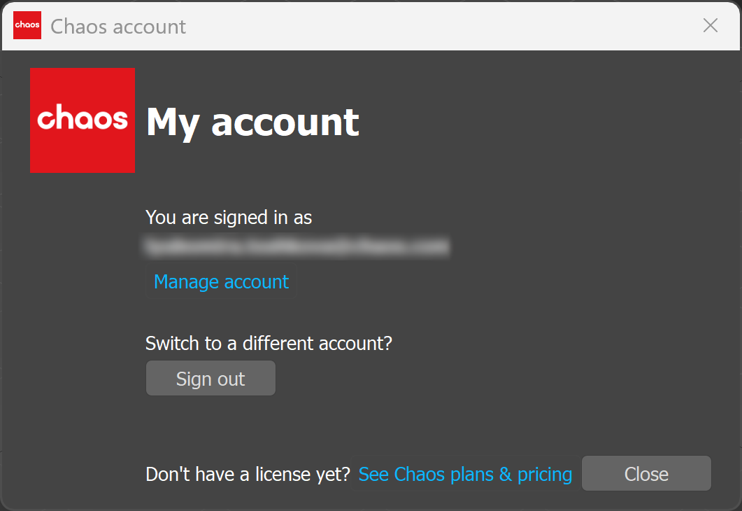

Chaos Account
This window shows you which account is currently used as a license holder.
Press the Manage account button to open My Chaos portal and manage the licenses. You can assign, remove, and allocate licenses to different users. For more information, see the My Chaos Portal Guide page.
To switch the current account, press the Sign Out button.

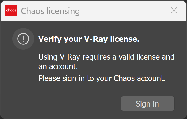

If you haven't signed in during the installation, you can do so in this window:
See Chaos plans & pricing link leads you to V-Ray's pricing list on Chaos website.
This window blocks all the rest of the UI, so make sure to close it once done to go back to 3ds Max.
