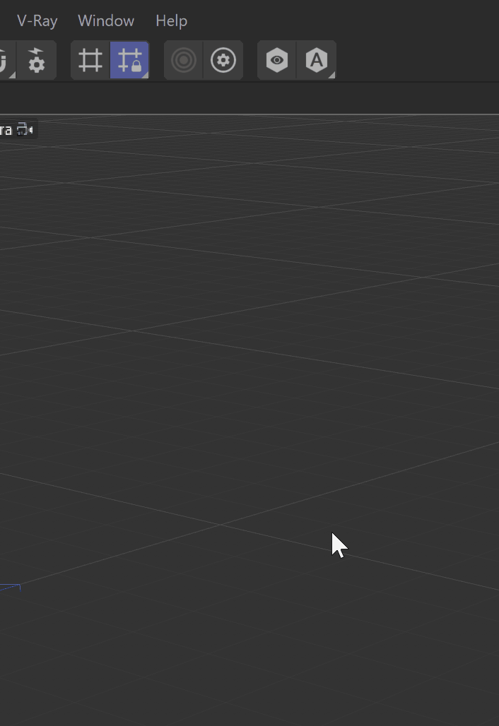

V-Ray provides a menu on its own in Cinema 4D's toolbar, where you can find some commonly used V-Ray components.
