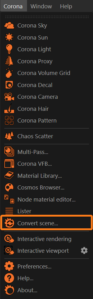

The Scene Converter tool is located in the Corona menu.
UI Path: ||Corona menu|| > Convert scene...

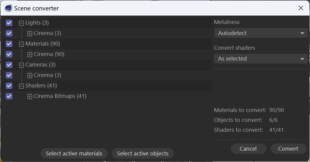

Options
List – All available and supported elements are listed here when automatically detected in the scene project.
Elements to be converted can be manually selected by enabling/disabling the corresponding checkboxes.
Select active materials – Using this button enables the checkboxes only for the listed materials available for conversion. The remaining elements available for conversion are disabled.
Select active objects – Using this button enables the checkboxes only for the listed objects available for conversion. The remaining elements available for conversion are disabled.
Metalness – This allows for choosing whether all the converted materials should be metals or non-metals or if the converter should decide automatically based on the material's reflectance parameters before conversion. Available modes are:
- Autodetect – Corona attempts to automatically detect whether a material should be converted to a metal or non-metal. This may not always be accurate, so some manual adjustments may be needed after the conversion.
- No metal – This mode sets the Metalness mode to Non-metal for all the converted materials.
- All metal – This conversion mode sets the Metalness mode to Metal for all the converted materials.
Convert shaders – This allows for selecting between different conversion methods to use for the shaders.
Cancel – Cancels the elements conversion.
Convert – Starts the conversion of the selected available supported elements.
The Scene Converter tool tries to keep as many of the original settings as possible in newly created materials. For Refractive, Translucent, and Volumetric materials, sometimes there will be more shaders/nodes than in the original material. Nevertheless, the converted materials will look and render just fine.
